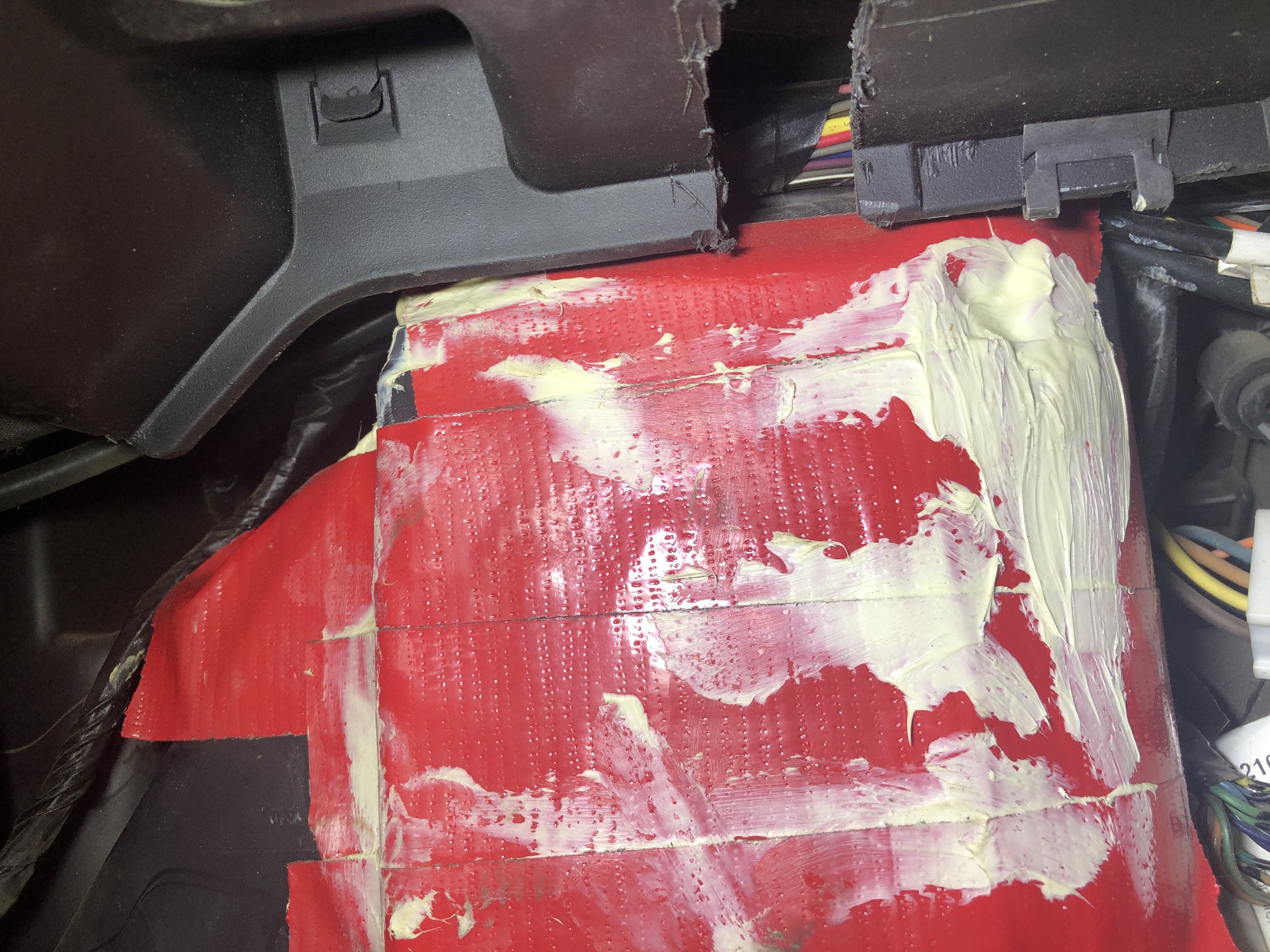

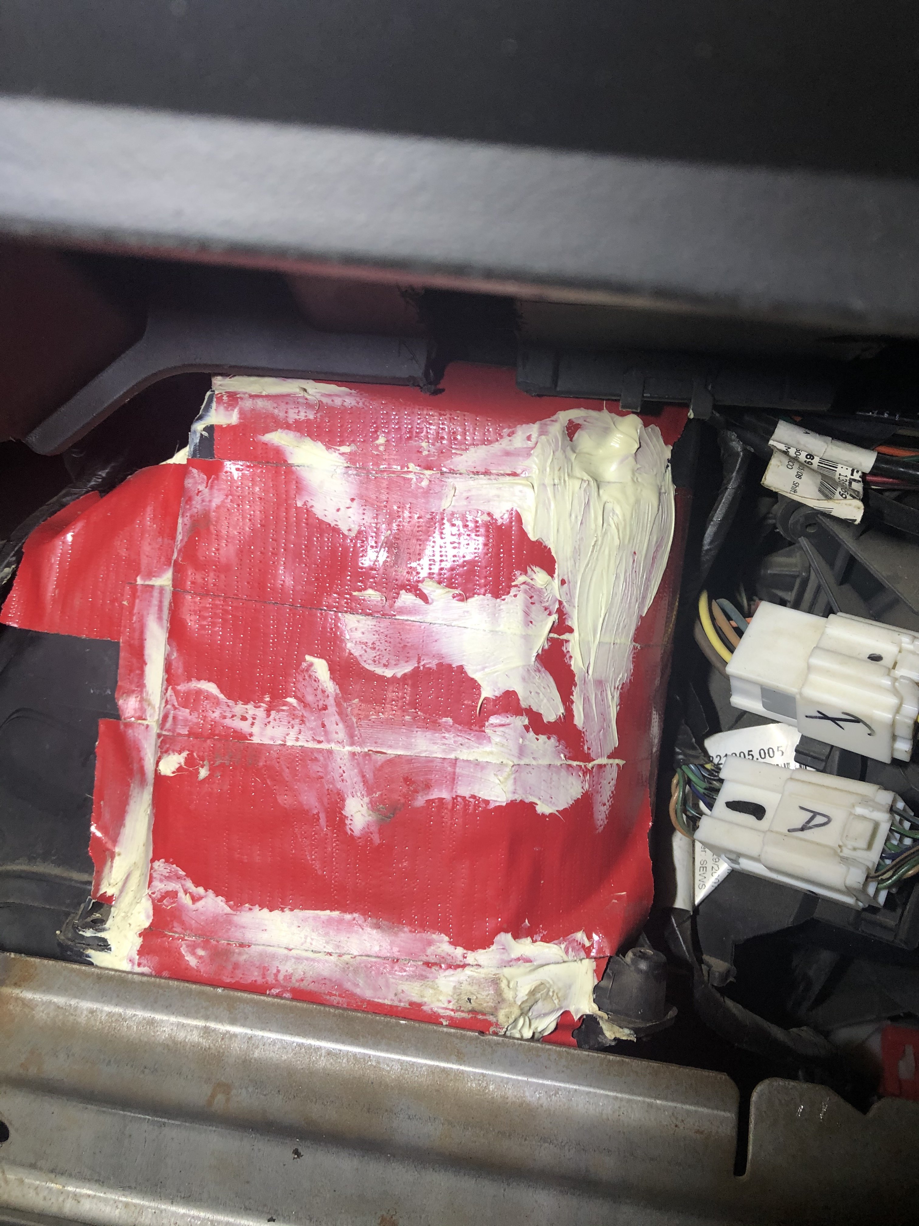

This is the a/c box botch job the previous owner instead of fixing it properly.
I would peel all that off to see what you're really working with, duct tape and whatever that smeared on there is probably isn't going to do spit. Seems very suspect, especially looking at that notch that has been hacked out at the top there. Someone has clearly been mucking about under there.

I agree it needs to come completely out for inspection and repair. I know there is a seal kit but unfortunately they are discontinued and no one has stock. I am not sure what plan B will consist of to fix the leak.
If you get the tape off at least you can see why they even put it on there in the first place. You can either get another one for a few hundred (I saw one on Ebay) or use something better suited for patching the plastic up than duct tape and whatever that goop is. Since it's not a pressure vessel it wouldn't be hard to use some black or red ATV sealant to fix up any cracks or leaks.
Once you get the tape off something else you could do is mix in some UV dye with water, clean and dry the housing first, and pour that in the same place you did before and then use a blacklight to see where exactly it is coming from. Should be able to get a UV detection kit from any auto parts store.

I ended up finding an OEM seal kit from Rock Auto. Now the dreaded dash removal. I looked on eBay and did not see a replacement box. When I remove mine I will remove all of that garbage duct tape and nonsense. If its cracked, what is the best plastic sealer I should use? Thanks.
Here is the one I saw: https://www.ebay.com/i/303127647067
As for a sealer, unless someone has a better suggestion and if it's only a crack or leak and not whole pieces broken off then black or red RTV sealant should work just fine. Black will blend in better obviously and be less noticeable.
I would peel the duct tape off before going to the trouble of taking the whole thing out. It might just be a minor crack right there that you can easily patch with RTV and not have to tear the whole thing apart. Start with the simple easy stuff and work your way up to the hard stuff.
