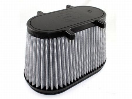

AFE Pro-Dry S for the H2, out flows that stock Donaldson type paper crap by almost 35%, is dry and washable synthetic, no oil. AFE#11-10088
The Airaid works just as well, but it has oil. I have used K&Ns on everything (Mom's car even has one) never had an issue because I know how to re-oil after cleaning. More is not always betterer. :giggle:
The plastic OEM resonator chambered intake does keep things quite for soccer moms, but it also robs power.
Savethereef,
Is this the one you went with?
What else do you have to replace to make it fit or is this a true upgraded replacement?
Cost?
I also have flowmaster exhaust but have done NOTHING else under the hood. I have been reading into more air. Please tell me more of what you think after you drive it a week.
