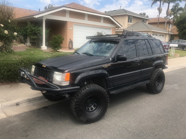

A friend is moving to Texas and needed to sell one of their vehicles so I helped them out and provided a new home for a 1995 Jeep Grand Cherokee. The Jeep has a 3 inch suspension lift and brand new 32 inch mud terrains.
It feels like suspension and steering needs some TLC, so I'll be reading up on what my options are. Initial thoughts are: Long arm kit, then lift it a bit more to accept 35's and maybe re-gear.
This will be what I'll wheel in Moab and anywhere else where the Power Wagon would stand too great a chance of being damaged or scratched
