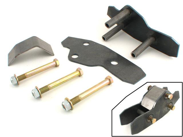

First...you'll need to beef-up your frame rail. I welded a full-length plate to the outside and a smaller one on the inside but, it still crushed a tad when I tightened the mounting bolts...so, I'm going to add some additional plating to the top and bottom so the entire frame is boxed with 1/4" steel. The H3 has a very flemsy frame and you should beef the snot out of the frame rails, especially if you're using a leaf-spring suspension. The rails are particularly wimpy toward the front (right where your forward leaf spring mounts would be)...
View attachment 5001 View attachment 5002
