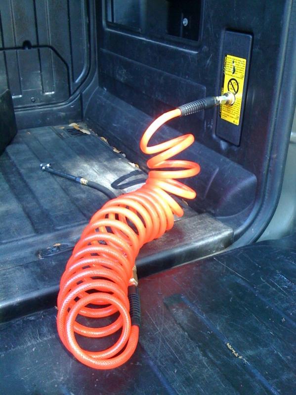

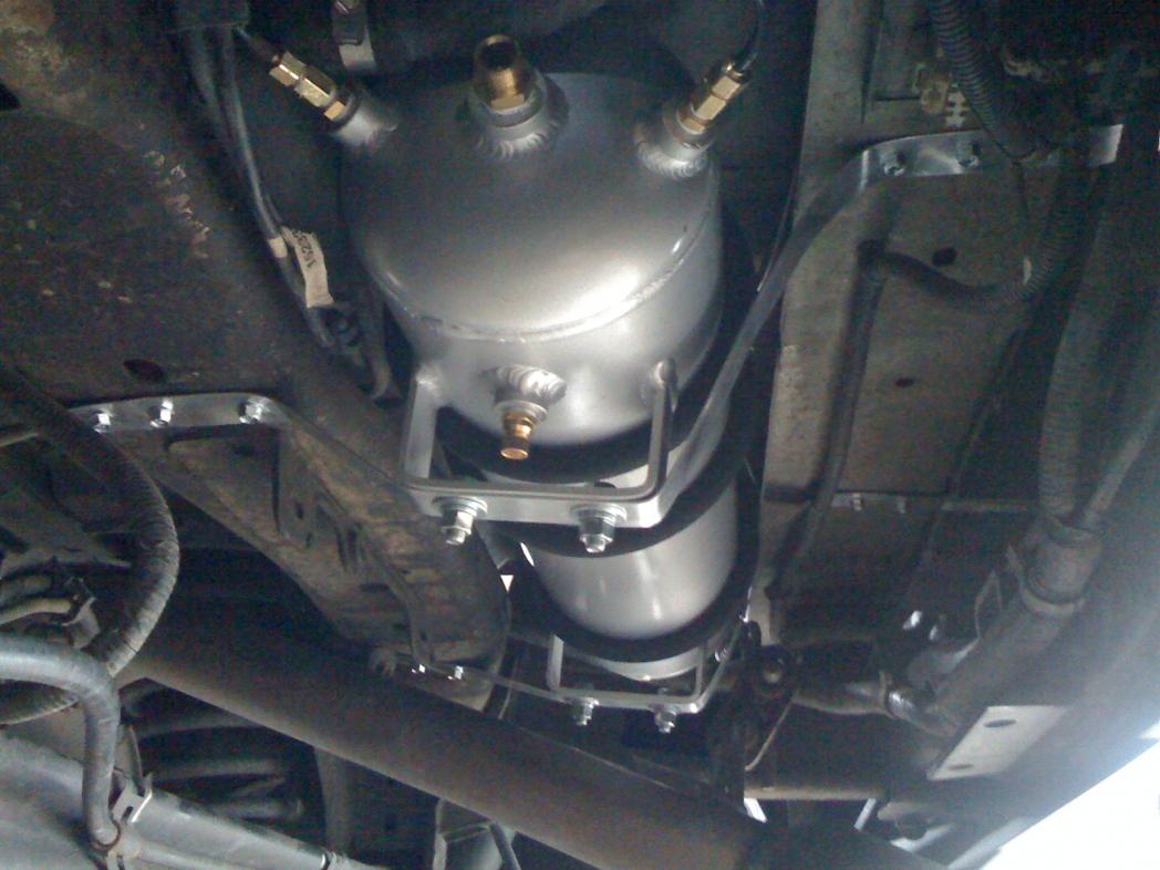

I mounted a 5 gallon aluminum air tank in the space where the factory compressor goes and located my compressor in the lockable SUT storage compartment in the bed.
Big2dabank
Central Florida
Box for the gauge and quick connect is a factory spot with power port in the rear of the sut. I mounted the tank this way so I could use the lowest port to bleed water out of the tank.
