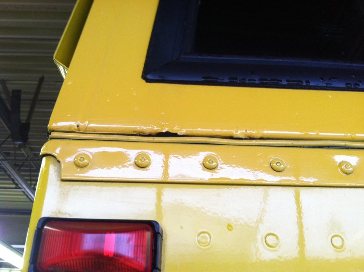

This is some of the crap I'm talking about.....
It's a bit worse on the inside of that spot and there is a some more of it on the side.

That's a common spot for rust to form, either due to a leak in the rubber gasket [you have two dissimilar metals next to each other there, the aluminum body tub and the steel roof and upper body]. It's really too bad that AM General didn't use an aluminum roof assembly on these trucks.
Spot fixing may work for the short term, I'd check the interior under the carpet/trim and see how bad it is on the inside.
Ideally you would take the upper interior out, unbolt the roof and pull that off, then cut out all the rusted steel and weld in new steel and finish to match, then sand/reprime the aluminum and buy new seals and button everything back together. That's a huge amount of labor to do though.
I had to do it on my soft op [rusted roll bars] I can't imagine how much work it is for a wagon.

Yeah... Thats what I was thinking. I looked around the forum and read a few posts about it. Not fun, but if you want it right....

I remember one cause is high pressure washer wands at self wash and truck stops especially. On the wagons you should keep from blasting the seal/gasket between the roof and wagon body, since the seal is painted over and is hard to the touch, some folks might miss that detail and wind up injecting water into the seal. That's one theory behind the rust.
