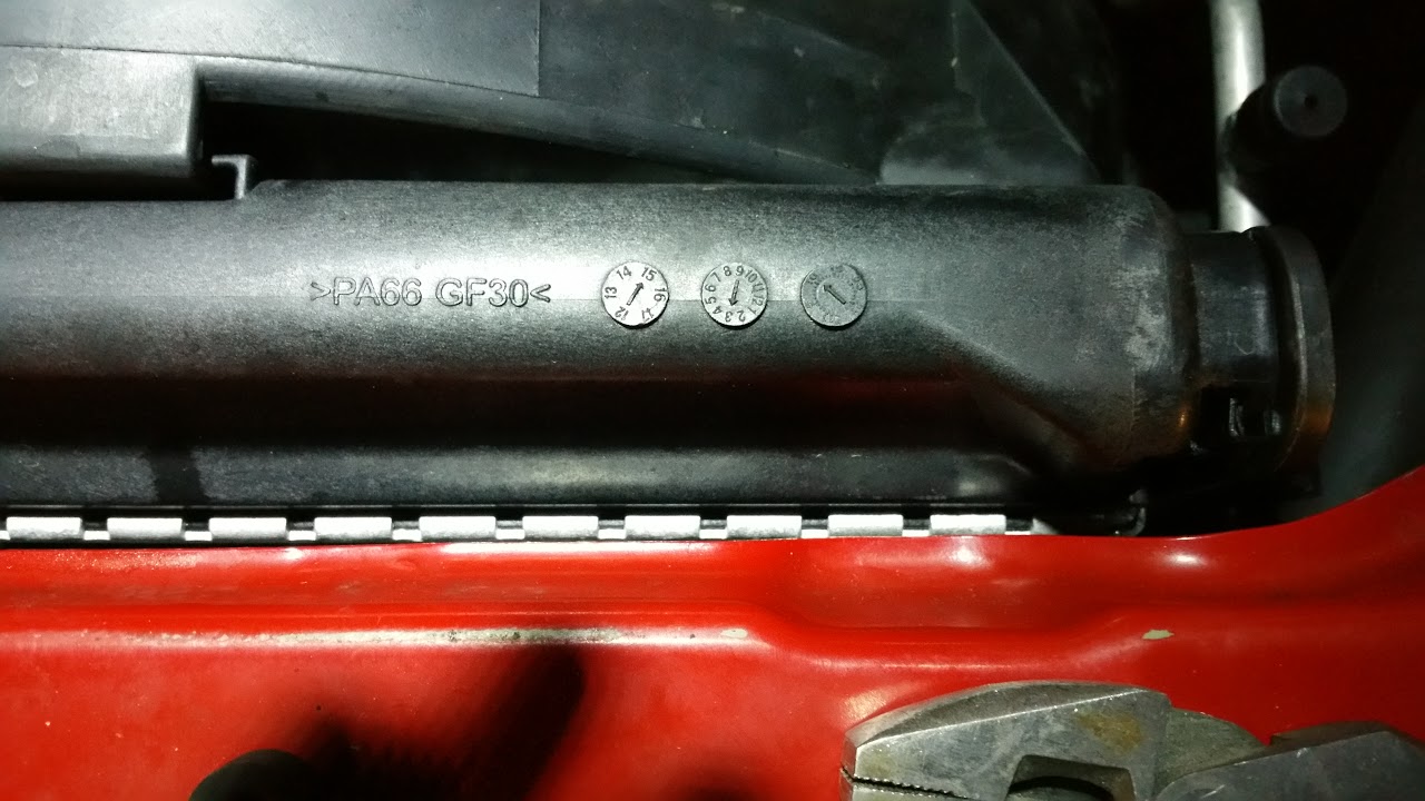

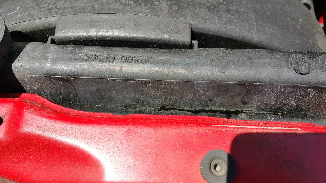

Well, after having to refill the coolant overflow tank after having this H3 for ony a few weeks and 400 miles, I learned that it's a common issue with the radiator cracking. Went back out to check and sure enough, I found the crack:
I'm going to go to the dealer after work today and try to get them to repair it for free, since I can tell this has been cracked since before I got it. Even if they won't do it out of the goodness of their hearts, I fortunately purchased the extended warranty which would cover it, though I do have a $100 deductible, but I'll try to get them to at least pay for that.
I've already had to eat some cost for getting the windshield replaced after noticing a crack in it the day after I took it home. They split the cost halfway since they think it happened after I took it, and I know that it didn't (though it may have been the rockchip was there on the edge of the windshield but it hadn't cracked yet, either way, it was pretty crappy). Frustrating thing now though is I get wind noise above 35 MPH which I am quite certain wasn't an issue before getting the windshield replaced. I've already taken it back to Techna Glass to have them try to re-seal it, but I still get wind noise. Next step is having them pull the windshield back off and putting it on again. It was originally one of the mobile installers that did it, and according to the guy at the shop, he's been getting people back in due to improper seals.

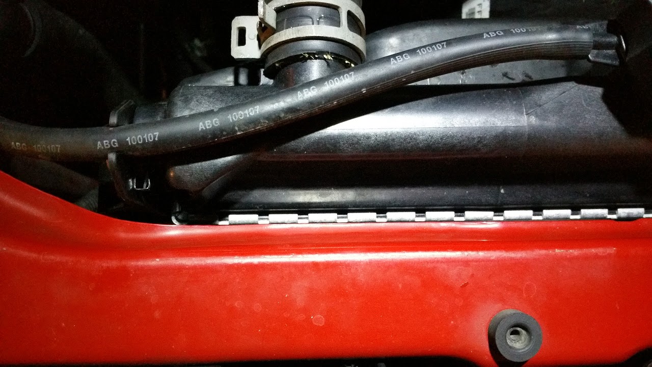

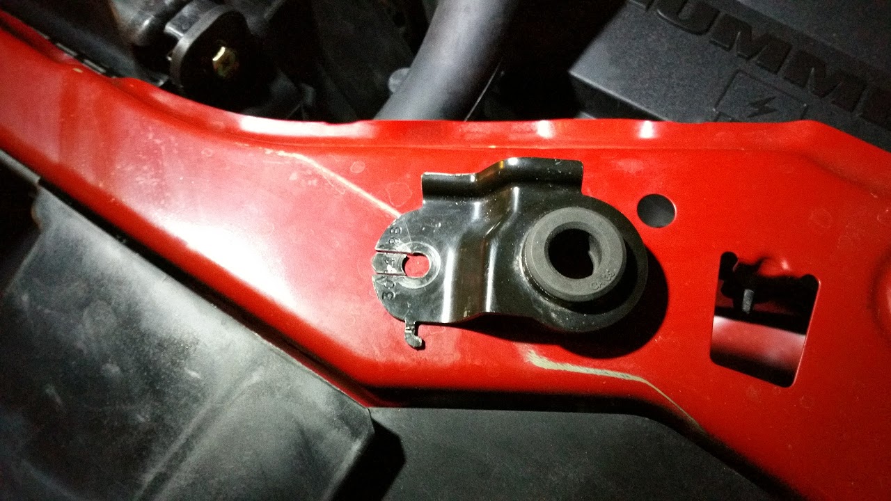

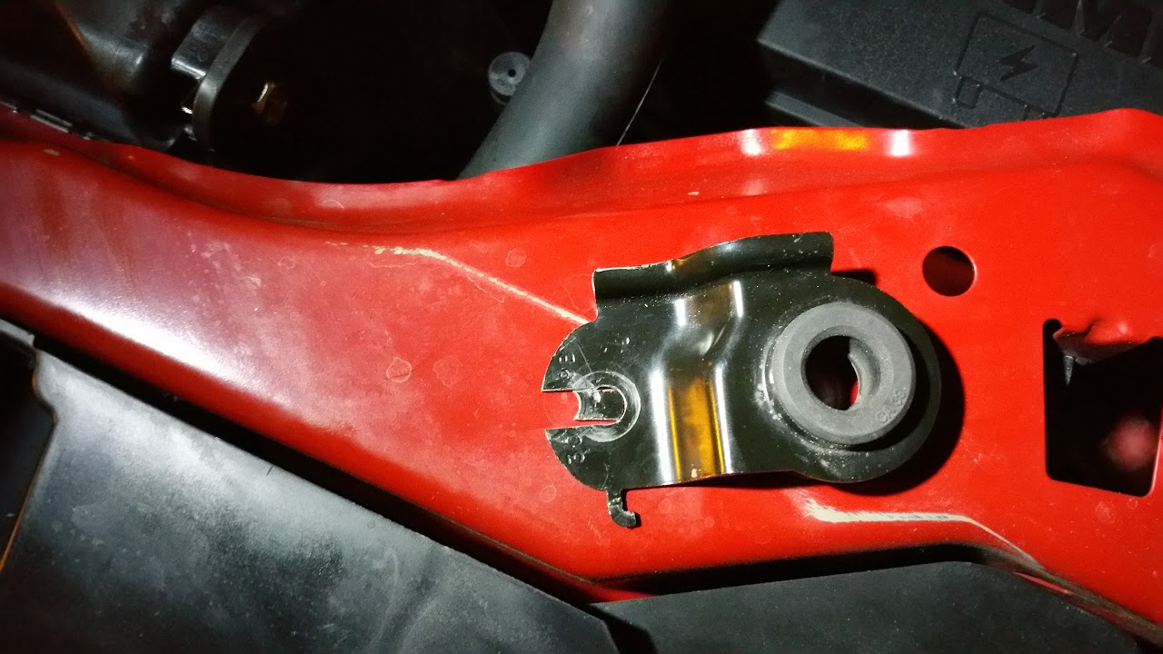

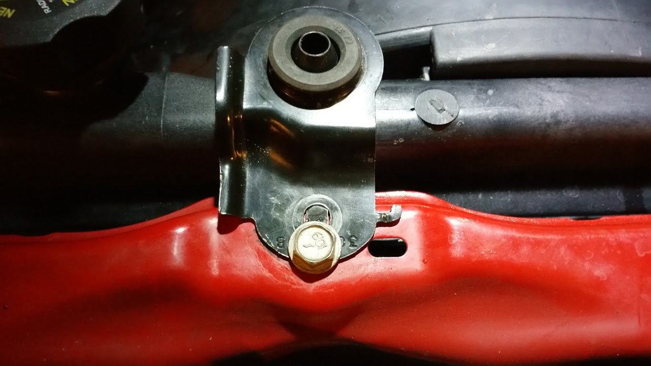

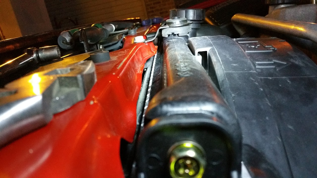

So I got the radiator replaced yesterday. Took a look at the work they did and noticed the radiator was right up against the top support. Stuffed a rag between the support and the radiator for the drive home, then dug into how exactly it mounted so that I could get it fixed and hopefully prevent any issues.
Fortunately it's a relatively easy fix, especially with a Dremel that has a cutoff wheel.
First I realized the top radiator hose is actually too long, it tries to push the radiator forward, and if you try pushing it back, it starts to kink the hose at the bends. That wasn't going to do, especially since it'd add stress to the radiator's top plastic housing, potentially leading to failure down the road. So I ended up trimming a quarter inch off the end and notching it at the two stop tabs. This effectively shortened the hose by a half inch, enough to eliminate any kinking when I pushed the radiator away from the top support.
Next was modifying the top bracket to hold the radiator away from the support. Using my Dremel with a cutoff wheel I notched the support and then filed the piece I cut out so that it'd help keep the bracket in place once bolted down. Otherwise if the bolt loosened up it could slide forward again and allow the radiator to rub against the support.
I've realized that the whole design is flawed, as there are several things wrong with it.
1 - The radiator is too close to the supports due to how the top bracket is designed.
2 - The radiator hose is too long and tries to push the radiator forward into the braces
3 - There is a portion of the brace on the drivers side that for some odd reason is formed so that it drops down lower than the rest of the brace, thus coming far too close to the radiator (there is no structural reason for it to be there that I can figure, as it doesn't exist on the other side of the brace, so it's not like it's part of the crumple zones or anything)
4 - The radiator seems to be too tall by about at least a half inch or so, based on how the top portion is designed. If it was 1/2 to 3/4 of an inch shorter (either the whole radiator or by shifting the side brackets up), it'd clear the top brace just fine.
Now as far as the cracking in the housing goes, I realized last night I should have asked for the old radiator, or at least that part of it. I would have liked to have cut it apart and checked it with calipers to see if there was possibly thinning of the plastic in that section. Given how many of them are cracking in the same exact spot, I'd imagine that is the root cause, rather than any inherent weakness in the plastic itself, as that would exhibit cracking in other locations as well. If it was that spot being too thin, then hopefully the replacement radiators made since have been corrected to ensure proper thickness of the plastic throughout. I have a feeling it is in fact a thickness issue, as the cracks looked like stress fractures to me. It's probably due to flexing repeatedly with each heating/cooling cycle that would have induced pressure outwards in that area as the system came up to temperature, followed by flexing back in when the system cooled and pressure dropped. Plastic will behave similar to metal, flex it too many times in the same spot and it will eventually fail and crack, especially the more rigid plastics like what is used for the radiator sides.
Here are some pics of my fix:
Here is the bracket after I cut to show you how I cut it:
Here it shows how the left over piece is placed to help hold the bracket in place:
Modified bracket mounted:
Pics of the new gap, it's about at least a quarter inch away from the brace now, you can see that spot that dips down for some idiotic reason, as if they are trying to destroy the radiator:
Other end (note lack of that extra forming):
Shot down the length of it:

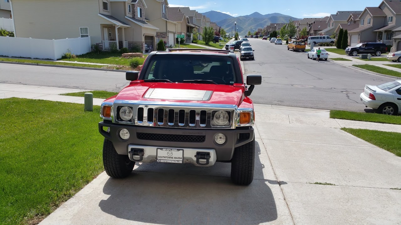

Picked up a Thor Parts front bumper today! Just happened to fine one for sale locally at a killer price from PCH2! Hopefully I can get it installed this week.
I was able to get the bumper installed today. I actually started on it last night since I wanted to undercoat the exposed portions of the body, partly to help everything blend in and look nice, and partly to help protect it.
Here it is before the install:
Only issue with it was one of the studs for the grille was snapped off. Not a big deal though as I just ground it down and popped out the rest of it, which left a nice hole to put a bolt in. I realized the grille must be made from stainless steel, which makes me super happy since I don't have to worry about it rusting, and I used stainless hardware for the replacement bolt. I also ended up having to get a couple bolts for the skid plate. I got a killer deal on this bumper though, so I am not complaining :)
This is where I got to last night (used a pic from this morning so that you can actually see anything):
And here it is after I finished the installation and trimmed the splash shield:
The grille is a bit lower than I'd like it, I tried to space it about 3/8" above the bumper, but after marking and drilling, it ended up only about 3/16" above it. No biggie though, I think I might do a 1" body lift eventually, and the spacing from the light pods to the chrome grille is nice, so I'll take it. I undercoated all the exposed/visible body sheet metal to protect and blend it, and I also sprayed undercoating on ends of the bumper that face the wheels to help protect it from rocks and to blend in the mounting bolts back there. I also sprayed the backs of the light pods for additional protection as well. It took me about 3 hours last night to get to the point of the first pic, and then to finish it all off I think it took another 3 hours or so.
All in all it turned out really nice and makes the H3 look a lot nicer. Now I just need to get a winch for it to complete the front end.

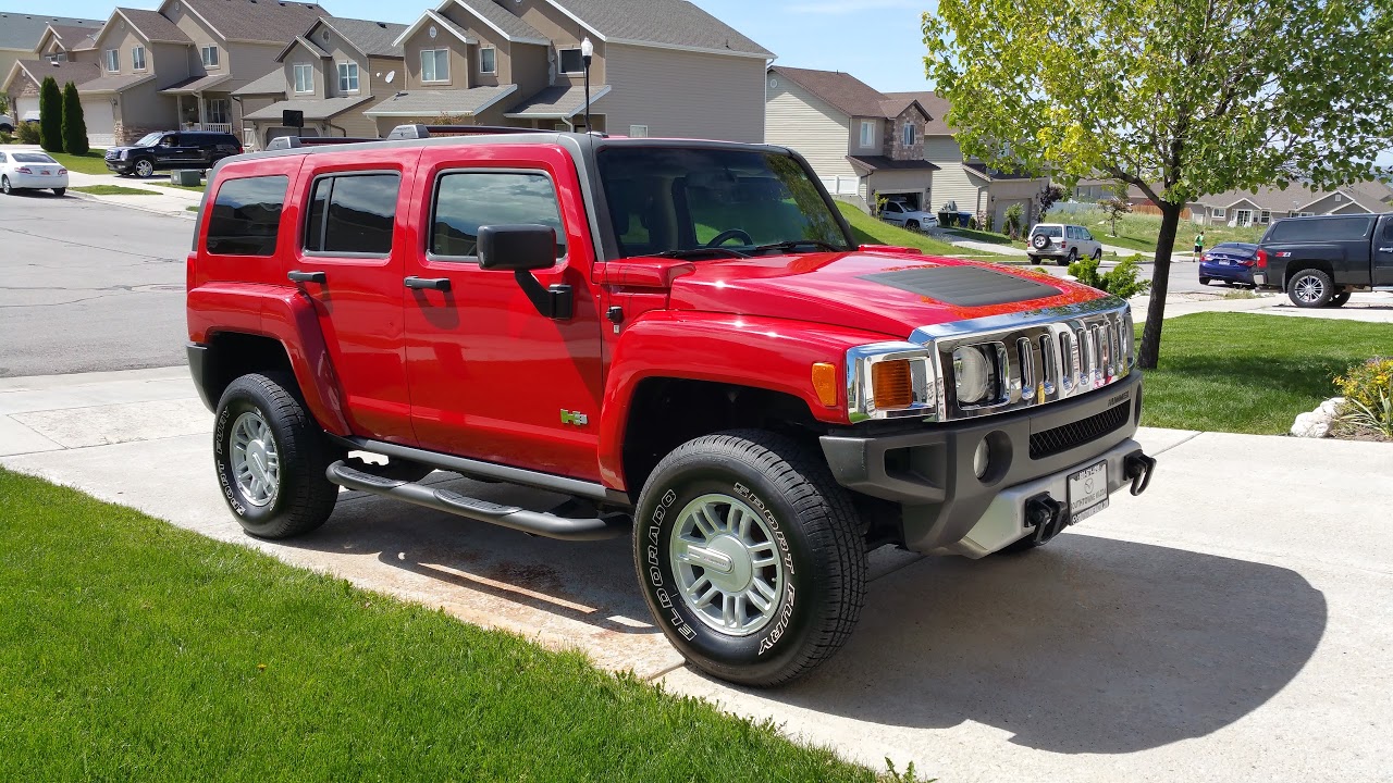

Picked up some OEM rock sliders last night for a good price. I will be getting these on either tonight or tomorrow morning.
There is some damage from a hit to a rock on one of them, but it's pretty minor. Plus, that is what these are for, not just to look pretty. :)
I was able to get the rock rails on yesterday. I paid $150 for them, which is far cheaper than anything I could have built. As for installing them, all I can say is thank heavens for having an air ratchet. The clearance for getting a ratchet on most of those would have limited the swing of the ratchet. It would've taken me far longer to install them by hand, especially considering I had to chase three of the bolt holes on each side since they were exposed to the elements. By the way, for anyone that doesn't know, an old bolt with notches cut along it like a thread tap makes a great, cheap thread chaser. I couldn't find my M10 metric tap, so I grabbed a bolt from my box of Dodge Neon parts and cut grooves in it with my Dremel. Some cutting fluid and the air ratchet and it worked great.
