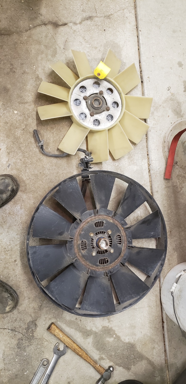

Alpha fan and clutch came in. Similar diameter as the stock i5 fan. Also shown is the trailblazer fan. Ideally I am going to use the alpha clutch which mounts the fan close to the engine and the larger diameter trailblazer fan.

Good heck, that is a huge hole. Water had to have been getting in there for quite a while to do that.

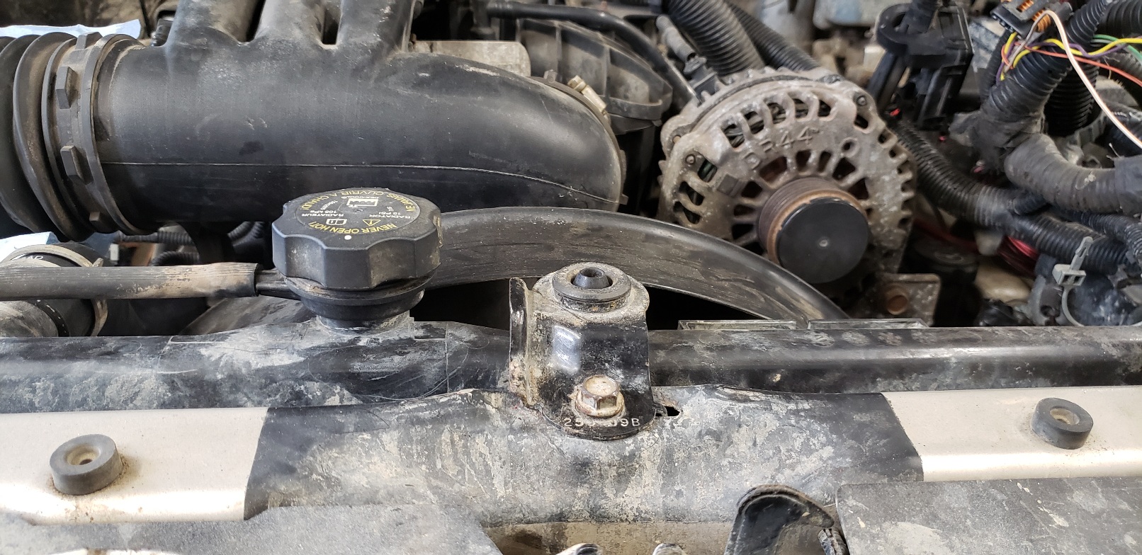

As for the trailblazer fan, that is interesting. does it fit in the opening of the Alpha fan shroud? Seems like it'd pull a lot more air with the attached cowling or whatever it's called on the fan blade tips. I know that doing that increases the efficiency of a fan by a fair bit as it stops air from being able to slip over the tips of the blades. If you can get me a measurement of the diameter of that I want to check some clearances. You might end up running into an issue with the air intake, it's a pretty tight clearance stock.
Looking at those pictures of the fans I never realized how much smaller the V8 fan looks compared to the I5 fan. Wonder if they only did that for clearance issues. Get me the diameter of the stock Alpha fan and the Trailblazer fan and I will verify clearances.
The intake tubing comes in the way on the alpha. I found out the hard way when trying to put a mechanical fan on a car intake for my LS, no way its happening (car intake sits a few inches down)

I don't have an oem alpha fan shroud to verify but I doubt the trailblazer fan would fit in it even on the alpha clutch. It seems to still clear the tbss induction tube and radiator cap but just barely. If I have to move the engine forward a little it might not work. I also haven't verified if the trans cooler lines will clear on the bottom. Lower radiator hose is close.
