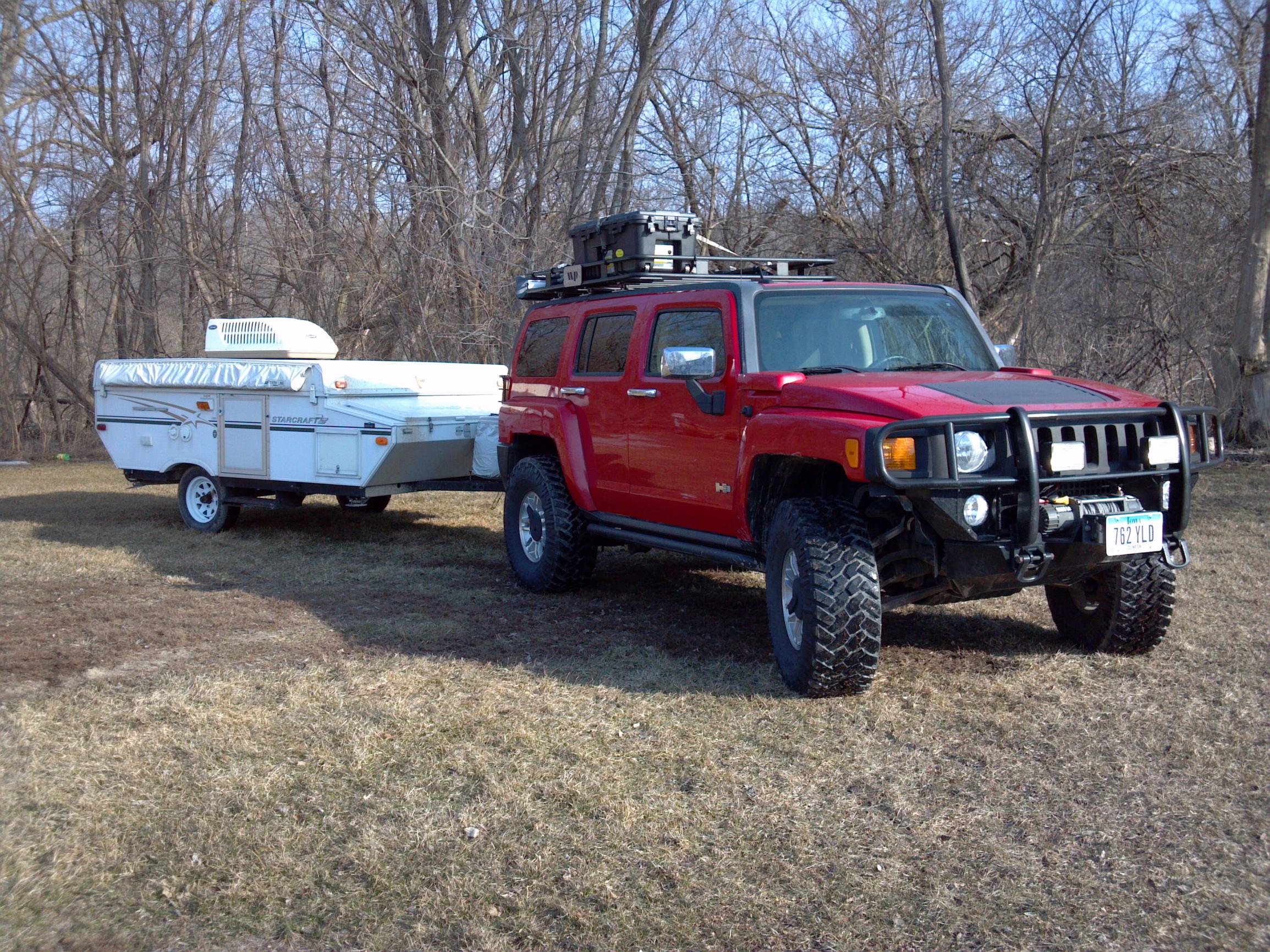

I won't have any pictures of this next upgrade. But a few weeks ago I drove across a scale and the H3 came in at 5880 lbs. I hooked up to a small pop up camper the other day and the rear sagged a couple more inches. So I think it is time to add another leaf spring and increase rear payload. After seeing Bebe and speed's repair on for SOA and adding a Chevy leaf spring. Which runs the full length of the main leaf. I called a local spring shop. They quoted $380 to make a custom arched second spring with installation and all necessary parts. So this is with new u-bolts and the center pin in the leaf springs. I'm dropping it of in a few minutes. Hopefully I gain some rear height. From what I can gather the rear on a stock h3 measures 24" from the center of the axle to the bottom of the fender. Mine currently is at 23".

Well I was surprised when I picked it up. They charged me less then they quoted it was $320. It was about 24.5" from the center of the axle to the bottom of the finder, with my tools and spare parts in the back. I put the spare parts and tools on the roof, loaded the back with the cooler, food, bags, ect, then hooked up to the trailer. It measured 23" with the tongue weight of the trailer on it. So I'm glad I had this done before the trip.
