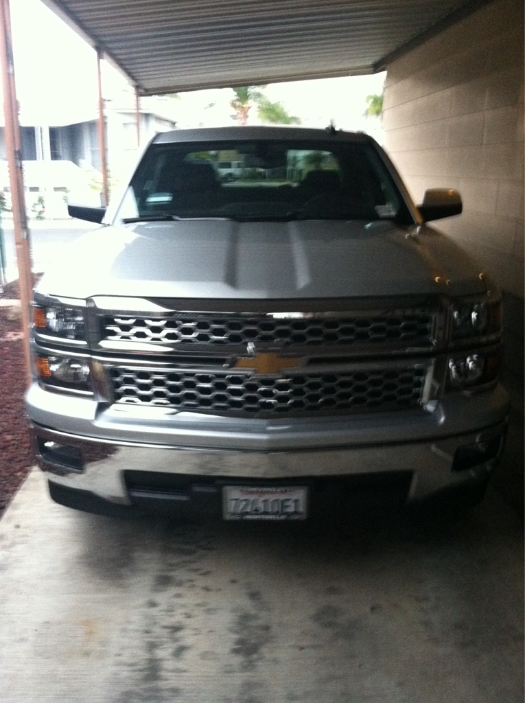

Dang was it that serious, did you ever find out what was the matter with it? Congrats on the new truck though, looks nice
Traded it for a loaner until it's fixed.
Let me know what fixes it-----
You guys are WAAAYYYYYY to easy to roll over on Zach.
Pretty nice loaner though. Really like the new Silverado though. Engine got dropped off late yesterday at work. Tech was going to try and pull the wounded engine today
