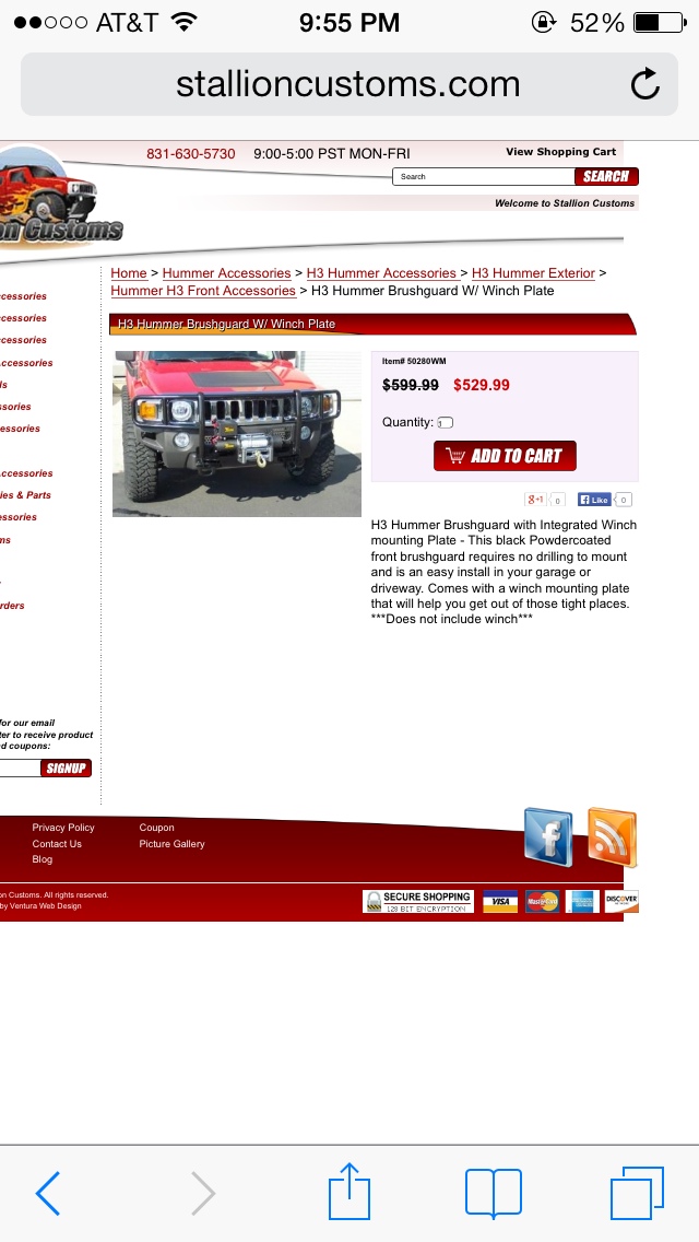

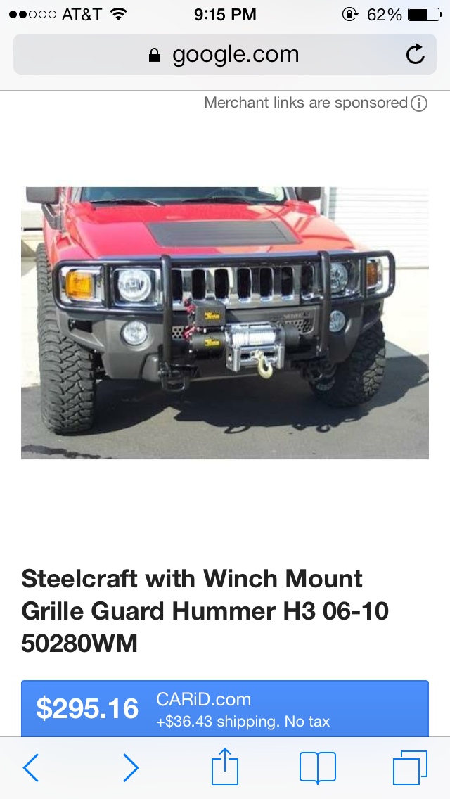

And you could go with this better price than from teaka toys ImageUploadedByTapatalk1410825797.954043.jpg actually carid is cheaper ImageUploadedByTapatalk1410825829.652278.jpg

Do you know of anybody that runs one of these? Is the winch plate a separate piece than the brush guard, or is the welded together as one piece?
I have one, but don't have the winch mounted yet. They are welded together. It's a good combo.
