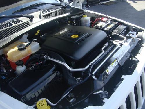

If yours has the Mercedes engine, you're good to go. If it has the VM engine you're in for a very rude awakening. Two things to see if it's a MB or VM engine. Check on the casting of the exhaust header. If you see a VM in there you know what you got. You can also tell from the auto tranny. If the shifter is the typical US straight up and down style, it's a VM. If it's a step style like all MB cars, then that's what you have. If you do have a VM engine, keep the revs below 3500 if you don't want to spend a pretty penny repairing the engine. The VM engines are made in Italy and are very unreliable. Very poor quality. Sorry to break the bad news.

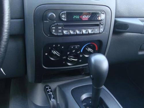

Thanks for everyone input. I always thought these were a little turd car, so I knew I would get soe crap. LOL. But until I drove this CRD I had no idea this things were as torque as they are and compared to everything else I have looked at in the used market close to $15k, I haven't found any other options out there that are american made, have the ability to get mid to high 20's mpg. I need AWD with some traction control or 4X4 because I am on construction sites and undeveloped land all the time and without 4x4, sugar sand is a biotch to get out of.
I'll have to check, but I am almost positive it does not have the MB CRD. I know the shifter is straight up and down.
