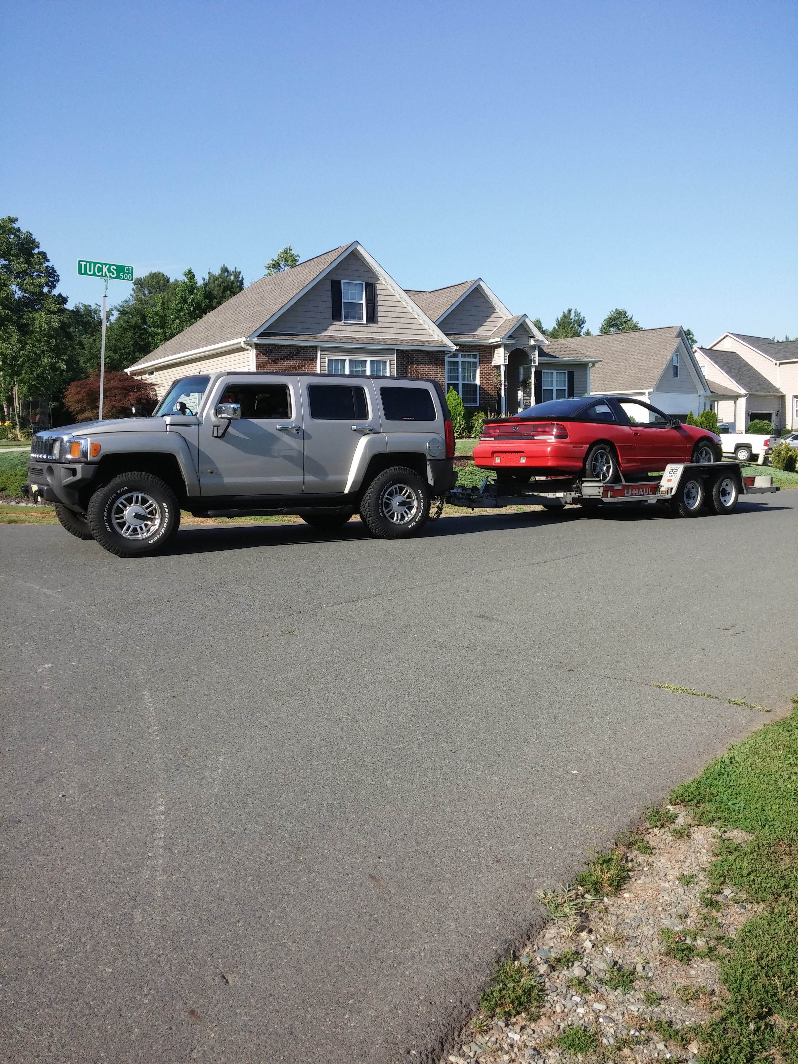

I've towed 4,000 lbs to 5,000 lbs several times. Even been on Interstate 40 doing 75 mph with that much weight. The picture below is from several years ago when my 2006 was bone stock. Towed the Talon just fine doing 65 mph on the Hwy.
