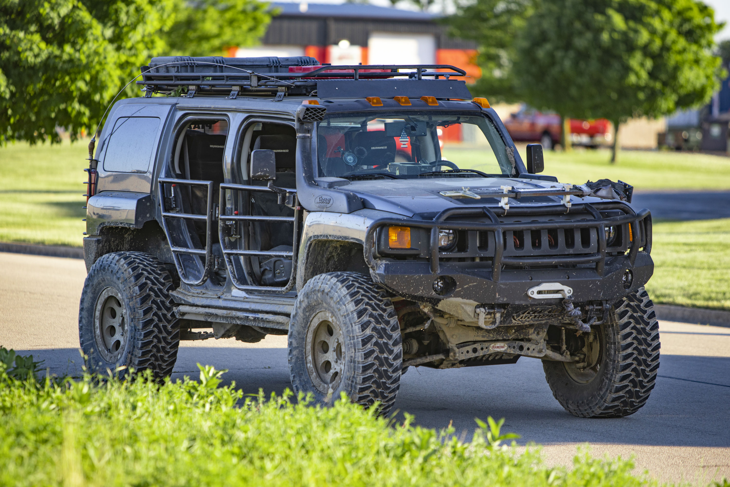

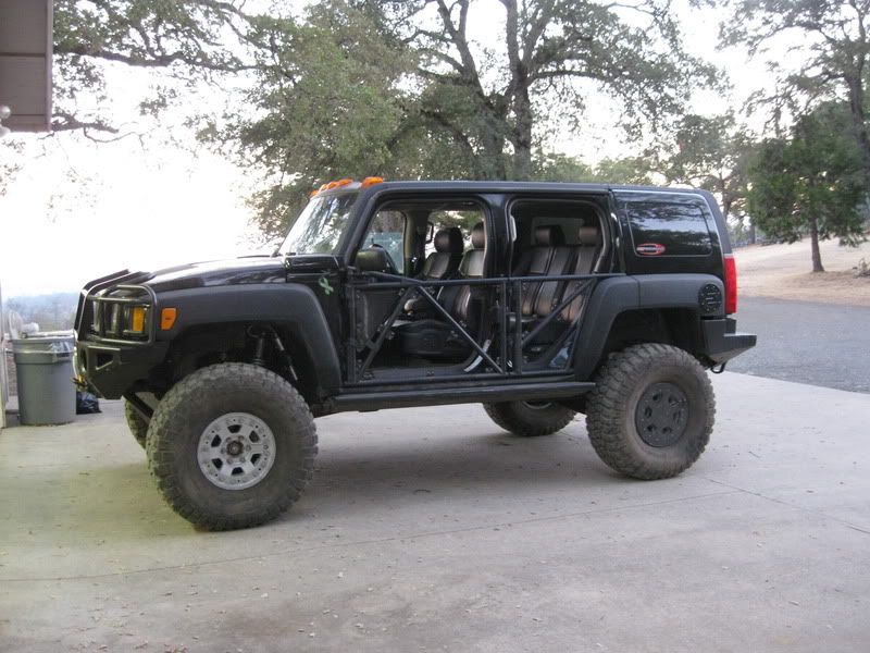

So last weekend I happened to stumble across somthing really rare on craigslist: a custom set of Hummer H3 Tube Doors! Finally after on criagslist for over a year of stupid crap, I found somthing good! I didn't waste any time and bought them straight away. I thought I should share some photos to give people some ideas different ideas if they are interested in making their own.
I think the cost to have a shop make them for you would be somewhere around $1200-$1500. $800 for materials and $400-$700 for welding labour. The guy that I bought the doors from said he just paid $800 for materials and he got labour free. I am guessing the free labour was probably a good friend. If I am not mistaken I am the 3rd person to have a set a tube behind Bebe and SlcHummer.

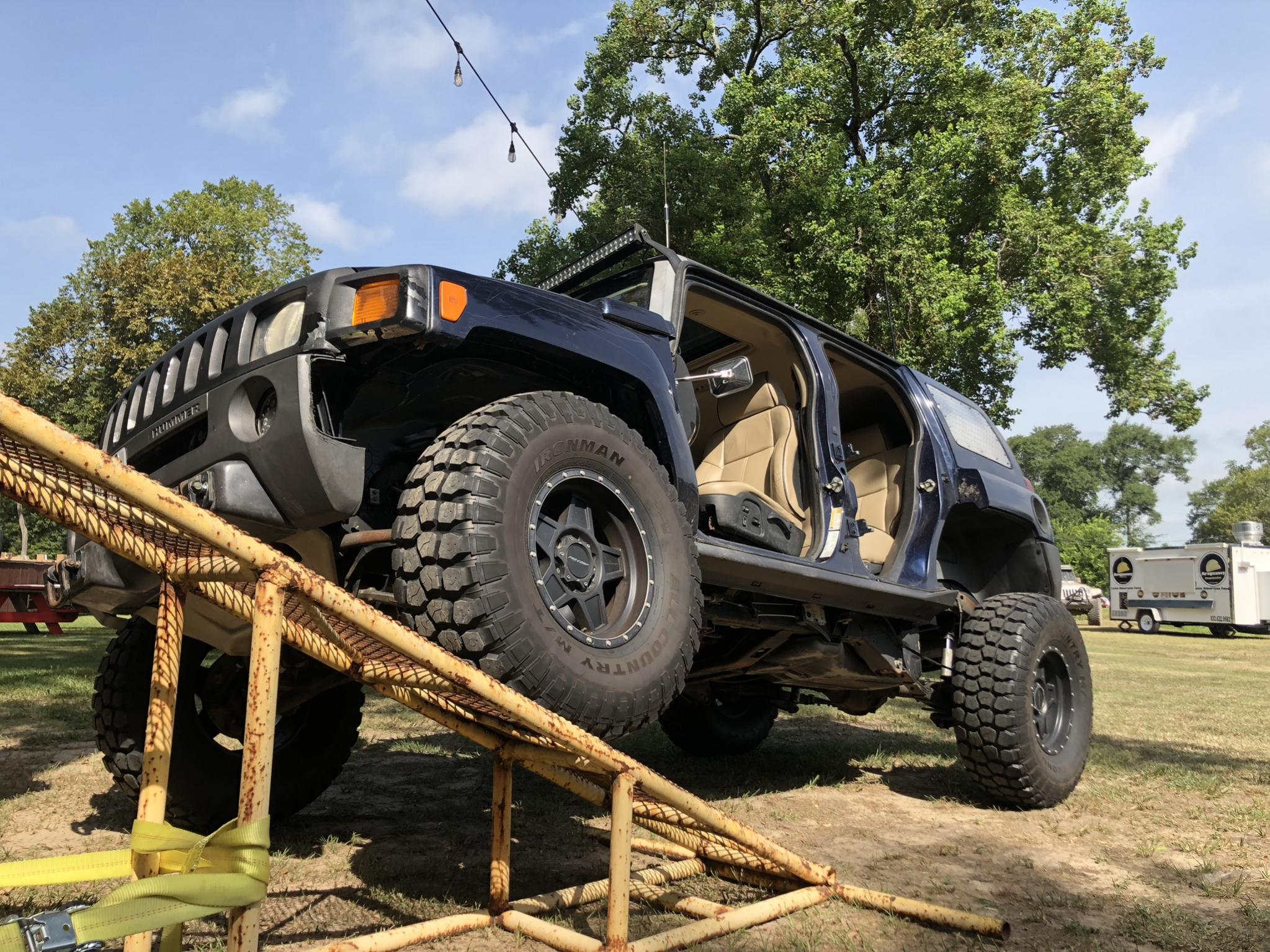

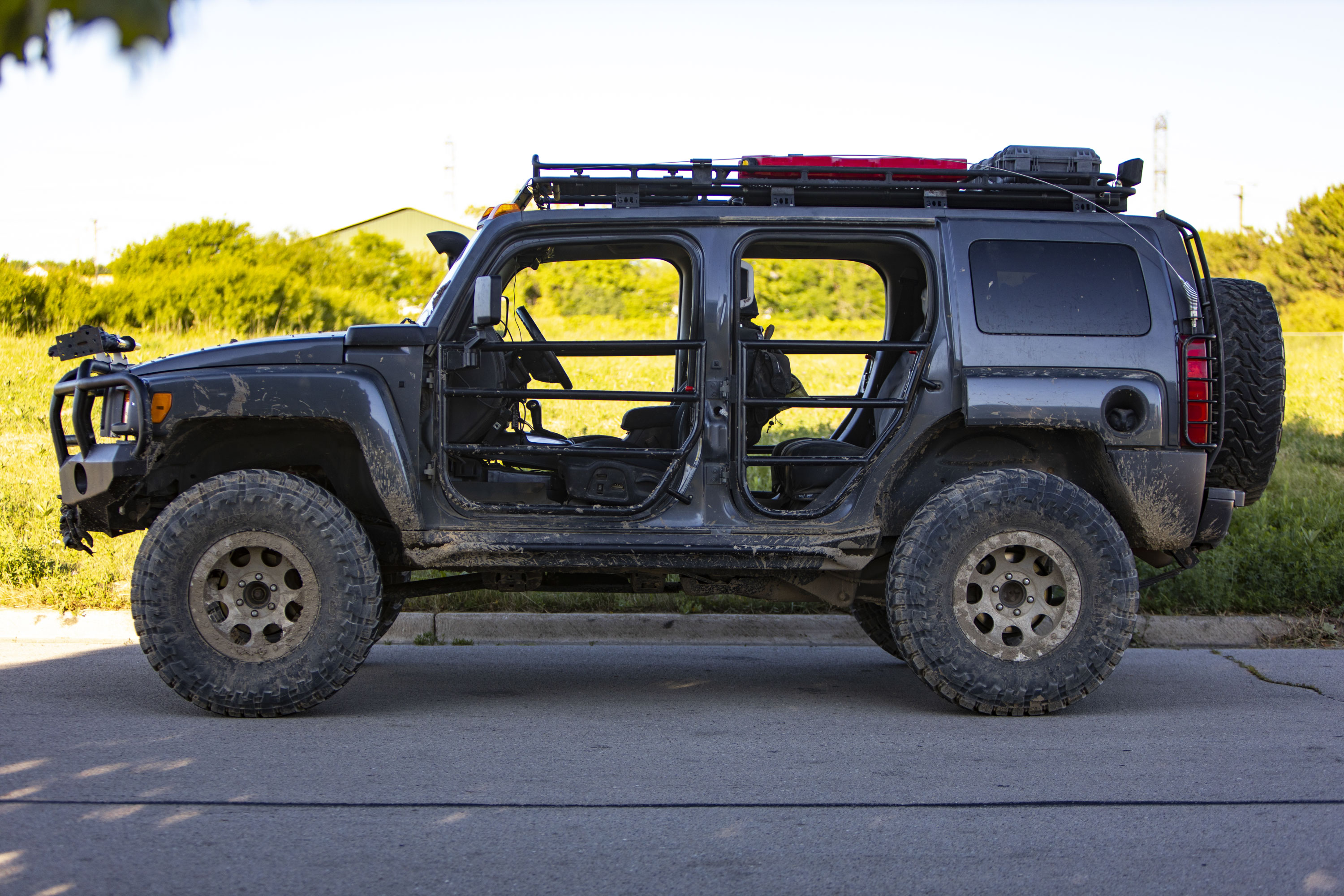

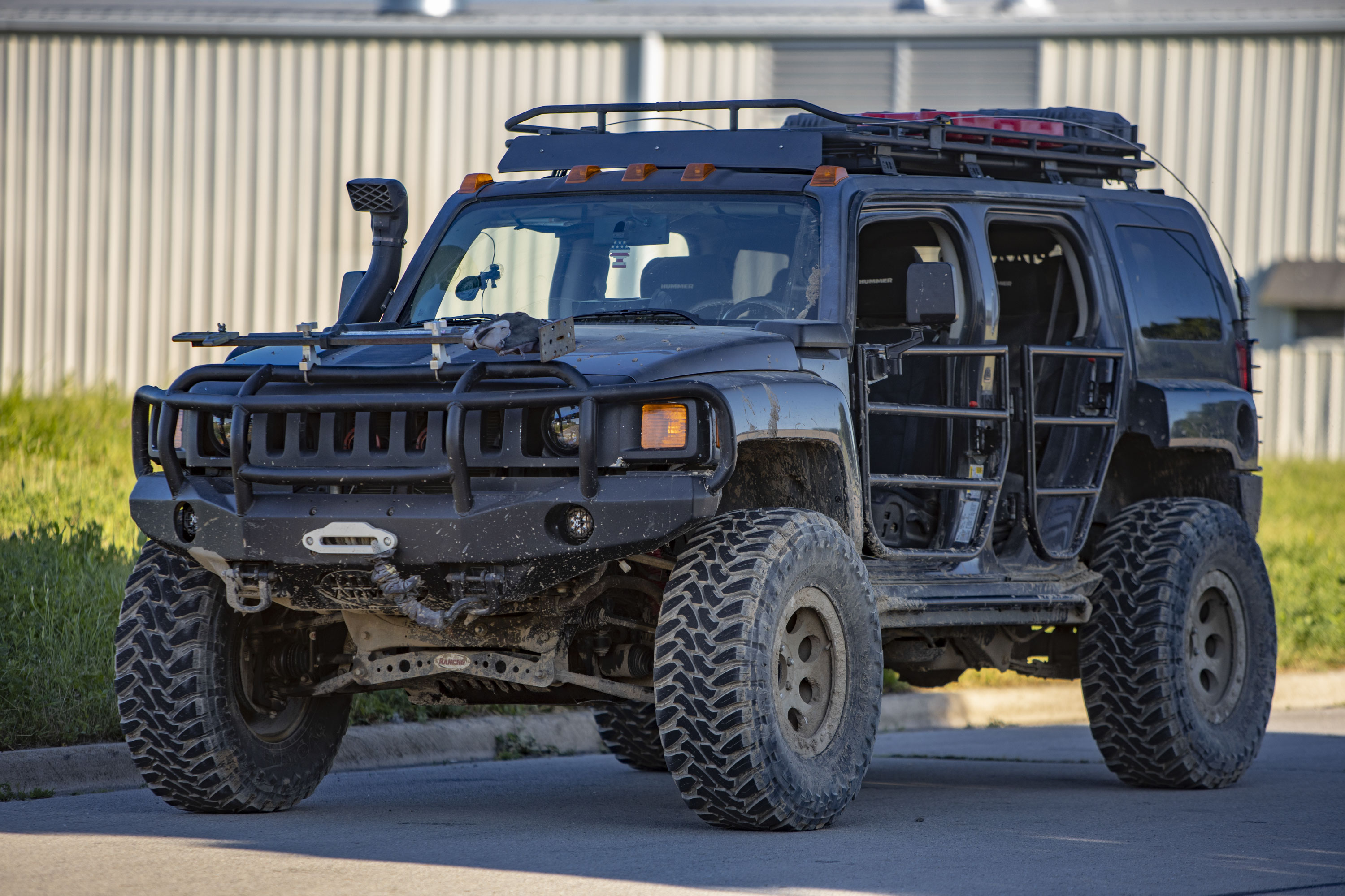

Functional Door Design Can be used as a ladder to get to the roof.
Factory H3 Door Hinge is Used To Mount These. This hinges were taken off the factory door. I plan to buy new hinges so I can keep my factory hinges on my full doors.
Part of the tube sticks out and pushes in the factory door sensor. This allows you to use your H3 normally not having to work about the "Doors" messsage on the cluster and your dome lights staying on all the time.
