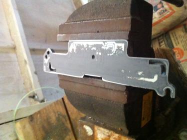

I tore it apart after removing all the inner panels. I found it badly corroded and the thin PCB was trashed and several of the traces were just gone. I took a while to think about how to modify it and I came up with a pretty good solution for $20.00.
1. Remove all the LED's, and sand off the PCB leaving a nice flat and clean surface.

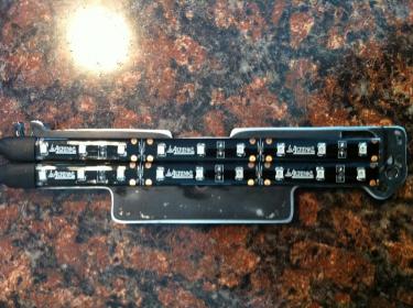

4. Cut the two LCD strips so that they fit across the third brake light opening perfectly.
5. Cut a notch on the power lead side into the OEM third brake light housing so the strips can mount as flat as possible.
6. Peal back the 3M adhesive tape, and place the LED strips across the OEM aluminum plate.
7. Tighten the two mounting screws being careful not to over tighten them.
8. Connect the blue + OEM wire to the black/white + on the LED strip and the black - OEM wire to the black wire on the LED strip.

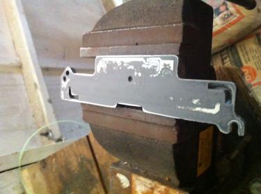

View attachment 12452View attachment 12453View attachment 12454

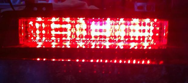

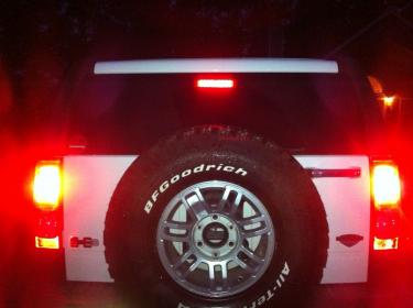

Thanks guys! Here is a shot of it in the dark. I never saw my OEM third tail light, but I'm very happy with the results.

I wish I had taken more pictures during the mod, but it's pretty basic. The main thing is removing all the old stuff from the aluminum heatsink so that you have a nice clean surface to install the LED strips on and cutting a small notch out on the power lead side so you can mount the aluminum heatsink as flush as possible. The wiring is basic as well. You'll be installing two strips cut to fit the opening, so you then take the wires and put them together black/white to black/white and black to black then connect it to the OEM wiring from there. I installed some male/female connectors so in the future if they ever fail I can just install some new ones and simply plug them back in. As a finishing touch I taped it all up so I wouldn't get an annoying rattle.
