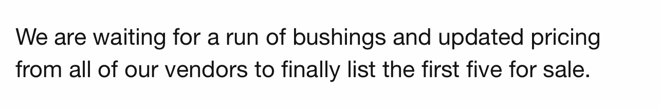

Well it was finally a success! No leaks and the new HD plunging CVs fit. At full lock and full compression with the bump stop slammed all the way into the cup the inner rubber boot barely touches the control arm but it won't cause any issues. Our old cvs with the tripod joint and larger boot rubbed often at just below ride height and we never had a boot fail in 8 years so we are not concerned with this ever so slight contact in extreme conditions.
We are waiting for a run of bushings and updated pricing from all of our vendors to finally list the first five for sale.
