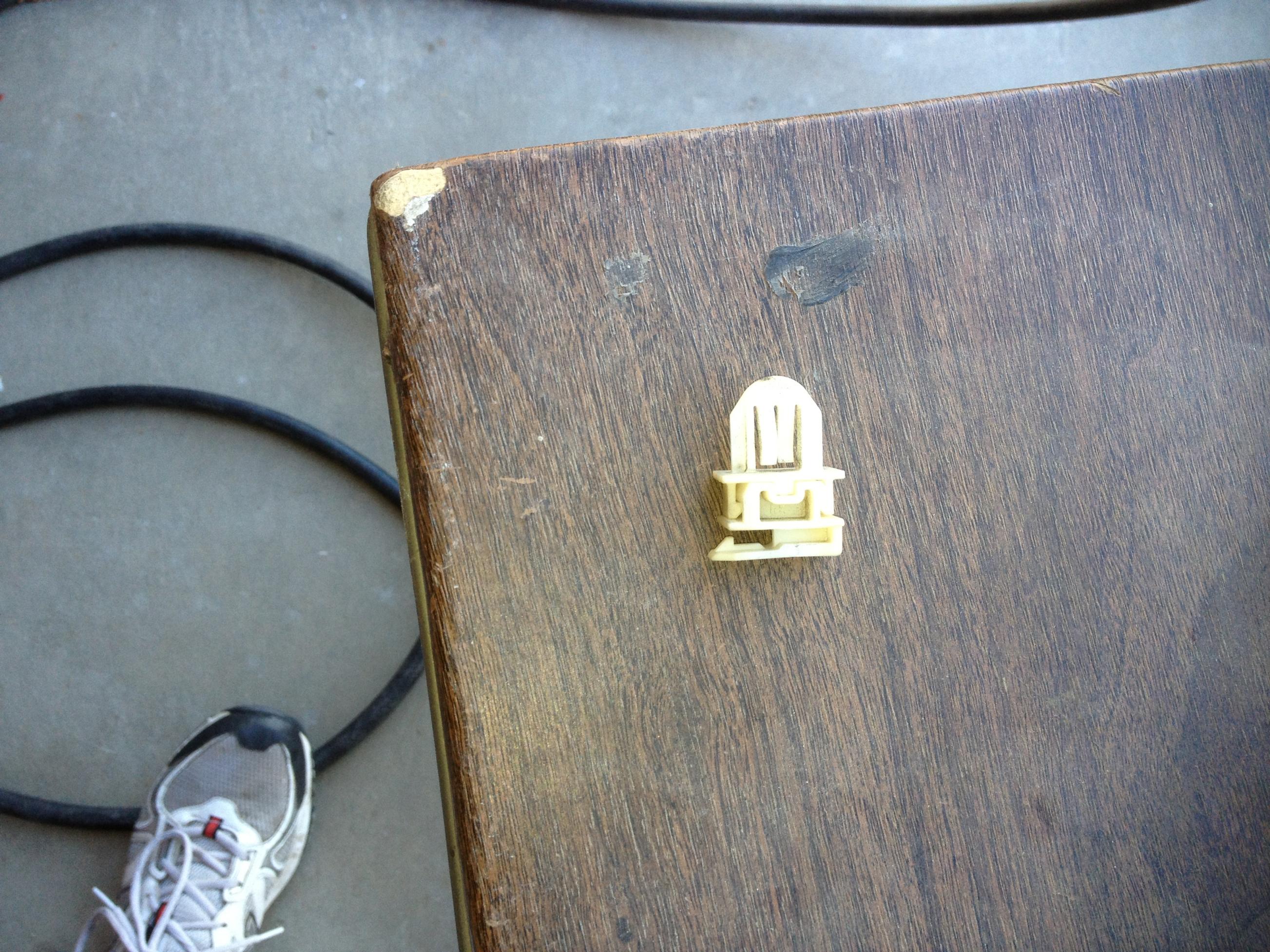

Also, as I was dismantling the grille I broke two of four retainers, You may want to purchase these ahead of time, they seem to be special order from the dealer.
Part No. 11561829 Retainer. $8.82 each. Total of 4.

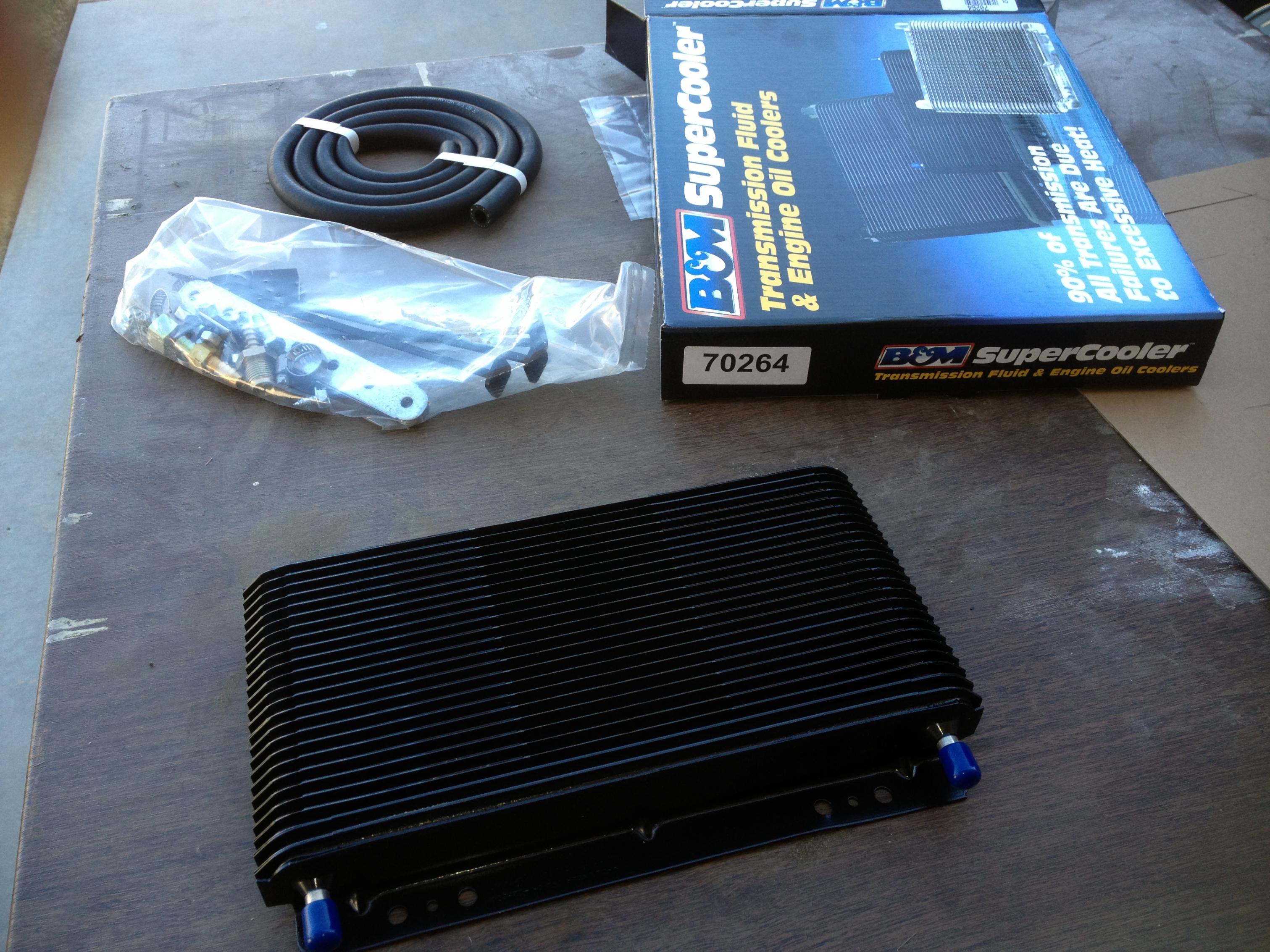

The Kit I bought is B&M 70264 Transmission Soopercooler 24000 GVW and 14400 BTU. I bought it from JEGS for 65.99 + Handling.
The reasons I chose this one is that it is a stacked plate design, good BTU disbursement and built in bypass.
Per B&M they state “The cooler will guard against excessive overheating, but will not overcool the transmission in winter weather”

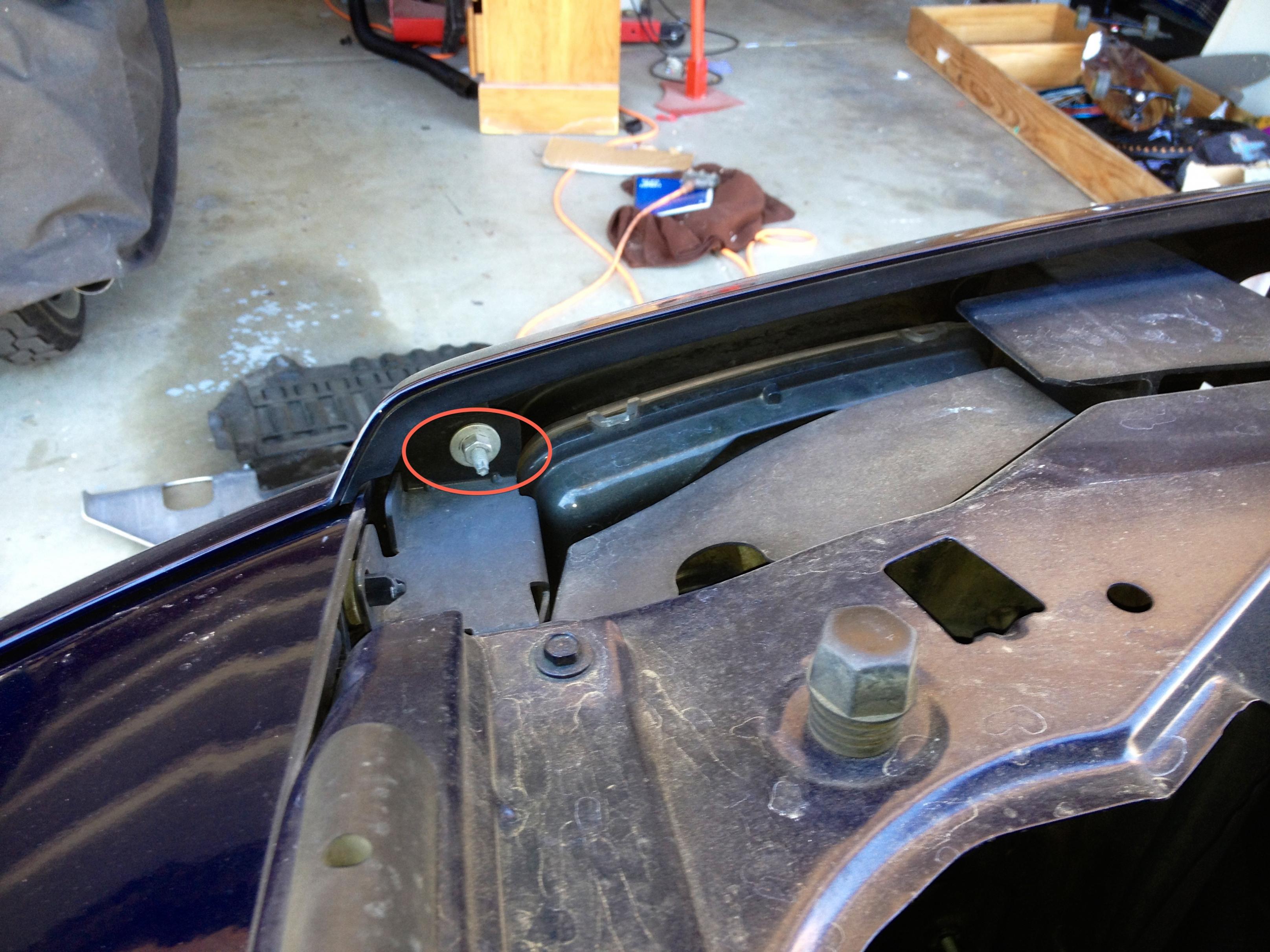

On the back side of the grille from under the hood remove the bolt on each corner.
Now remove the two bolts at the top of the grille from the front.

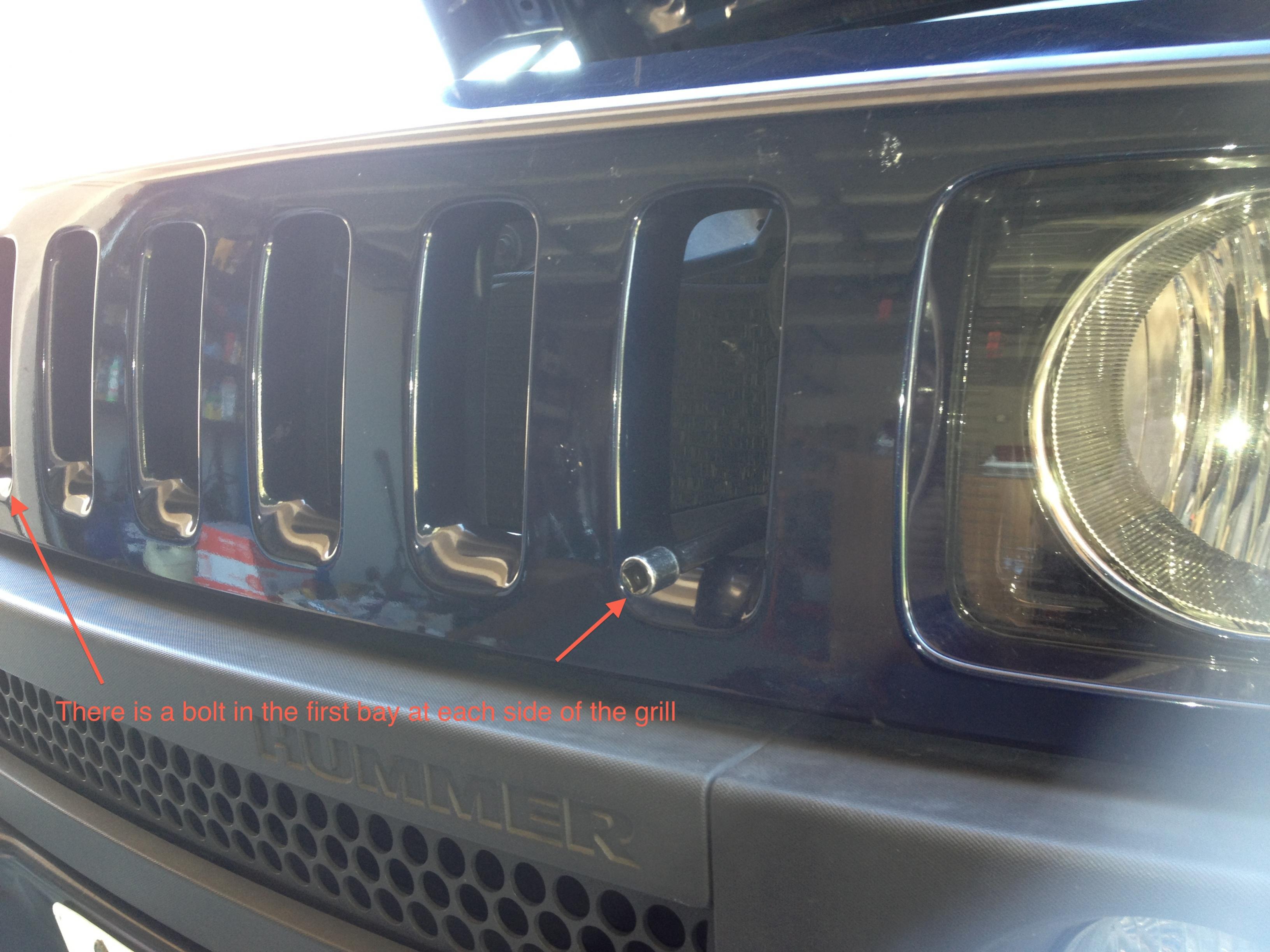

Now remove the two bolts in the first bay of each side of the grille.
Now pull straight out on the grille at each side around the headlights, be careful this is where I broke my retainers.:whaa:

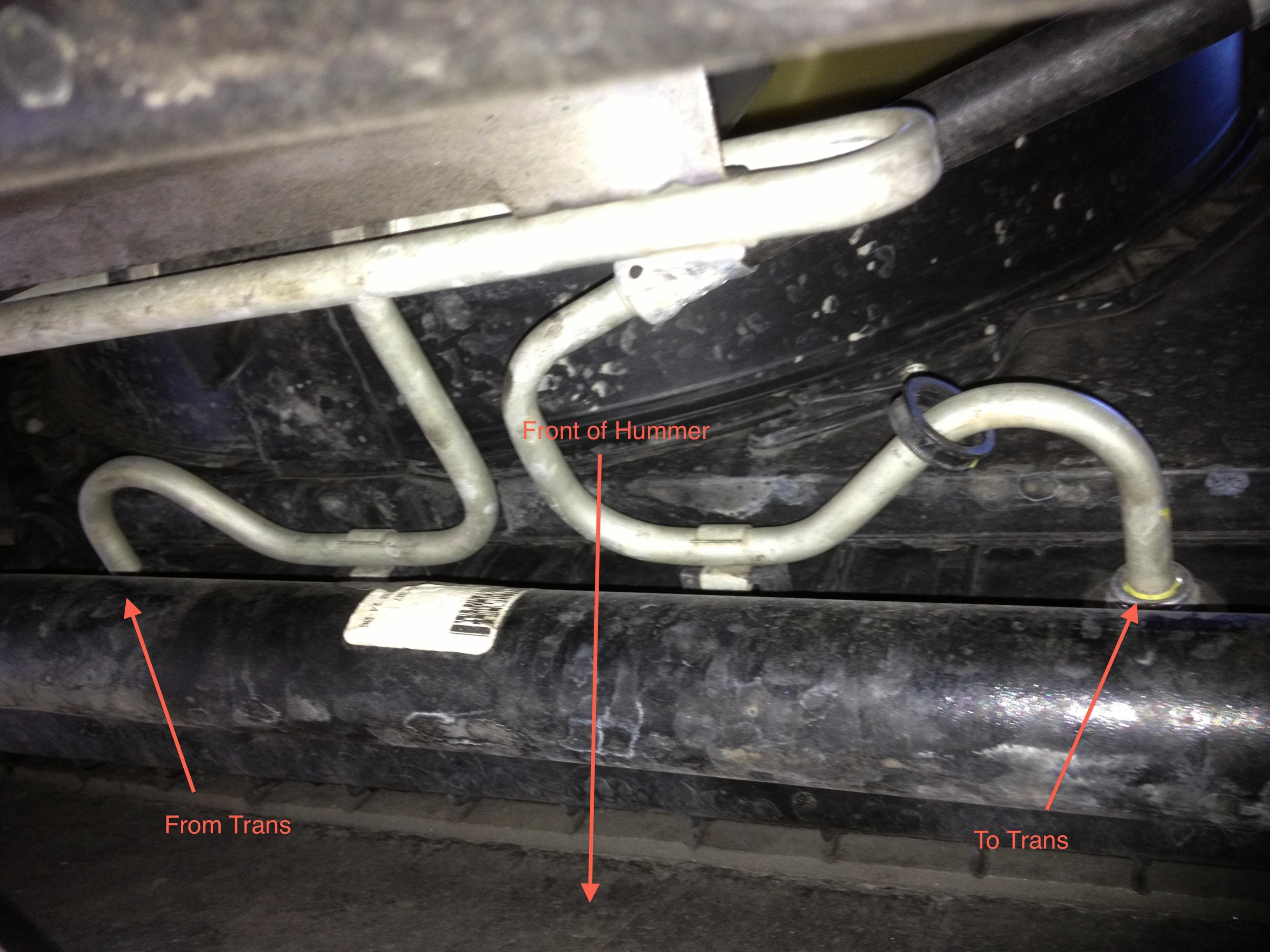

Now from underneath, remove the C clip located in the groove of the transmission connector in the bottom of the radiator.
Put an oil catch in place under the cooler lines as transmission fluid will freely flow when the line is disconnected.
Now pop the transmission pipe from its retainer under the radiator and the connector will now pull right out of the radiator.
Hint:
I used the plugs that were on the cooler to place over the end of the lines to reduce the amount of ATF lost.
Cut the transmission line at the desired locations.
Remember now that the transmission line on the DRIVER SIDE gets connected to the BOTTOM of the cooler and the PASSENGER side line gets connected to the TOP, otherwise air locks may occur inside the cooler and you will not have desirable results.
Hint:
