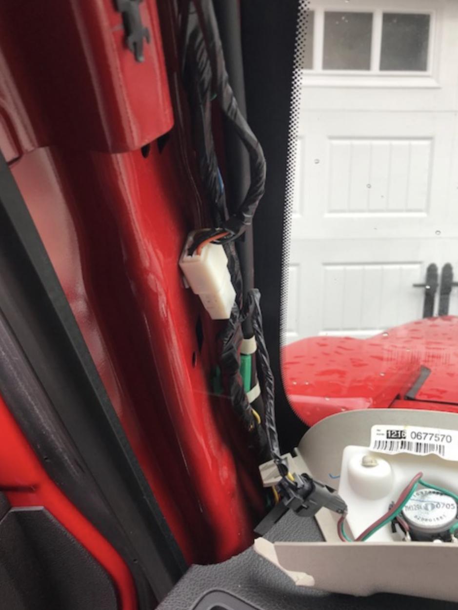

Looking to install a Homelink garage opener in my 2007 Hummer h3. Mine has the luxury package, which in 2007 GM removed the lighted visor mirrors from the luxury package and charged extra for them. This makes the install difficult because there is no power running to the visors. I have seen an older thread about installing a homelink but its missing some information I need. I was able to find visors on ebay with the homelink and lighted mirrors with the original connector. I also found the connector to splice into the wiring to plug the visor power in. I could care less about the mirrors but decided im going to etrofit the homelink and mirrors into my visors because my visors are not stained and in really good shape. The previous owner some how broke the housings for the mirrors in my h3 and found this out when I pulled the visor down and the whole mirror assemble hit me in the head. I opened the A-pillar on the drivers side to look at the wiring. Does anyone know what wires need to be spliced into? Most of it is taped up with electrical tape and its difficult to see what is what. And for the passenger side, can I get power from that side? I attached a picture of the wiring.
