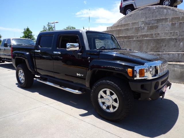

View attachment 11188View attachment 11189
Thanks for all the great info. Over the weekend I went ahead and cranked the T-bars up 3 turns each and the front left and front right measured to 23" and then settled at 22 5/8 after driving it a little (started at 21 1/2"). I am happy with the height and ready to get an alignment but they told me they would only have the factory specs for an alignment and not a raised front end.
Does anyone have or know where to find the alignment specs for a lifted front?
I can definitely feel the difference in the ride, a bit more bouncy. The ride was perfect before. Will the alignment help with this or should I also look into some shocks?
