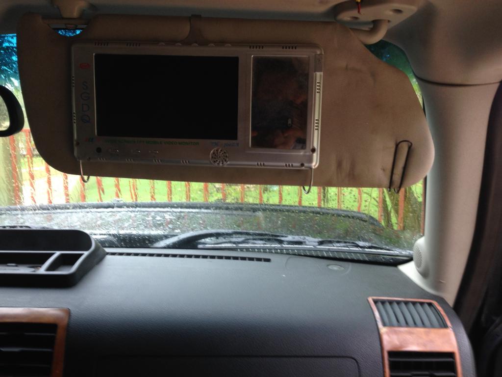

I looked at the BCM and it was very wet. Grrrrrrrrrr
Dryed it out, the truck started. YAY! Drove 30ft and it died. Seems to allow you only to drive short distances.
Can anyone tell me if I order a new BCM if it comes programmed? Also I need the part number 25816709 When I select it says its not for my vehicle. Is it different for the 3.5L ???
Peep
417
Belize
OK got it, the pesky gremlin!
If you look at the top right of the pic, the wire to my spare visor video display was chaffed and touching a ground wire.
Why some bozo decided to take power for this unit off the BCM is beyond me. What a wast of time. But I am back on the road now! er Jungle I mean lol

That must have been a hard find, i'm glad you solved your problem.
