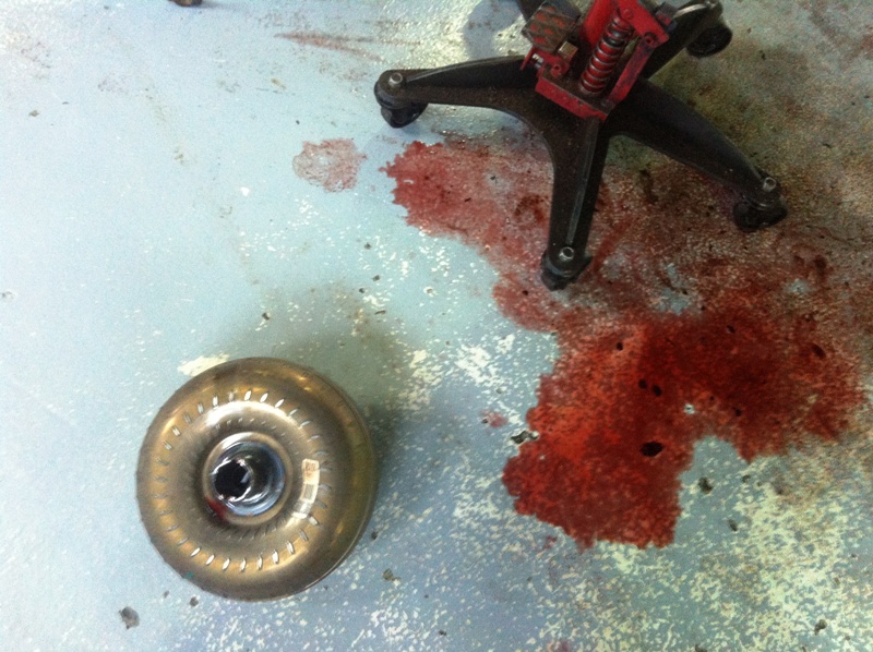

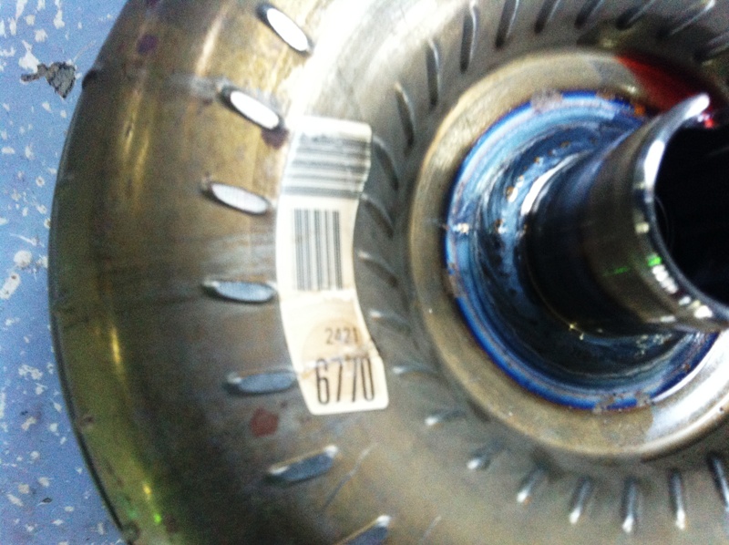

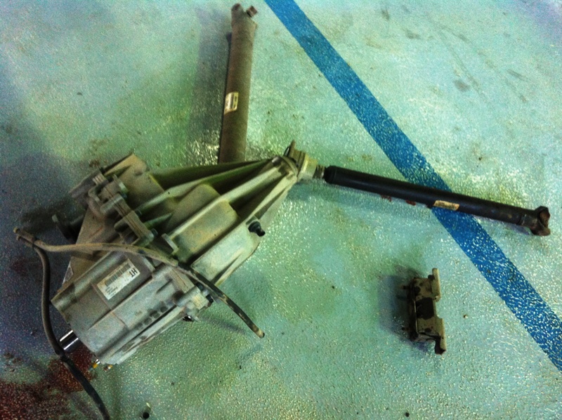

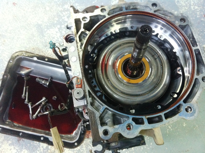

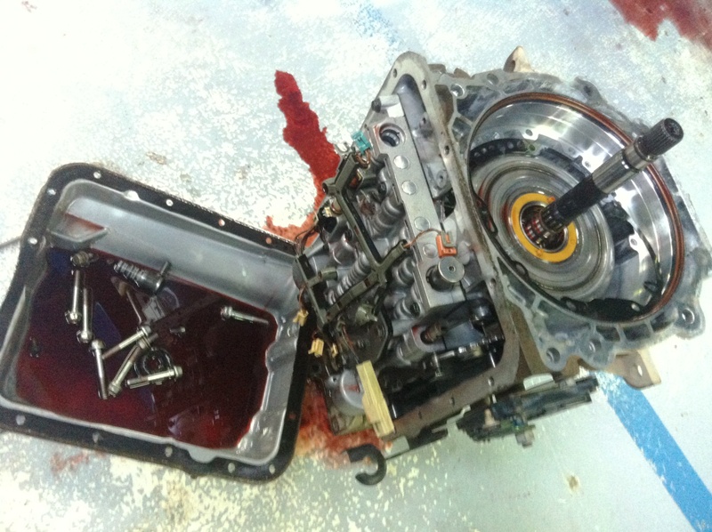

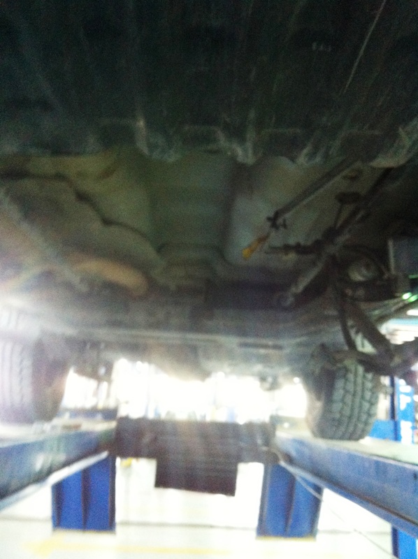

here is 1100 U.S.D for a sensor built to assemble in tranny and i am from Kurdistan i wish this post help other as this forum helped me regards:cheers:
i pay and i love this little Tank
IMG_0113.JPGIMG_0114.JPGIMG_0115.JPGIMG_0117.JPGIMG_0118.JPGIMG_0119.JPGIMG_0120.JPGIMG_0121.JPGIMG_0122.JPGIMG_0124.JPG
