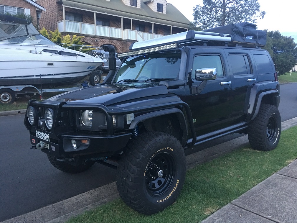

I finally got a first look at the Australian SAS build currently underway. The axle is a Dana 44 with THORparts hubs & caliper mounts, an ARB air-locker, and 5.13 gearing. The axle was ordered with RH drive and no suspension bracketry. Instead of the typical THORparts 3-link, this H3 uses a radius arm setup with coil-overs. Apparently Australia has some pretty stringent restrictions on ride-height, wheel protrusion, and safety. A build like this must be road-tested and signed-off on by a government official before it can be licensed. Dash lights and tampering with electronics are watched very closely. The suspension must be a "manufactured" piece, and these radius arms meet that requirement (unlike a custom 3-link).

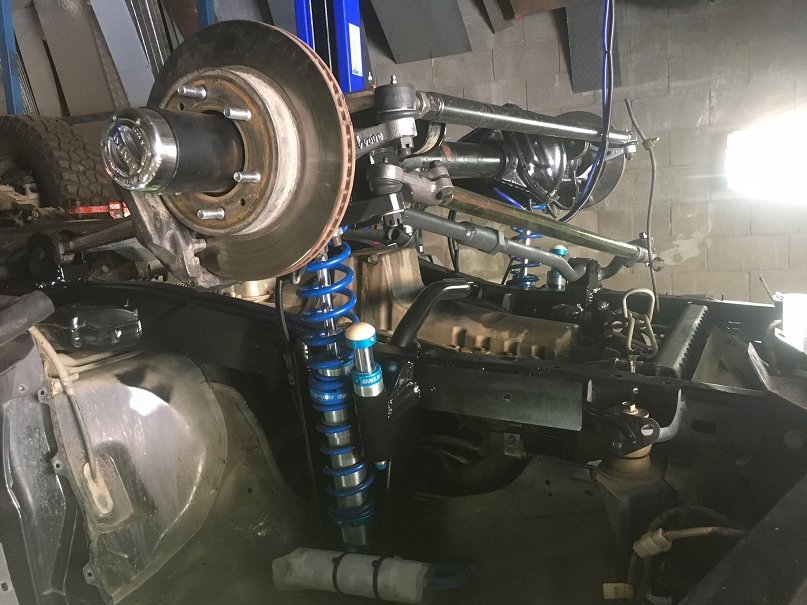

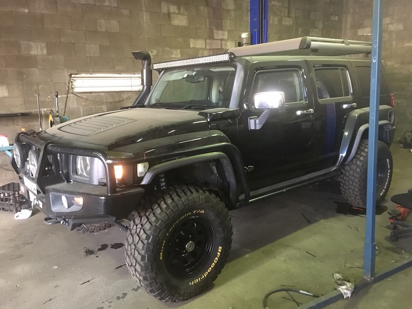

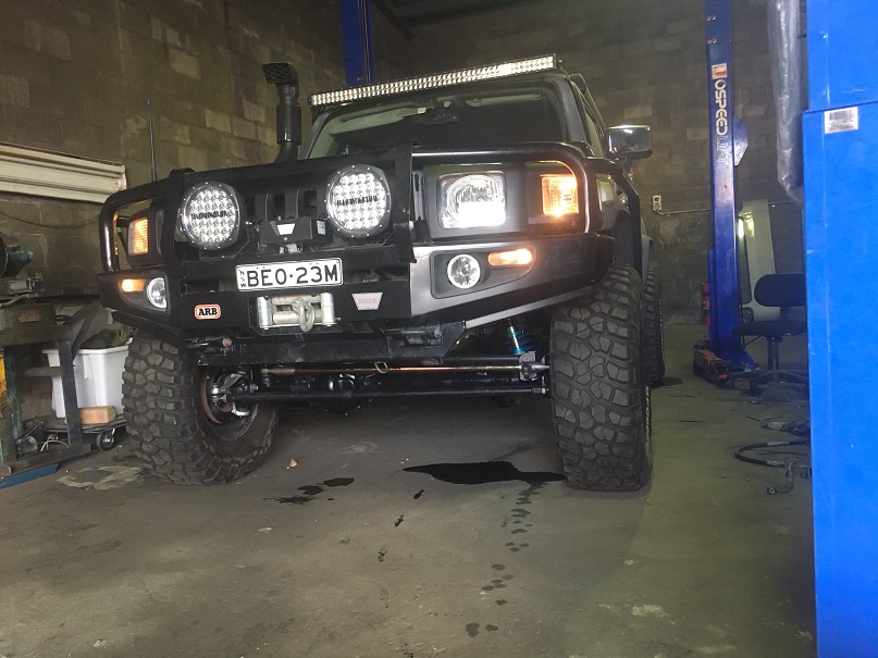

More pics...waiting for bump stops and p.s. hoses...
It appears the new Dana is sitting approx. 1.5" forward of stock. Tires are 35" and as you see from the last photo...there is ample room to stuff them. This probably the lowest riding SAS H3 around, and I am curious to see the final bump/coilover setup. No sway bar yet...not sure if that will be in the mix.

Excuse my ignorance, I'm not knowledgeable about these setups at all. So what makes this able to stay so low? The shock tower looks like it allows the shock and spring to be mounted higher, is that the difference?
I think he will end up with very stiff coils to control the up-travel. He will only have an inch or two before the axle tubes hit the frame rails. That's the real determining factor when setting-up the suspension this low. He is using hydraulic bump stops, so will give him quite a bit of tune-ability. Because he shifted the axle forward and he's only running 35"s...tire rub is not a factor.

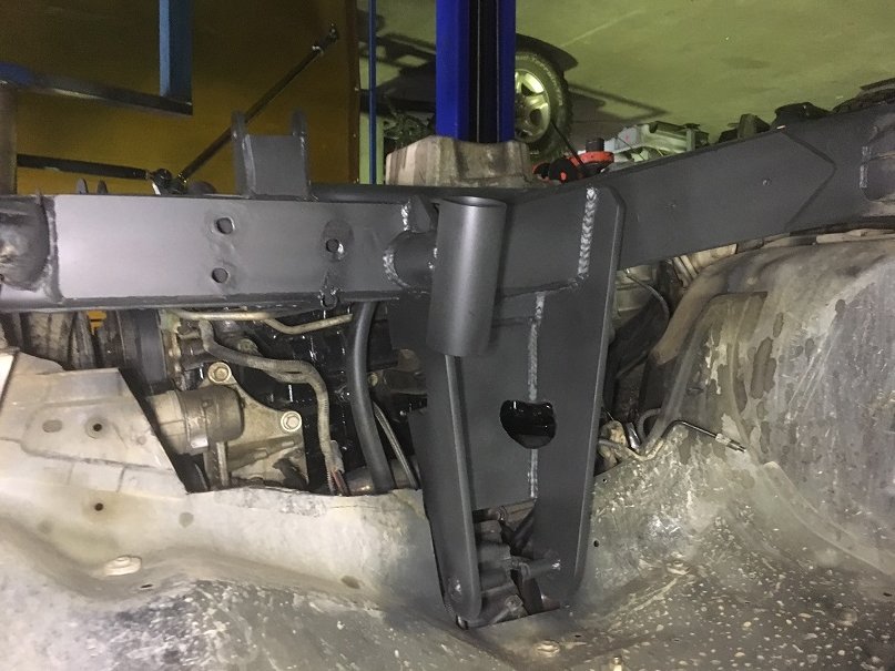

Latest photos from down under. Is there a welder in the house? (hell yes).....
The fabricator is currently having Passlock issues (key stuck in the ignition), due to a dead battery. Rear suspension is a SOA and he is lengthening the rear driveshaft. The Tatton front shaft also needed lengthened due to the stretched wheelbase (front axle moved forward 2"). Coil-over spring rates are 350/250. They are 2.5" tubes with reservoirs...not sure on the length (probably 10"). 2" Hydro bumps (sweet). At this height, he says it has 2" of free travel to the bumps, and another 2" of bump compression.
He seems to think a Toyota FJ-80 front sway bar will fit and he will be adding that. I may look into a LH-drive FJ-80 bar for my H3, as the sway bar has been the one thing I cannot seem to figure out on my rig.
P.S. Notice the tubular crossmember under the oil pan? Niceeeeeee!

Latest update from down under...

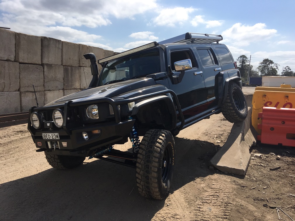

The radius arm SAS rig is up and running. Owner and builder are pretty happy with the results. Although not as flexy as a 3-link, it gets the job done. Shock & spring valving is good enough that they have decided to run without a front sway bar. The truck handles, and brakes very well but, still has enough travel to tackle most off-road obstacles they would encounter. Best of all...the front axle won't snap if you look at it wrong, and it now has gearing to work with larger tires. The 2" stretch on the front axle allows it to sit this low. This is possible in large part to using a Toyota steering box with a forward facing pitman arm. These pics are with 35" tires, and 37" are coming in the near future. The larger tires will probably require a height adjustment, so the SOA might be needed, along with a front coil-over adjustment. Here are some poser shots...
As predicted, this rig is all droop, and no up-travel. It has 5.13s, a 4:1 low, and retains all the factory traction aids. This "creeper package" more than makes up for the limited flex. Although these pics might seem extreme to the typical Hummer guy, this is a very mild build in the Jeep world. I have no idea what the KING reservoir is that is hanging down on the tie-rod in the last photo.
The truck is currently coming back apart for a V8 swap. The owner ran a turbo on the 5-cyl. for awhile but, it smoked the #5 piston. Given the rarity and cost of rebuilding a 5-cylinder in Australia, the V8 upgrade was a no brainer. His swap will be different from state-side swaps because the 5.3 LS is a rare critter down under. So he will be swapping in an LS2 6.0L from a Holden (GM truck). Tranny has been rebuilt with the V8 input shaft and Corvette servos. He plans to run a manual torque converter lock-up (on a switch), along with an aftermarket converter. Stay tuned for more on this build.

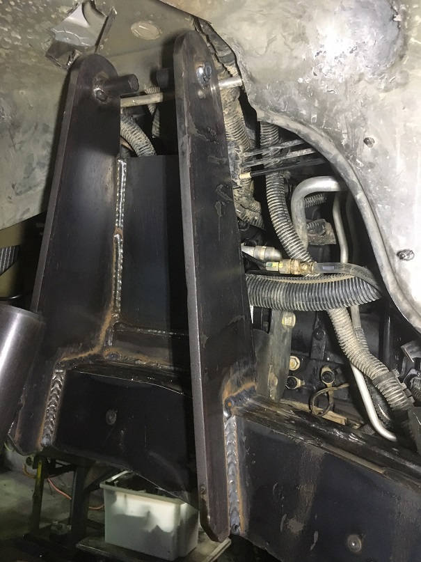

Got an update from the Aussie build. The turbocharged 5-cylinder didn't pan out. I guess it immediately scattered the bottom end. So the owner went for a V8 swap (which is a huge deal in Australia). The suspension works great and he seems to be very satisfied with that portion of the project. Obviously due to the motor issues, he has minimal miles on it. Here's a pic of the swap progress...
