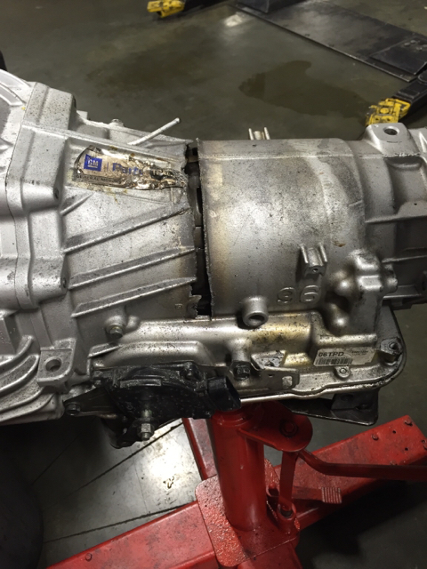

If you ever plan to dinghy tow your 3 behind an RV or motor home, please make sure you put the tcase in neutral. If you put the gear selector in neutral, this is what happens.
This melted the trans case and internal gears together. First for me seeing this
Seems my pic won't come up from tapatalk. Will post it in am

Yeppir. Those fluids don't get pumped around in the t-case when dinghy towing and the engine isn't on.

We talked about that today, think it is pushing 4hi and 4lo at same time for about ten seconds till the red light flashes. Will confirm, the process tomorrow so everyone knows. Bad thing with this, customer bought a trans with GM warranty a year ago. Brought it in thinking warranty. No way we can touch it under warranty.

So just to clarify....you want to dinghy tow it with the transmission in park and the t-case in neutral? That is what i got from the manual

Yup, towing an automatic in neutral is bad news. That's why you must use the transfer case to literally disconnect the tranny from the rolling wheels/axles. Then, putting the transmission in park prevents any rotation of the transmission from taking place. The transfer case is more like a manual transmission that is bathed in gear lube; it doesn't require the fluids to be pumped through it like an auto transmission does. Man, that's some ugly damage to that transmission, ain't it? Unfortunately, oftentimes in life the lesson is given AFTER the test, not before! :)
