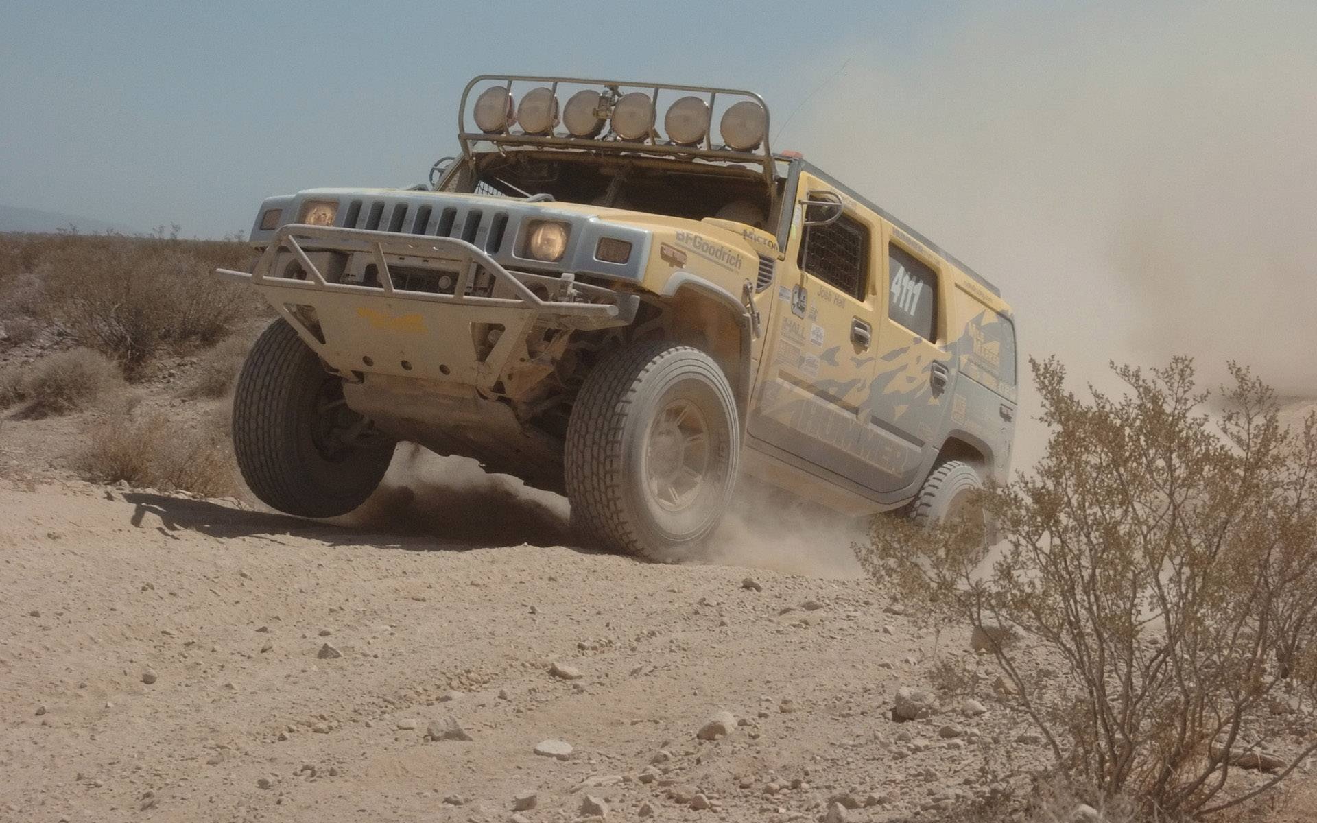

so im assuming its going to look something like this?
If you are running stock set up. I would recommend a few sets of inner and outer tie rods. Sometimes you can't get the outer apart from the inner depending in where it bends or breaks. Idler and pitman arm. And you already said a steering gear. Might want to throw a pump in with the tires you will be running. And the lines. Most of this doesn't take up much space. The gear is heavy though. And throw in at least one hub and bearing.
Almost forgot, halfshafts too. Looking forward to this and the build. Best of all good luck!
