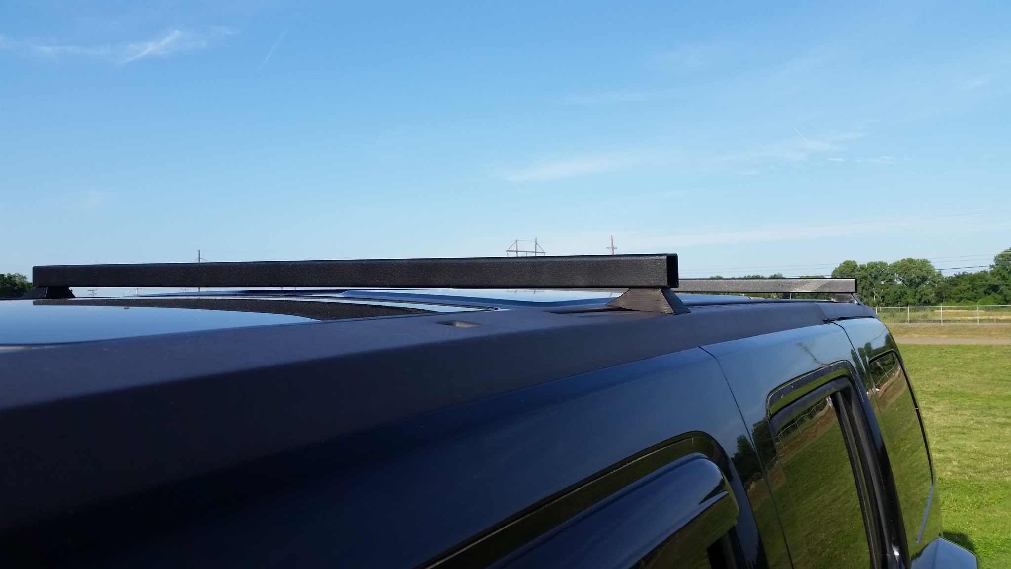

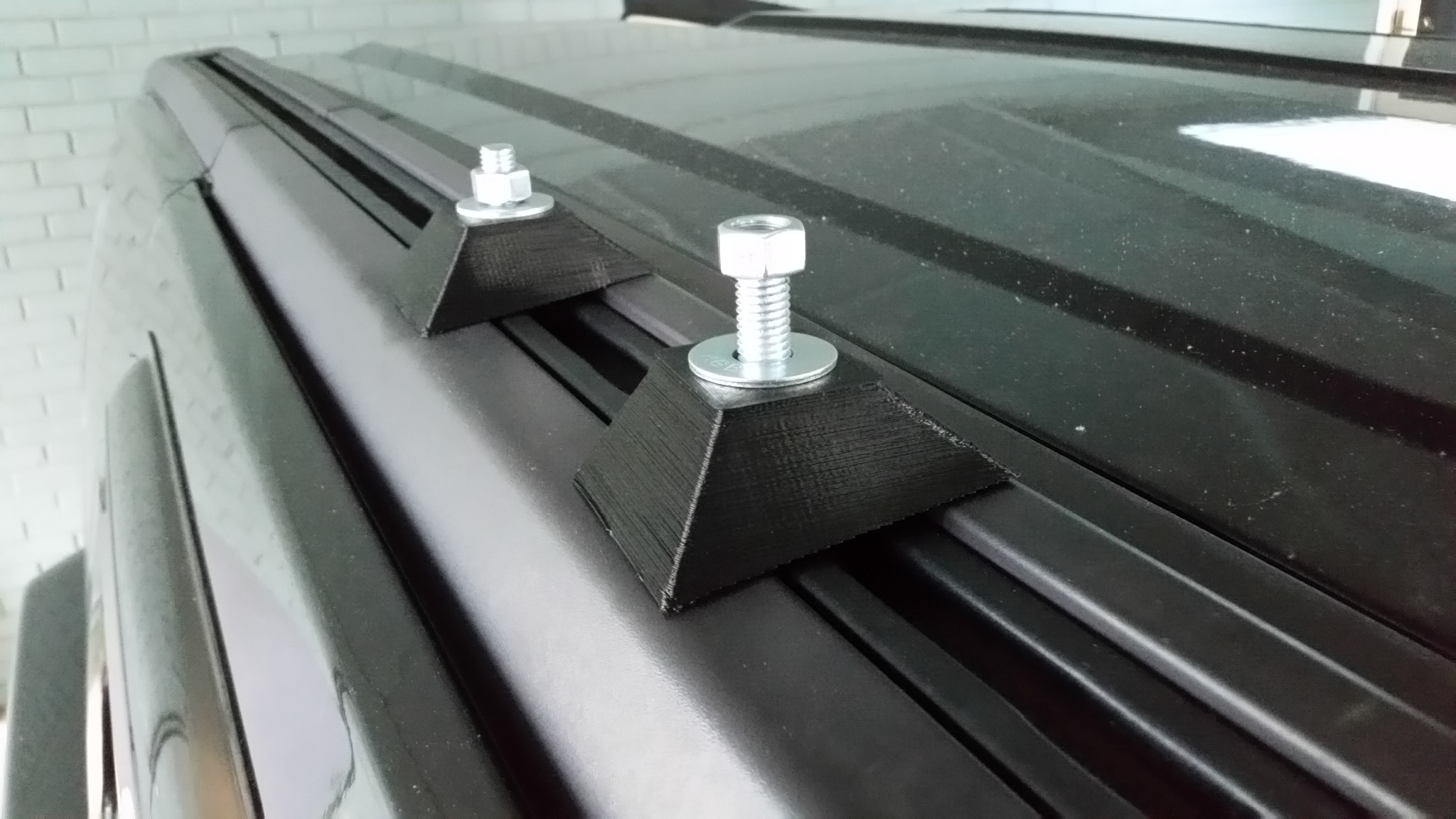

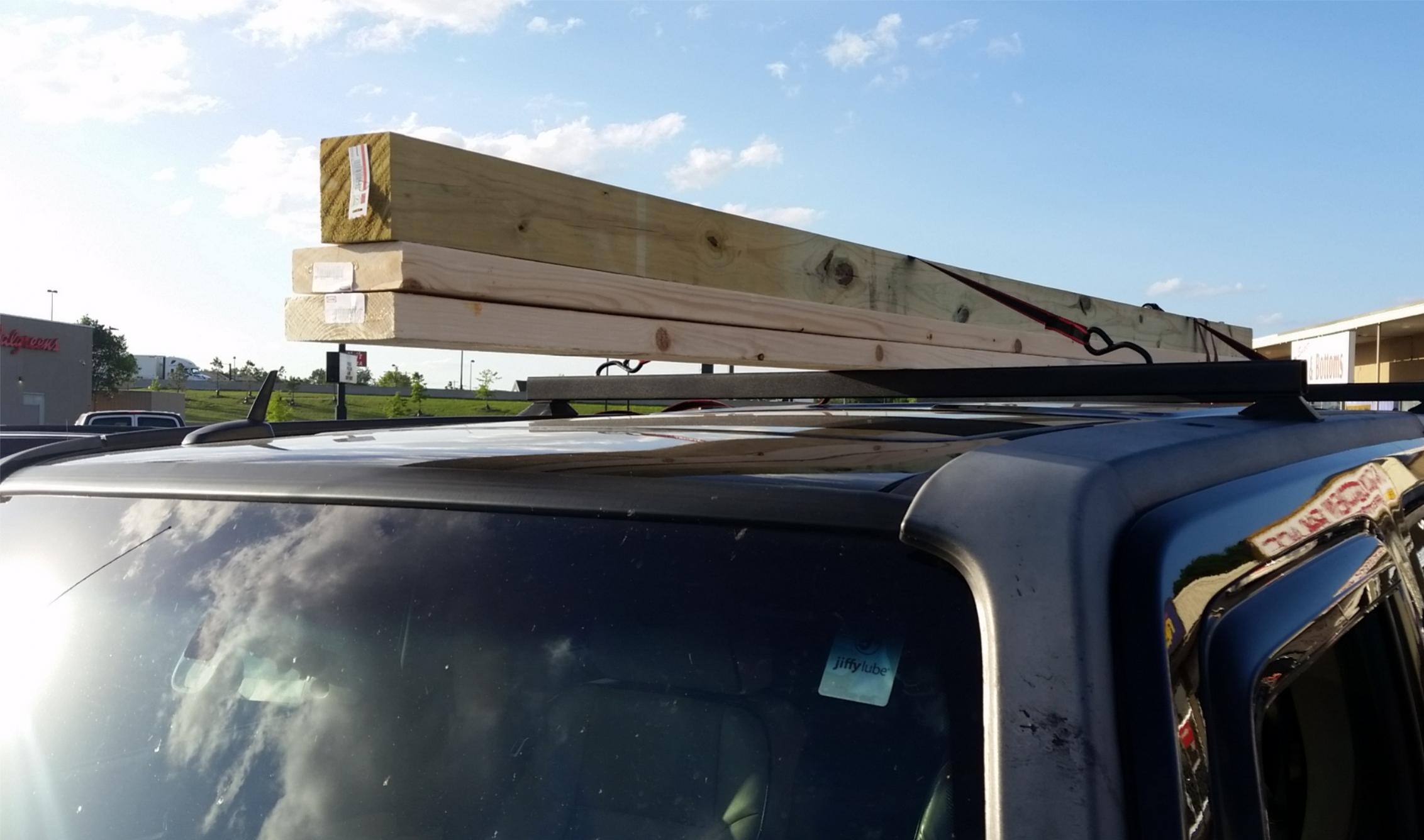

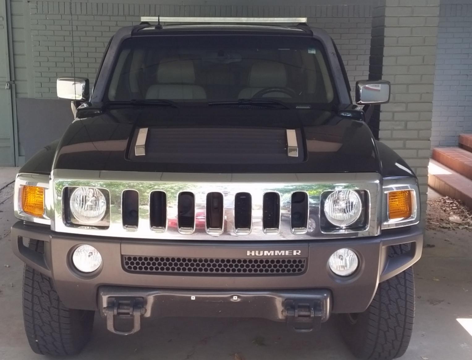

Hey Everyone,
I just thought i would share my latest project with you all. I made a set of crossbars that I consider to be more functional than the OEM/Aftermarket options at less than half the cost.
The seed for this project started when I first bought my H3 and got rid of my truck, which was my main lumber hauler. I ignored the idea & the inability to transport large lumber until my wife and I decided we wanted to take a road trip but we wanted the back of the H3 to be a flat platform where we can have a small bed, and a little fridge/cooler for our food. With this new requirement, i decided it was time to make the H3 more functional and ended up with this DIY Crossbars that I think are superior to anything that can be purchased readily for the H3.
Because of the strength these bars offer, i can use them to carry lumber and equipment. I plan to find some type of storage solution for our clothes and stuff regarding the road trip which can be fastened to the crossbars directly.

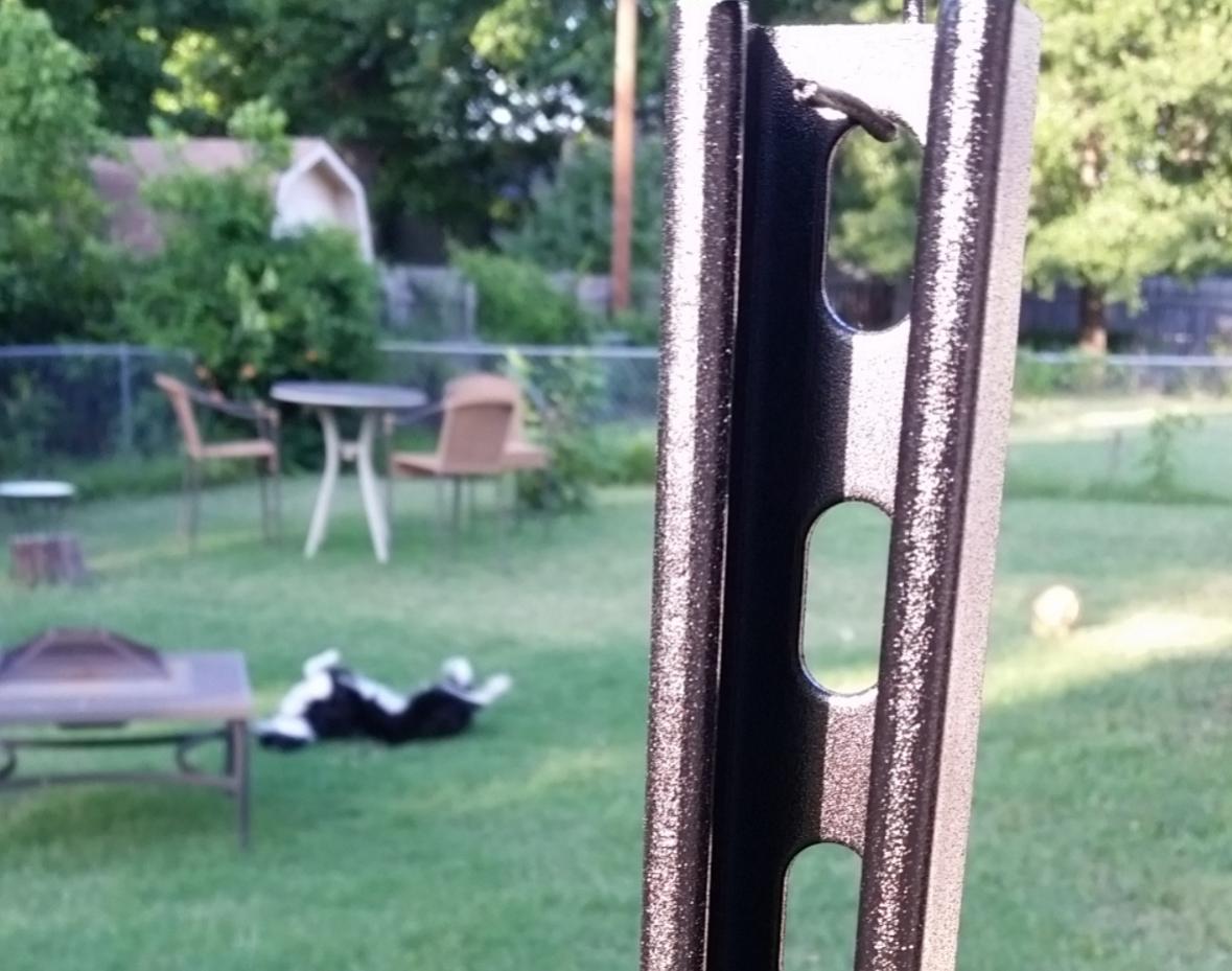

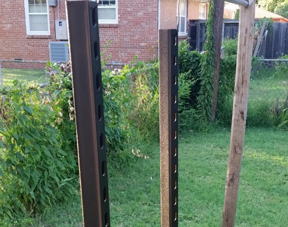

Materials used:
1x 12 Gauge superstrut - 10ft
4x 1/2" zinc plated carriage bolt - 2-1/2"
4x 1/2" zinc cut washers
4x 1/2" zinc nuts
1x can of spray can bedliner
4x custom designed & 3D printed crossbar mounting brackets (my friend 3D printed them for me).
Total cost was approx $40 in materials

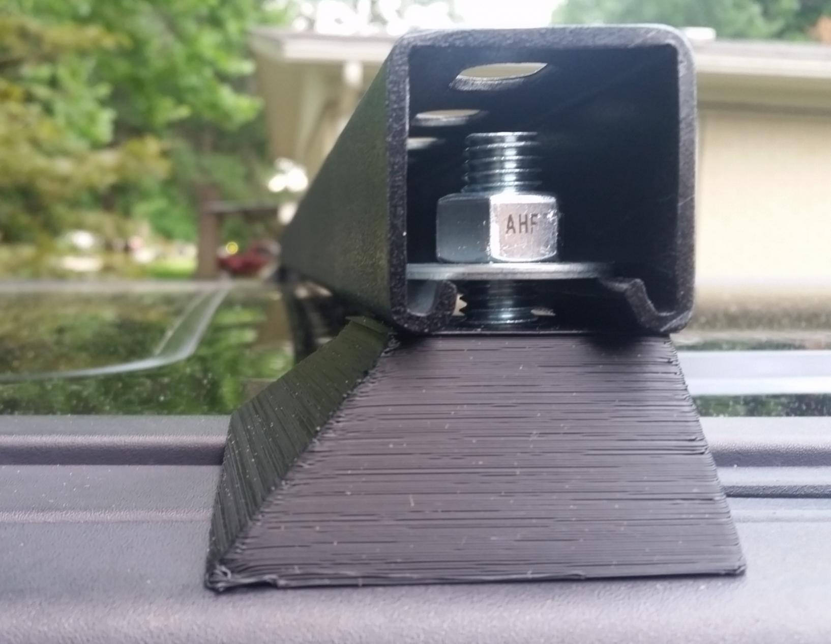

I like it!
I have had bad experience with printed parts, but for this applicable with a primary compression load it should work great!
Thanks mdocod, I dont have much reservations with 3D printed parts. I think it is just a matter of the material used to create the part. My friend gave a suggestion to modify the 3D model to accept a bushing of equal height to the printed part that serves as the load bearing portion. Its a good idea so i may do a redesign in the near future. I am always up to improving the design. Now i just need to test it and put it through its paces.
Neat, but personally I'd get some aluminum bar to use for the spacers, the roof channels are level with each other so that's not an issue. I used some 1" tall x 1.25" wide bar for spacers for my roof basket and it works great.
Thats cool JPaul, do you have any pictures you can share?

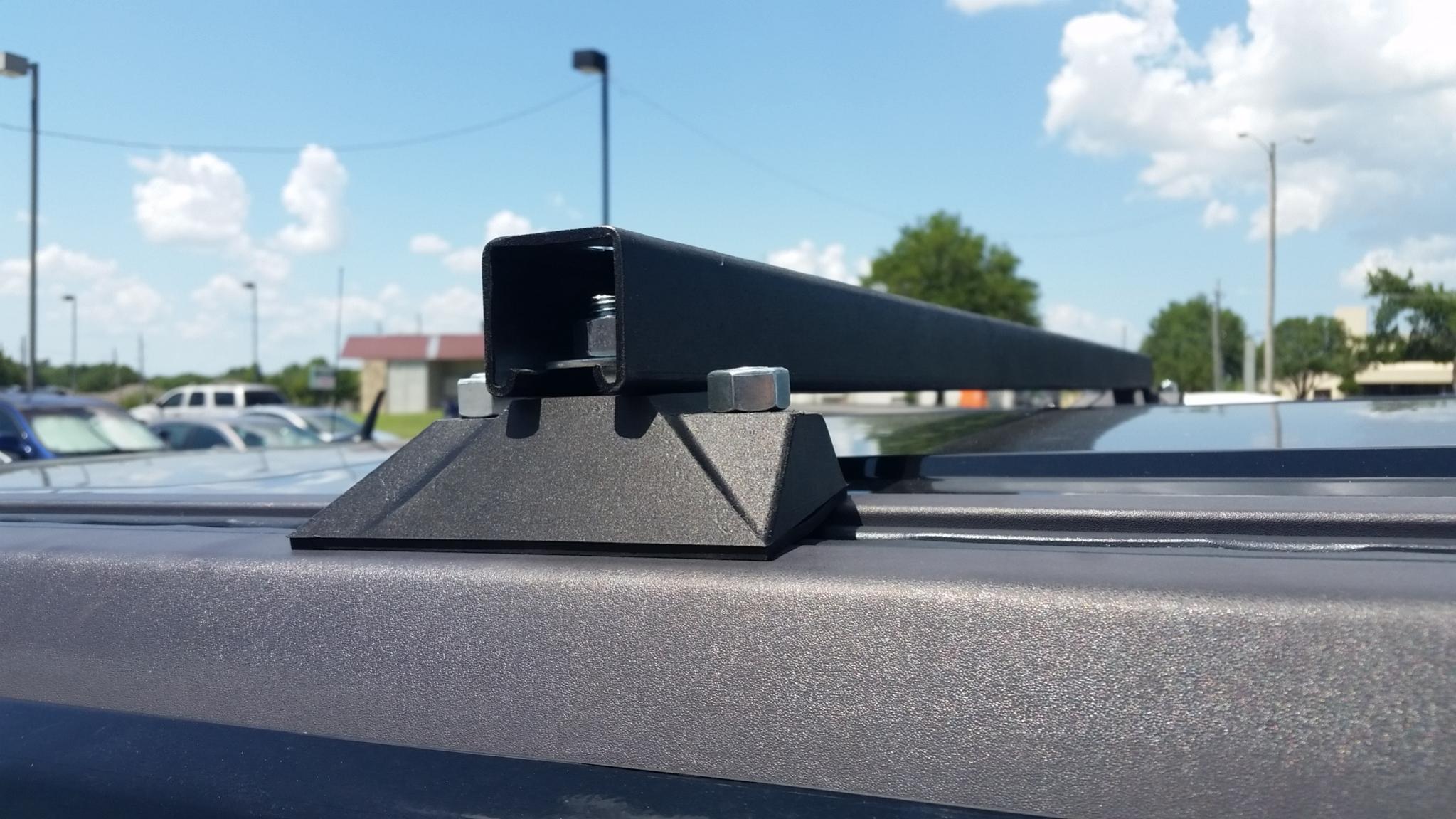

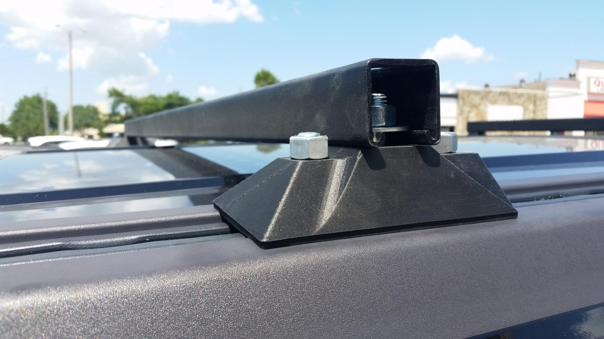

UPDATED!!!! Mounting Brackets Re-design
Well after a month of testing my crossbars, i will say that they are performing exceptionally well. I love the strength of the superstrut. I ended up re-designing the mounting brackets for ease of adjustment. Before i had to loosen up a (mostly inaccessible) bolt and the whole crossbar would be susceptible to shifting off. With my new design, the crossbars stay firmly attached to the mounting bracket, but the bracket itself is easily able to be loosened & adjusted to a desired length.
I changed the material used as well because the old ones suffered some deformation due to high heat. This material is a carbon fiber reinforced plastic with a rubber gasket making contact between the mounting bracket and the mounting rails. The finish is also much better with these.
Traxx
682
PNW
There is nothing to prevent a side load shift? Without even a lock washer, If they loosened a tad the whole rail appears to be able to slide right off either side.
Zerreitug
29
Tulsa, OK
Traxx, Thanks for the perspective. Although I have driven 300 miles with the new brackets, there has been no signs of the nuts loosening up with normal vibrations. I think the rubber pad i have under the brackets are helping with that.
However, that is a valid concern and I will definitely look into a solution for that. Thanks for the input.
Happy Hummer
1,462
Wisconsin
Nicely executed. I do agree that the side loading could be an issue. A simple fix would be to use a nyloc nut or a castle nut with cotter pin. I like the second try a lot better.
