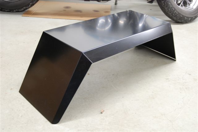

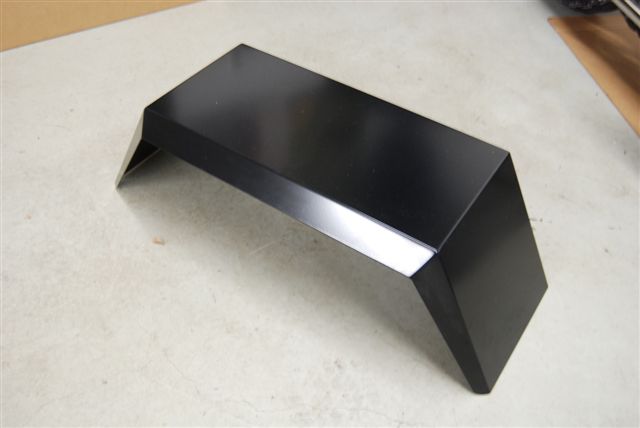

Looks like you're ready for some THORparts expo trailer fenders...
