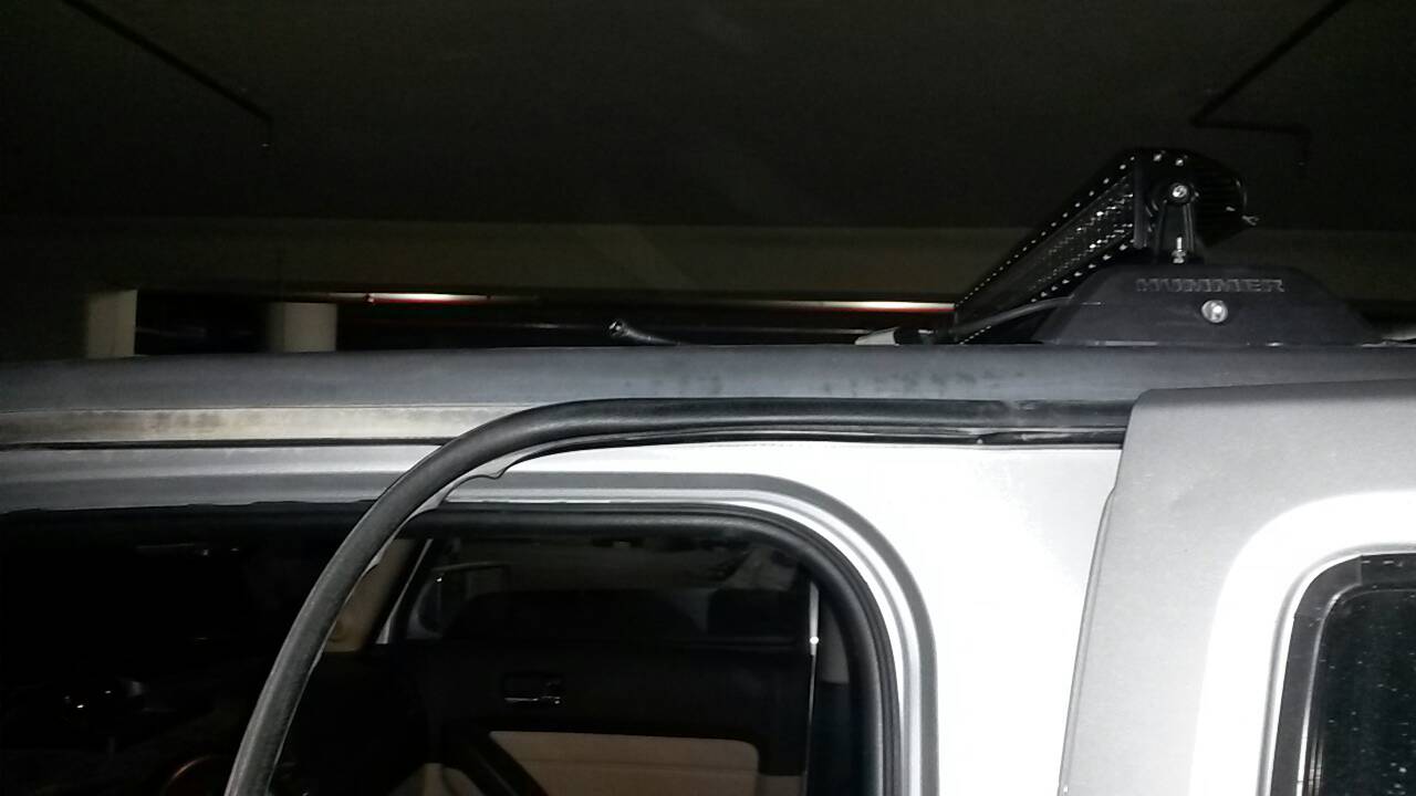

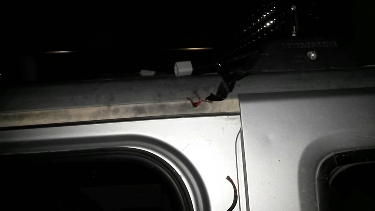

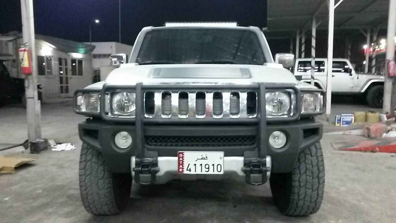

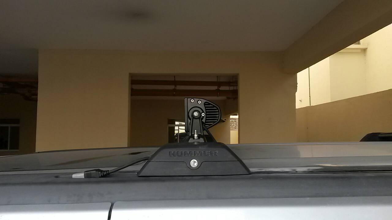

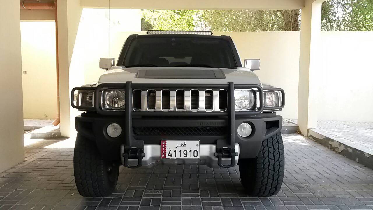

Just installed the 40" LED using the cross bars. This is how it turned to be...
uploadfromtaptalk1391023838284.jpguploadfromtaptalk1391023867014.jpguploadfromtaptalk1391023889391.jpg
I utilized the weatherstrip at the top of the doors to channel the wires from the engine bay back to the light bar. I drilled 2 holes for the wires to cross theough the moldings at the top of the doors.
Still have to wire the switch back inside the cabin, drill it somewhere and bolt the relay inside the engine bay.
Special thanks to forum member humvee for helping me out with the wiring. Hopefully I'll be done tomorrow.

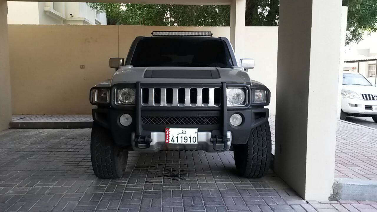

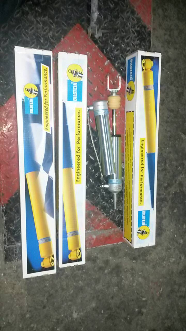

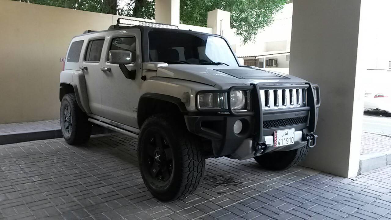

Small Update, got the Bilsteins and the Body lift installed. Truck handles great on road, offroad its on a new level (high speed stuff). Offcourse Im comparing front reservoirs to beat up stock shocks, but its a huge difference in ride quality.
Still need to re-drill the bush guard so its raised 1" to match with the raised body.

Looks great. I have been debating doing a body lift, did you trim the fan shroud or rotate it?
Its a v8 not an I5, so I trimmed it, not sure rotating it cld work and its not a big deal. The top part of the shroud I heated it and bent it abit to clear the intake pipe.
Imo, with slightly less backspaced wheels the truck looks perfect (you can also get spacers, anything up to 40 mm wld work on stock wheels w/fender flares no issues)

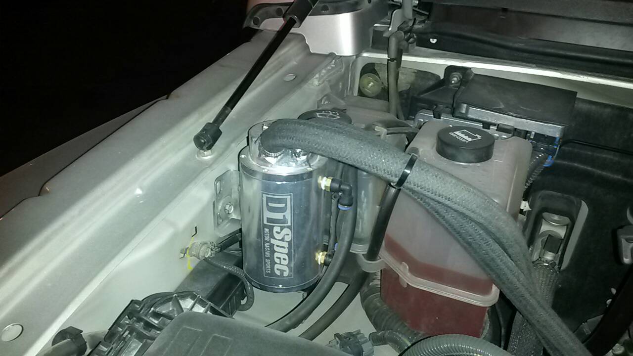

New Updates, Added an oil catch can to reduce the amount of oil going back through the intake (hopefully I'd keep a cleaner throttle body for a long time esp since Im using a K&N oil filter)

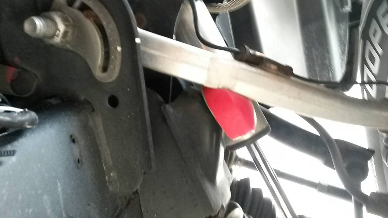

Modded the UCA metal stop to have a Control Arm bushing on it. It stops the loud metal clunk that happens at full drop and completely stopped the metal bind in the C.V.s that used to happen afterwards. Only problem is, they don't handle alot of abuse. Im running a 1" thick one and it lasted 3 wheeling trips (150 miles total) and one of them is starting to rip apart.

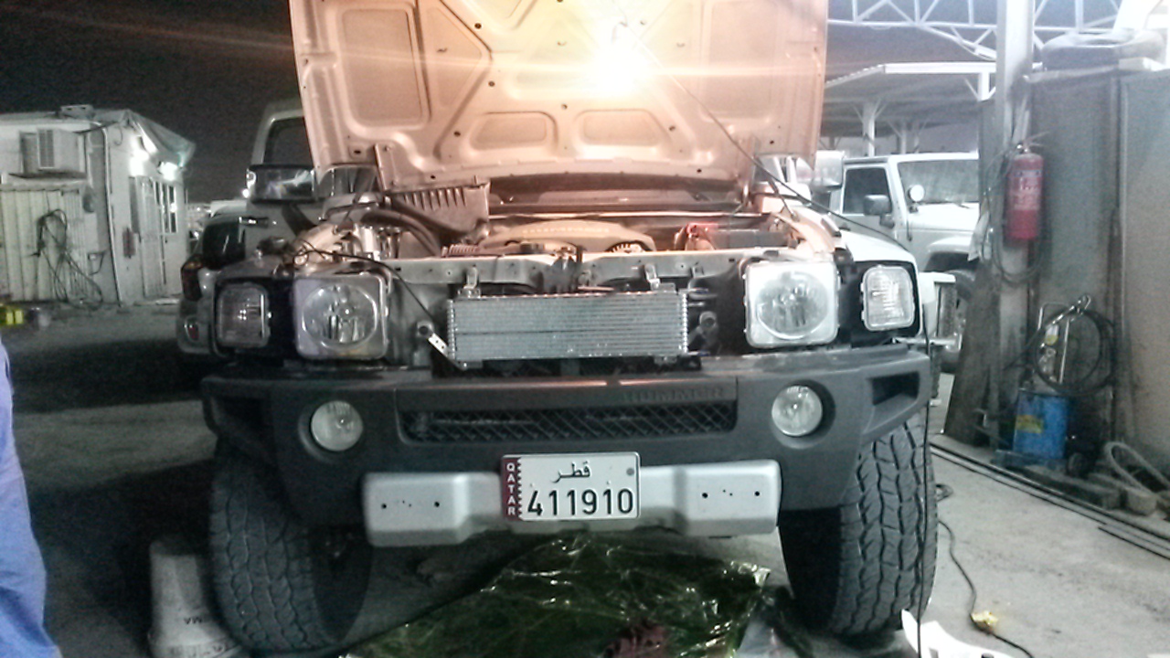

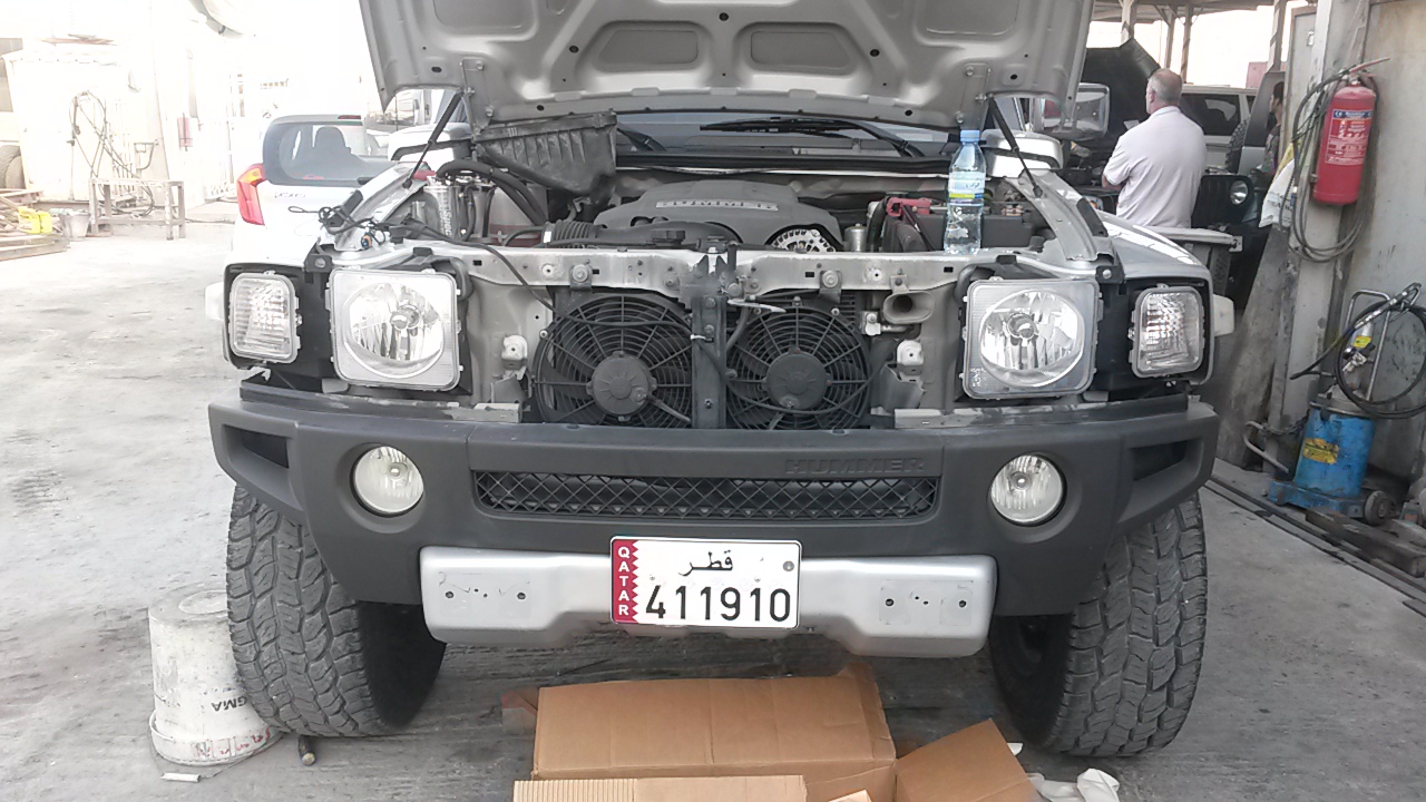

Added a trans cooler, trucool 30K GVW, 34K BTU, just in time as it hit 110+ f for a week now.
A picture of the dual fans (stock GM setup for this region)
Trans cooler in place (pretty big):
How the truck looks with the cooler behind the grille:

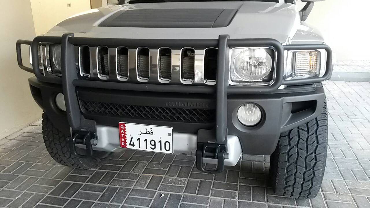

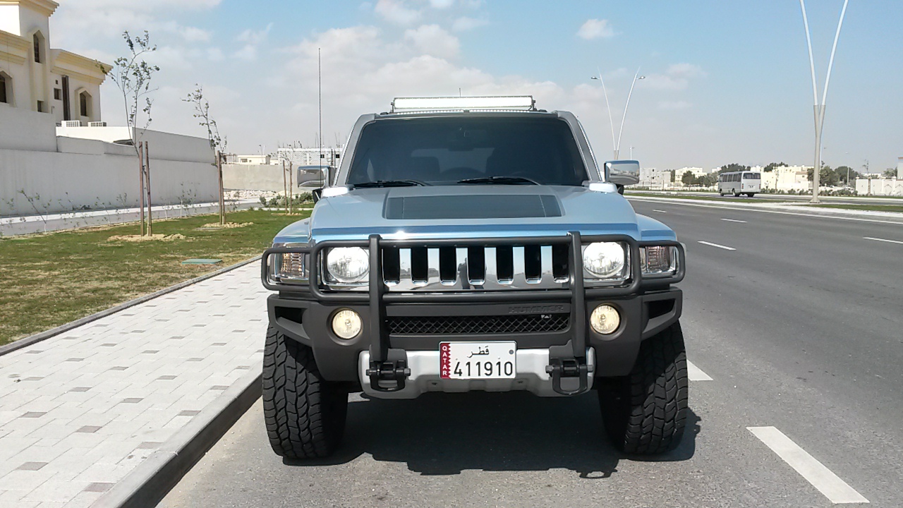

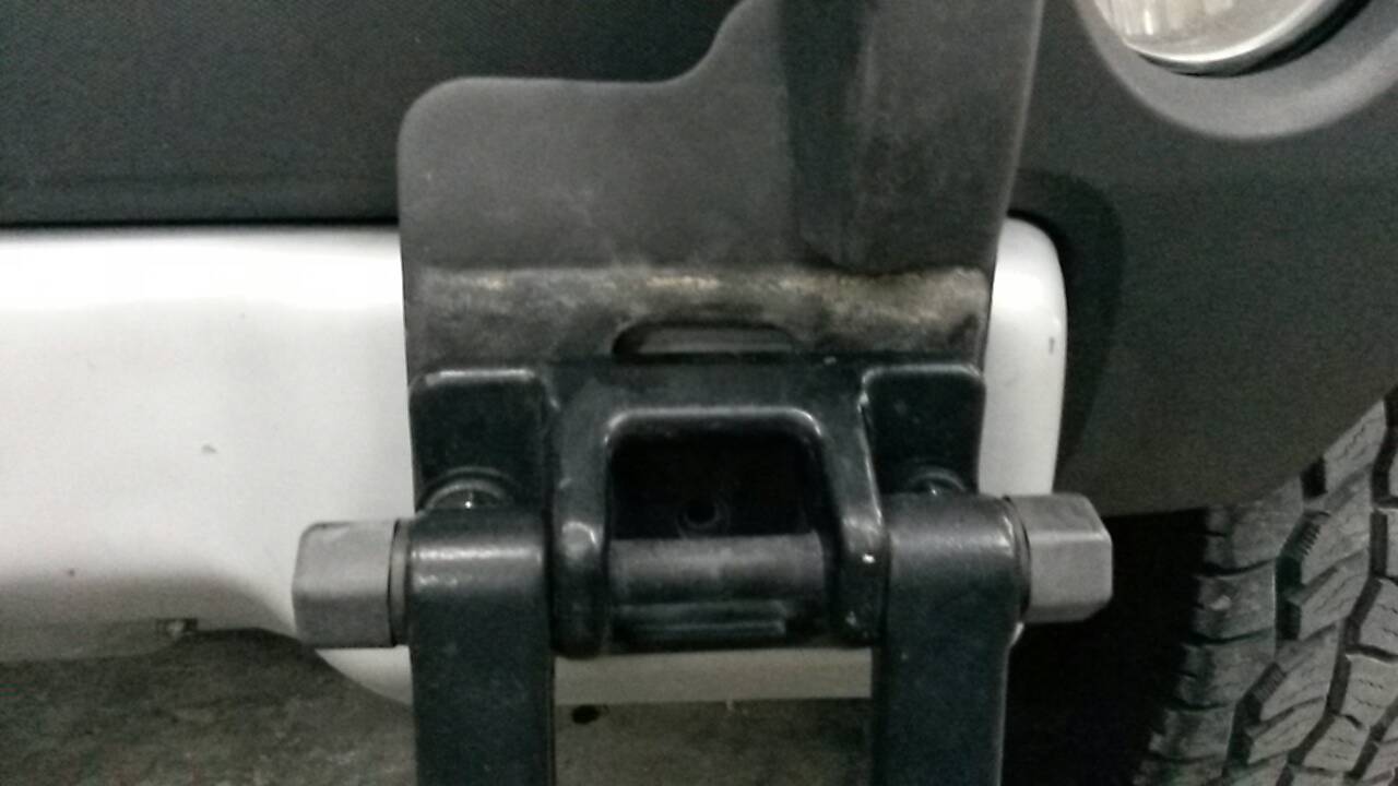

Raised the bush guard an Inch since I body lifted the truck!
The mount after I re-drilled it:
End product:

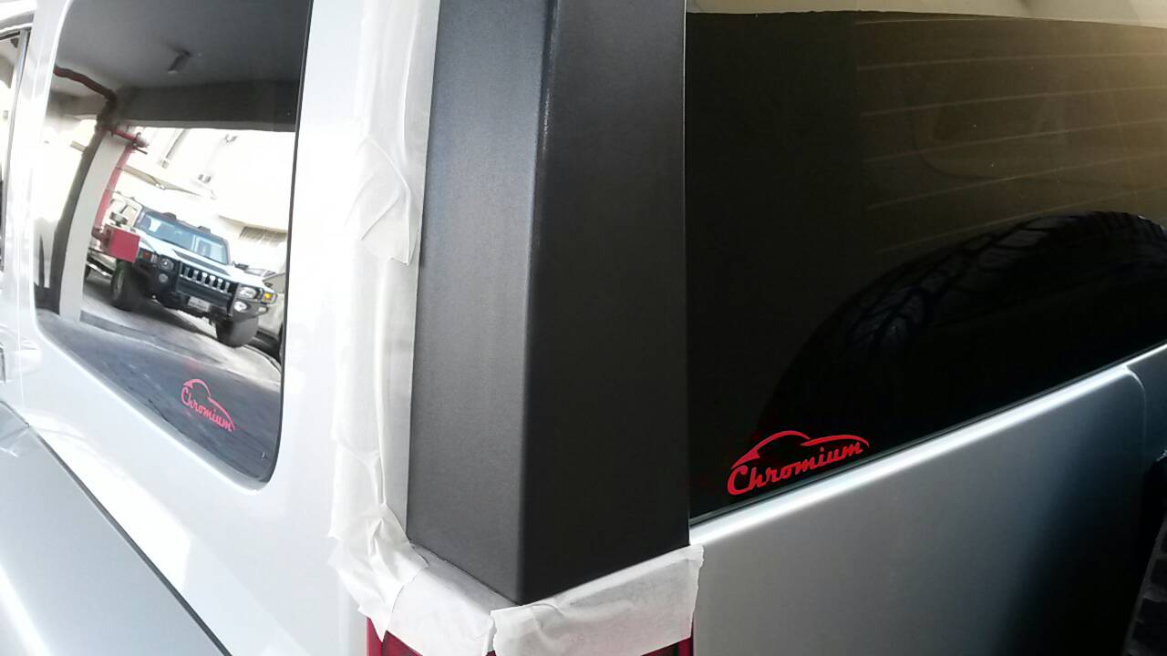

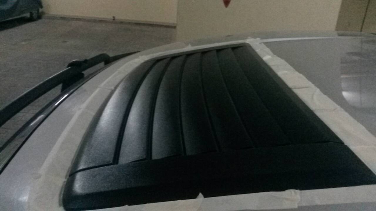

Applied wipe new on all exterior trim pieces ( pillars, rocker panels, bumpers, hood louver, mirror handles and roof trim).
My initial impression was that it restored the plastic to a shiny dark color, it looks new. The oroginal cracks in the plastic paint still visible, but not easily as all plastic is now dark. You can see what I mean in the first picture.
I had the plastic parts masked as to not have any of the liquid on the metal. Overall it took me 3 hours for the whole job (I was doing it in hot weather)
