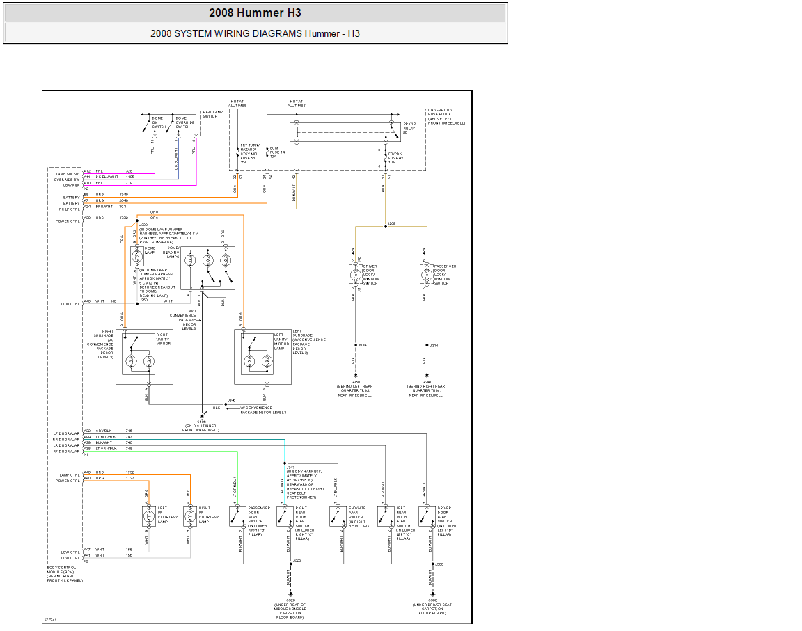

So I did some more digging on the wiring diagrams and have come to this conclusion. I think the BCM needs a slight reprogram to supply the righ voltage to the circuit. If you look in the diagrams below line 1732 (orange) supplies the "hot" power to the dome lights, outside power mirrors, foot well lights, and vanity mirror lights. This line, comes from the BCM. I think this is the logical next step. Thoughts?
I'd be very surprised if it's a programming issue with the BCM, programs don't just change on their own generally speaking, and I don't know why it would've been reprogrammed.
Have you checked to see if there is voltage coming from A29 and A20 pins on the BCM connector? If there isn't then I would suspect the BCM has been damaged due to a short somewhere (which would suck since that means it could happen again, there might still be a shorted wire somewhere).
If there is voltage then it's a cut wire. If there isn't then it might still just be a damaged wire (I'd imagine the BCM has some kind of short circuit protection inside it since there aren't any fuses after it to protect it and the wiring from shorts) and you'd want to pull the connector off the BCM and test between the pins and ground with an ohm meter to check for a short. I'd disconnect the power window switch and pull the bulbs out of the lights when testing. With that all unhooked it should be an open circuit (infinity ohms). Any kind of resistance reading otherwise will indicate a shorted wire.

No I haven't checked those pins yet. Hmm ok ill have to get a more sophisticated electrical tester to do that with the BCM. Did you mean A29 and A30? I think A20 is for the wiper mechanism, which does work as its supposed to.
The reason I suggested a programming issue is because one of the troubleshooting steps in the service manual is to make sure there is adequate voltage supply coming from the BCM, which I am assuming you either need a more advanced voltmeter than I have or a tech II of some kind.(I don't know what the actual voltage is supposed to be).
The strange part is that everything else works on the vehicle electronically speaking. So I am not completely sold on the BCM being completely bad...yet lol.
