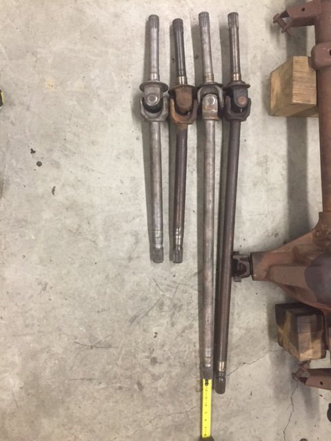

That's when a lightbulb came on. To my amazement...this thing was a full two inches short! 2-1/8" to be exact. So I compared the long-side shaft that came with the axle....to a stock GM long-side shaft and this revealed the gravity of the situation...
Crap. The long-side tube is too short for use in an H3. At first...I wrote it off. I either had to re-tube it with a longer tube, or sell it for use in a Scout, Bronco, CJ, or Sammy. But then I had a revelation. What if I could make the tube longer? So I thought about it, and went to work. First I trimmed off my beautiful previous fix of the saw cut....about two inches. That way I got good virgin tube to work with...

Pretty! So now my long-side tube is ready for a GM shaft. I grabbed one of my spares, changed the long-side shaft and checked the fit. Perfect. Then I grabbed a THORparts bracket kit and started welding it up. I'll be posting up pics of this axle as I go along. Its all easy from here on out. I wanted to share this craziness to show what can be done...and that nothing is beyond fixing, if you want it bad enough.

The axle shafts are stock GM units, and I stuck them in place and plugged them into the carrier just to check my work. BINGO! Restored to factory GM width.
