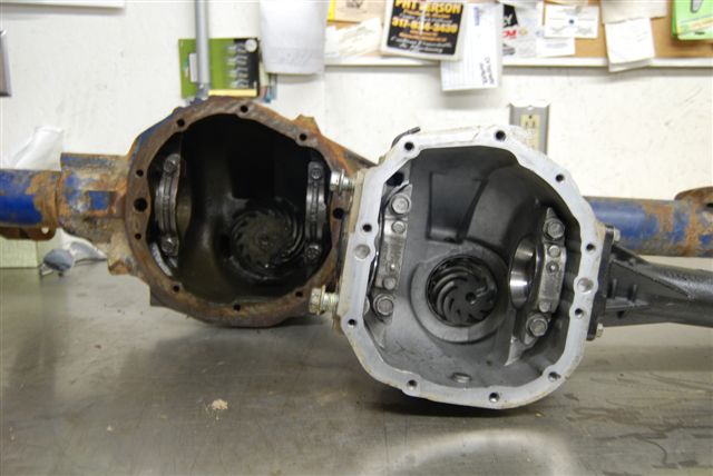

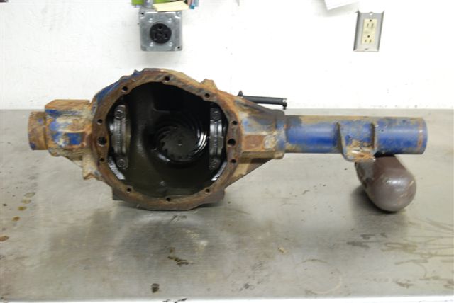

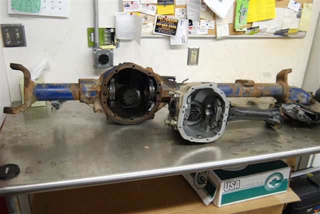

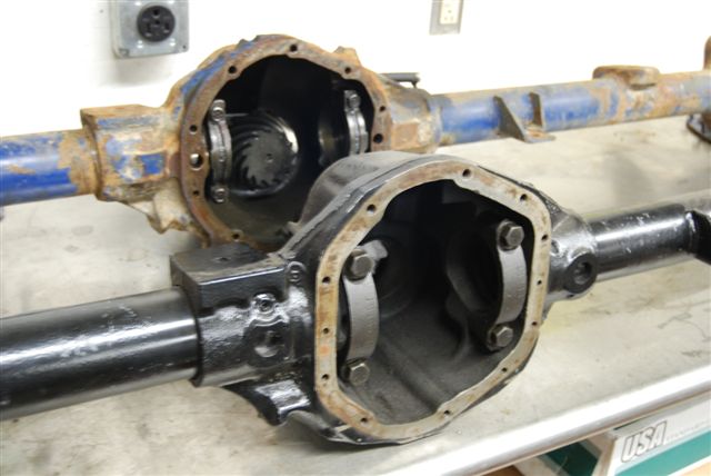

First, I took a couple pics of a Dana44 housing next to the 10bolt. As most already know...these axles are very common and they can be found in ANY GM truck from 73-91, in various forms. There's alot to mention about using these for SAS reasons but, since this is CHOP thread...I'll limit the ramble to that purpose. The two housings can easily be identified by the cover shape. If you remove the cover, you can see the 10-bolt has (2) locating holes drilled into the cover gasket surface. (more on this later)...and the Dana does not...

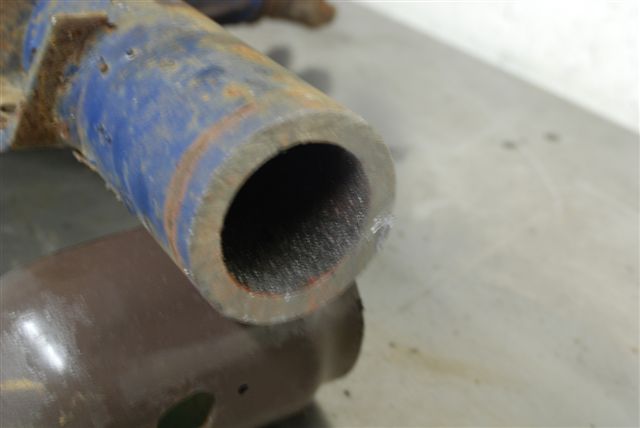

Having decided on the 10bolt...I moved-on to do some more investigating. The first pic shows the basic plan of attack...I want to cut the 10b housing down to match the size of the AAM-7. The second pic shows the drastic size difference of the cases...particularly the width between the journals. The AAM-7 looks almost "cartoon-ish" and clearly has no business under a 4x4 vehicle. The third pic shows the ring-gear size...7.6" vs. 8.5. The shaft you see sticking out of the 10-bolt carrier is actually a stub shaft from an AAM-7. This was the entire basis for choosing the early 28-spline version of the 10-bolt...

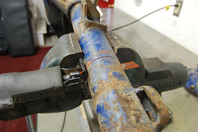

Moving on...I grabbed a saw-zall and made quick work of the chop. At this point I'm merely trying to cut it down to make it easier to handle. As you can see...plenty of tube there. After the chop...it started to look more like an IFS. BTW...I kept the inner-C's for an upcoming Hi-Pinion Solid axle project.

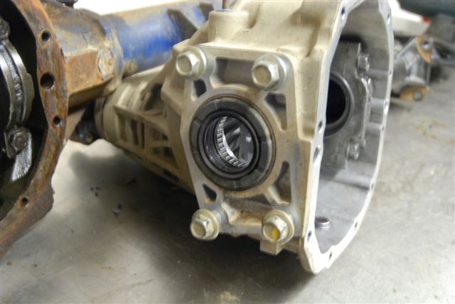

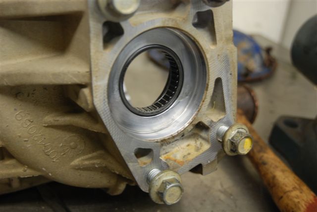

Going back to the AAM-7, I took a look at the seal and bearing arrangement. This is what I'm trying to duplicate on the 10-bolt housing. The idea being to make the 10b capable of receiving a stock H3 half-shaft...(theoretically possible because they share the same splines)...
Unfortunately, I don't think that is going to be possible, especially on the short side. The shafts for the 7" are designed for the spacing between the seal, support bearing, and side gear on that housing. Everything is simply wider on the 10b. Even if you machined down into the housing on the short side I'm not sure you will get it that close.

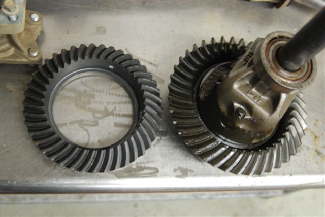

Also, since the basic carrier is wider, it is going to push each side out an amount equal to 1/2 the width difference between the two carriers. There may be enough travel in the half shafts to accommodate this, but you'd need to measure it to make sure. Even if this is the case, the above problem still remains.

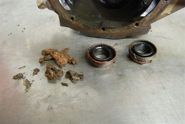

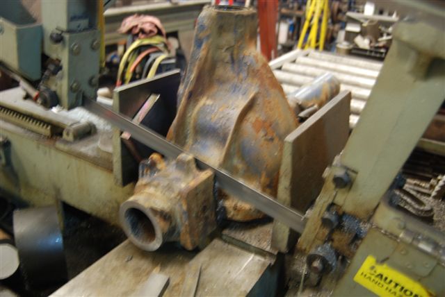

When doing an IFS chop, don't forget to remove the inner axle seals so the oil can flow out to the CV support bearings. In a solid-axle arrangement, the axle tubes run dry and its very common to find gobs of mud and crap stuck inside the axle tubes. I'm getting very good at assessing an axle's history by reading these clues. I'de say this axle has been wheeled in Georgia or Alabama (red clay)...

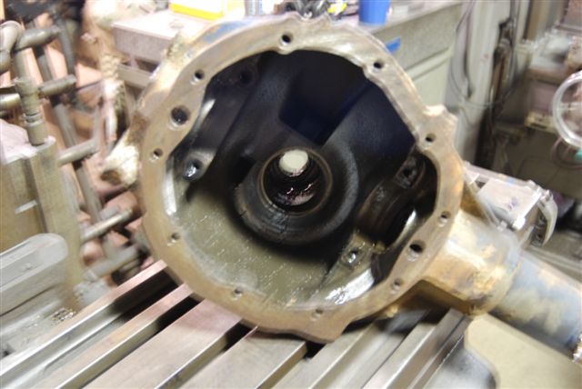

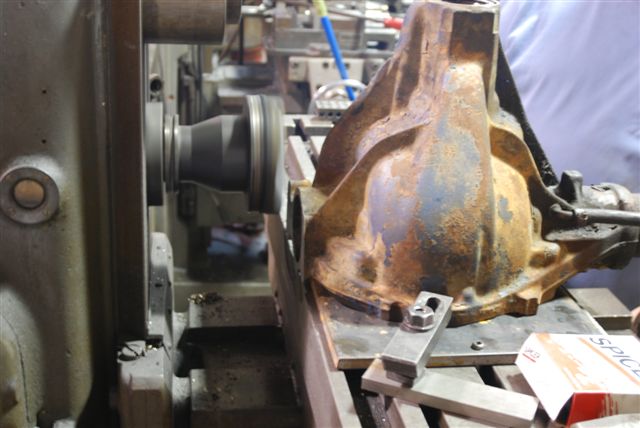

We used a band saw to chop the spring perch...works pretty good as long as you have a big one...

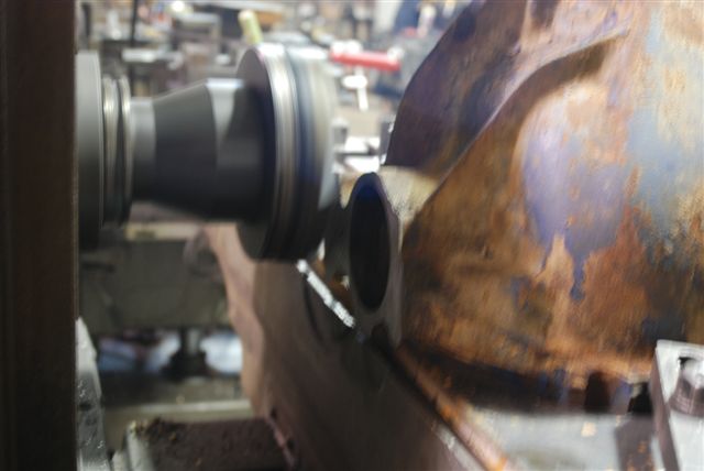

Next we fabbed a milling plate out of 1/2" steel. This plate has (2) dowels that fit the alignment holes in the face of the 10-bolt pumpkin. By using this plate, you can insure that the milling process is registered to the factory surfaces of the pumpkin. This means you get a square surface that is a true 90-degrees from the axle centerline. This is critical for bearing and seal alignment. We shaved right up to the edge of the front cover gasket, and you can see the milled surface in the third photo...
Now this is where I put the brakes on the project. After milling, I realized that I was a full 1.5" away from where I needed to be. The width of the 10-bolt carrier requires a 5.5" dimension from the carrier splines to the new CV seal. By comparison...the AAM-7 only needs 4.0". So, unless you can find a 28-spline CV joint with a longer input snout...you're done. (and even if you do...it will be different from the other side, and you'll have to carry two different trail spares...Digger-style). This goes against my original requirement of using 100% stock outer IFS parts...
To resolve this, I looked at adding a small coupler between the carrier and the CV support bearing...almost like a "socket extension". The male end would be captured inside the diff with a C-clip, and it would have a female end to accept the stock CV-shaft. However, a coupler requires a minimum of 3"...which would mean scooting the whole assembly further inboard. Faced with this extra complexity...and straying further and further from stock half-shafts...I took a day to think it over. If I have to make couplers to adapt to stock CV-shafts...I might as well make stub-shafts with flanges for bolt-in half-shafts. The price would be nearly the same, and it no longer makes sense to use a front 10-bolt (especially a 28-spline version). I feel the Dana44 or a rear H3 10-bolt would be more worthy of experimenting. This front 10-bolt casting was returned to the junk-pile, and many lessons were learned.
I still say it can be done. However, its enough work that you need to make sure the final product is worth your efforts. That means starting with a better diff to begin with, and committing ahead of time to use bolt-in shafts and custom flanged axles. Even if you get it figured out...you still have stock travel, rubber CV boots, a wimpy steering rack, non-greasable A-arms, and mounting issues. No matter how you skin the cat, it still ends up snow-balling into the Bebe rig (which is the right way to tackle the IFS problem). If somebody else wants to tackle the "cheap and easy" IFS upgrade, I'm all ears! Honestly I don't think there is such a thing, and that's why I'm switching gears to focus my efforts on solid axle swaps.
