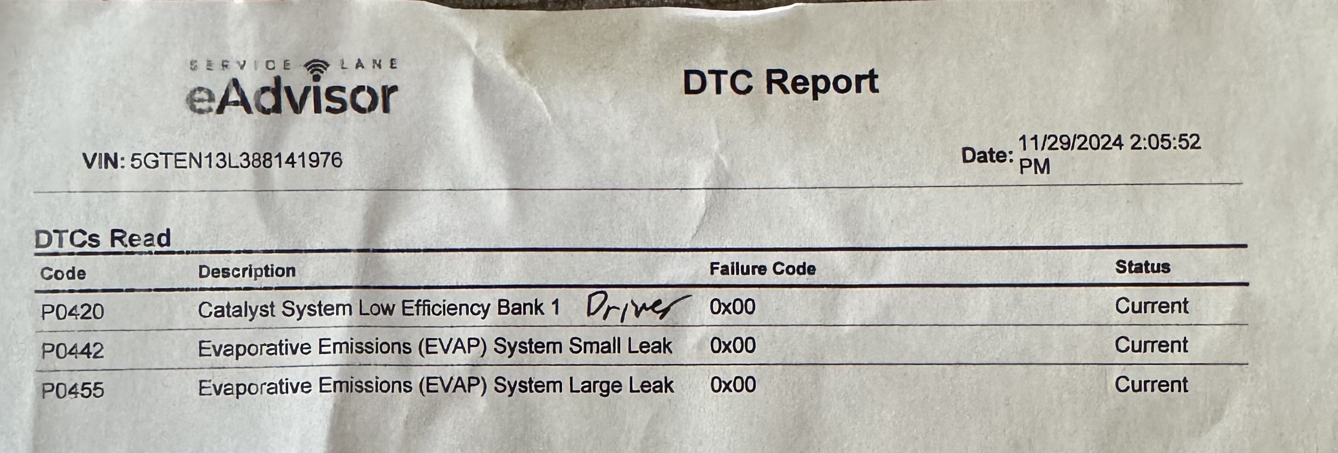

Here is the readout from the Service Manager at a local GMC dealership.

08H3
1,368
How hard do they look? I put a spark plug non-fouler on my O2 sensor on my old H3 and it took care of a P0420 for years.
2,830
You have a vacuum leak on the vapor canister system. Could also be the cause of the P0420, failing O2 sensor would also cause this code. Check all the vacuum hose for cracks or breaks, when you find the problem I bet the P0420 goes away. Unless you have a "good" friend that does smog, the spark plug non-fouler is a instant failure, that and if you have a bad cat or vacuum leak, they don't work.

I have an anti-fouler on my Alpha for about 5-6 years now, same code, same side (bank 1). Never had a problem smogging it since. Vapor cannister leak could be as simple as a bad gas cap.
