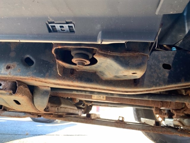

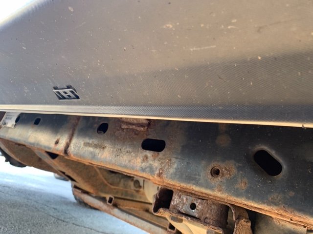

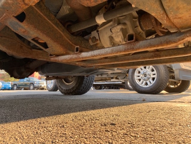

adding to this thread...I am considering moving to an Alpha and found a low mileage one in the North East. It would be an online buy, my first for a vehicle. the dealer sent some pictures of the undercarriage. Does the amount of rust look concerning to anyone? My 08 has lived in Florida all of its life and doesn't have anywhere close to this amount of oxidation. Any feedback is appreciated and anything else I should look out for?
Cheers and thanks!
Steve
View attachment 24493View attachment 24494
I recommend passing on it. In addition to what you see, there are things to consider that you can't see such as electrical connectors that are not inside the cab. If you can find a rig from an area such as south central Texas (away from the coast and far enough south to not have treated winter roads) it will be rust free. There are several on the Austin CRAIGSLIST and ALPHA's pop up sometimes at a fair price. Good luck whatever you do!

I think it depends how long you want to keep the vehicle for. If long term I would prolly remove the coating and por-15 because right now the coating is compromised and it’s rusting underneath it.
