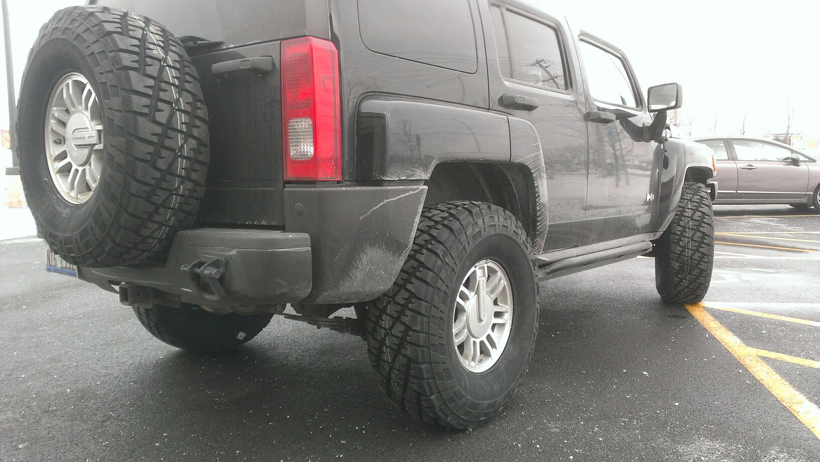

My brand new 315/75r16 General Grabber mounted and balanced a few days go.
Over all I'm very happy with my purchase of the General Grabber Tires and especially with the size. It transformed the look of the Hummer from the average soccer mom SUV over to an aggressive off-road Hummer. My H3 is still on a completely factory suspension and everything fits just fine under there. The wheels barely rub when I turn the steering wheel to full lock and consider the problem nonexistent. I happened to measured my Hummer before I got the wheels I measured 46.5 inches to the top of my fenders in the front and 48.5 in the back. After I got the new tires mounted and balanced it was 48.5 in the front and 50.5 in the rear. This surprised me that Hummer came up 2" inches over all, I was only expecting 1" to 1.5" since the 285/75r16 should be just short of true 33" inch tires. The road noise is far superior to other tires I have owned in the past definitely a huge benefit. I'm worried that the tires might wear fast because they are incredibly sticky, but I have no evidence to back this up. The lug depth is much deeper than I thought when looking at photo's and such that I have seen. I have noticed a power difference from the factory tires to the General Grabber, but it was expected and is not an issue for me since I don't expect an over size SUV to behave like a sports car.
