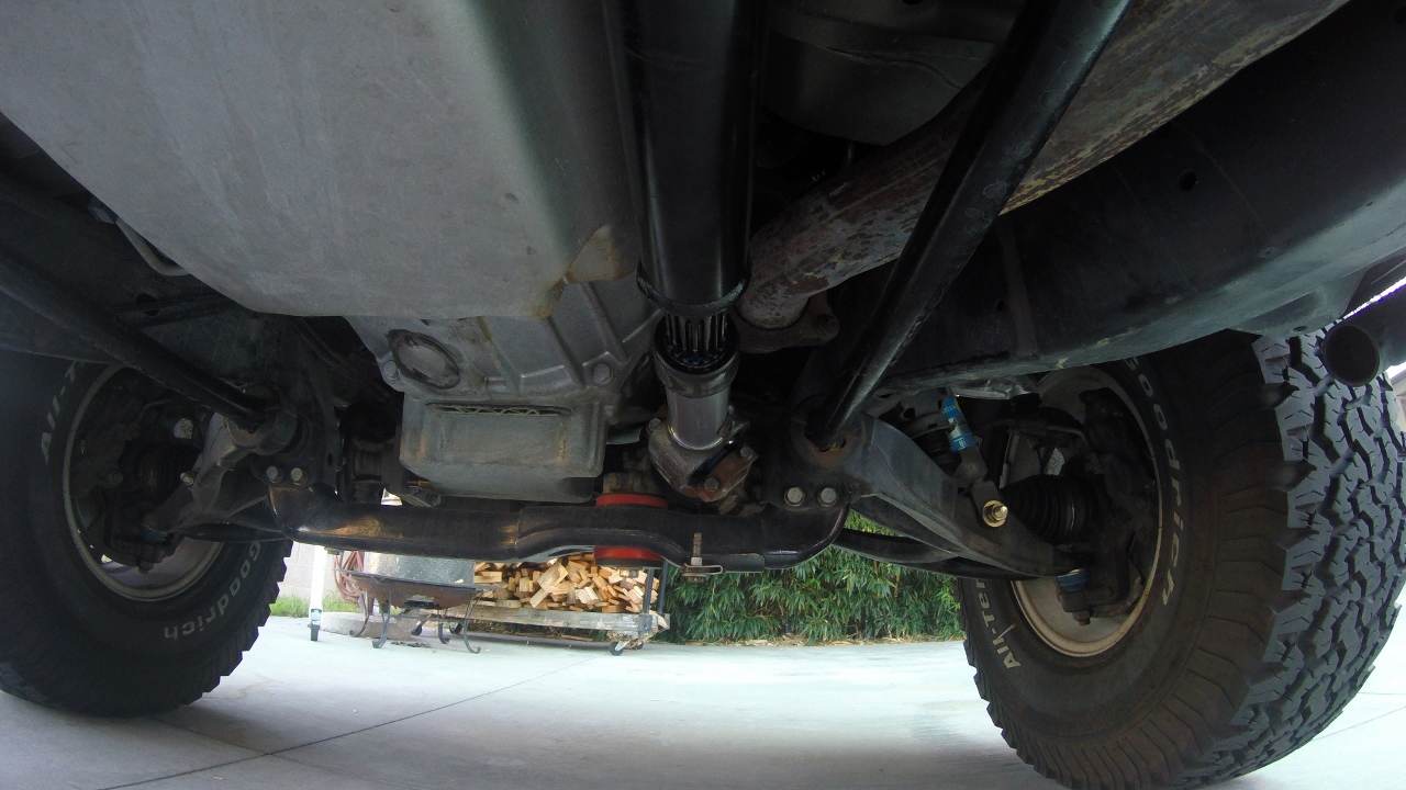

Installed my new adapter and shaft today. Quick installation and easy to do. The only mod I had to do was 2 of the bolts on the TC side I had to grind down a little because the flange face was digging into the side of the U joint. After I had the old shaft out I could clearly see the rubber boot on the CV and it had a lot of cracking and looked like it could go any time. I test drove it up to 60 mph and there was NO vibration felt, I did however HEAR the noise. I will take a video of it tomorrow and post it.

At all times. It is at all speeds as well which leads me to believe it is the double cardan. Because it is a new sound is why it is of concern. But I'm not overly concerned, if was transferred to the body I would be. Did my pictures show up or is the site still acting up?

Rascole....that sounds horrible! I'll be the first to admit that I don't watch, or listen to undercarriage video very often...so I don't have much of an opinion based solely on your video. But, its definitely "loud and grindy". It sounds like a bearing issue to me...probably pinion bearing or perhaps something going bad in the output shaft of the t-case. I'm assuming you can hear this inside the cabin, as well? My first thought is to check the pinion bearing on the front axle, as they are often times completely void of any pre-load at all. Grab the front diff yoke and give it a firm hand-shake...see if you can feel any looseness in it. Specifically, side-to-side looseness (not backlash looseness). This is best done with the front wheels off the ground, and the driveshaft disconnected.
I had a similar sound coming from my H3 and I would have bet my right arm it was a pinion bearing. However, it turned out to be a heat shield on the exhaust system. It rattled on decel and sounded amazingly similar to yours. It also seemed to get worse as the operating temperature rose. I had to drive around for 15 minutes before it became fully-audible. You might tap all the heat shields (there are several of them) with a hammer, and see if the sounds goes away, or changes. I think the solid cardan CV transmits more engine/driveline noise to the rest of the truck, and if a shield is loose...it will rattle, where it didn't before.
