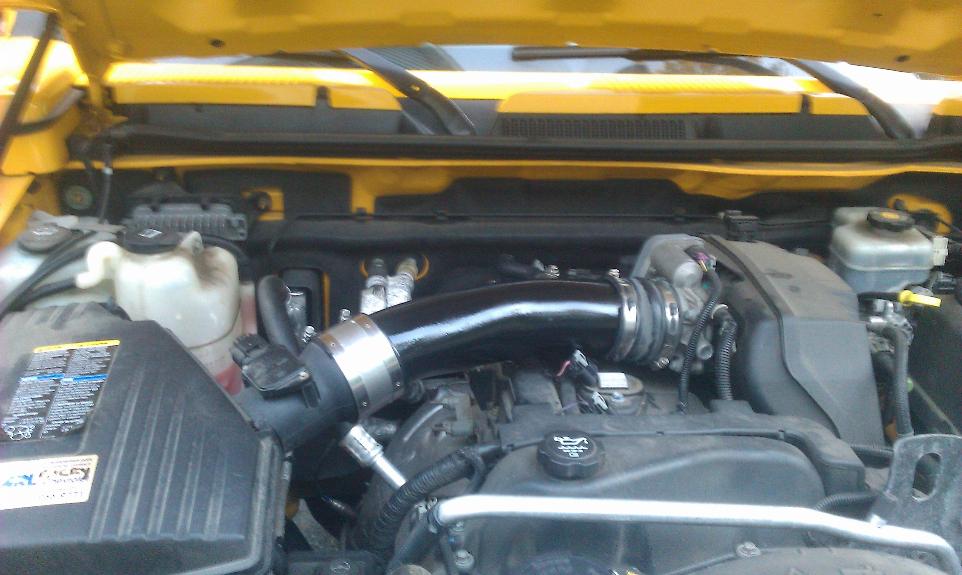

Then I was looking around for some performance mods and I went to home depot and built a straight tube air intake using PVC and an electricians pvc heating blanket. All said and done it cost me $20.

I'm really liking that "low budget" Intake tube. Would that work for an 08 I5? If you wouldn't mind shooting me a PM I'd love a parts list and instructions :) thanks. BTW I'm digging that color
