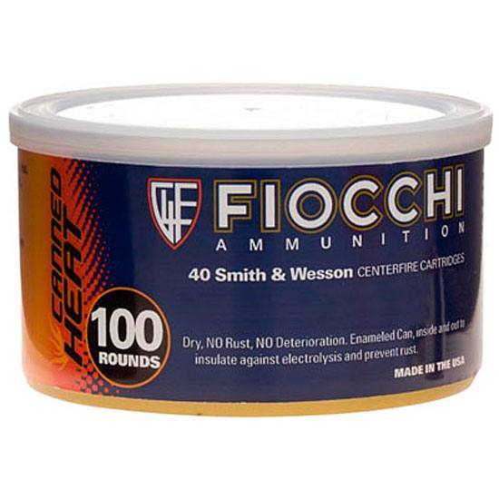

For handgun ammo, I really like the Fiocchi Canned Heat line:

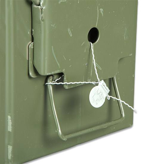

It may be a little pricey, but it's basically the same concept as food you buy in #10 cans. Theoretically as long as the can is not compromised the ammo should have an indefinite shelf life. For my AR, I like to buy the 840 round Lake City 5.56mm on stripper clips from CTD. These ammo cans come with the factory seal:
My thinking is that hermetically sealed ammo that has not been handled or exposed to air will be easy barter material.

By the way, if you do buy the Fiocchi Canned Heat, don't get it from Ammunition To Go. I've ordered twice from them and both times they packed the cans on sides instead of laying them flat in the box. I received the cans dented, but still intact. Go with Cheaper Than Dirt.
