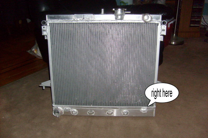

I installed this aluminum radiator exactly 13 months ago. 1 month after my warranty expired I popped
a leak. Its just my luck. My question is Can an aluminum radiator be repaired??? its leaking where the fins meet
the bottom tank. I went to a radiator repair shop and I was told go buy a metal apoxy and do it myself. it would cost
alot to fix. Any Opinions??? Thanks:emb: rad.jpg

I believe aluminum can be repaired with the proper equipment and know how. Conversely you could replace it again with another radiator.

Epoxy is a temporary fix. How much did he quote to fix it. Shouldn't be more than $100 max.
To tell you the truth the guy looked like he didn't want to be bothered, He just said it's gonna cost alot of money.

No I got it on eBay. I've been trying to email the seller to see if we can work out a deal
on another one. He has yet to answer me. I got it from a jersey based seller.

This is problem with aluminum radiators.
They fixed problem with plastic side tanks but core is still venerable. Most likely u had some old coolant left over from install and it ate it from inside.
Repair is expensive ~600 (they have to detach tanks and weld it shut then reattach tanks back) if u look at the core most likely there more dark/black spots that is your next leak.
Damp it and get regular one.

Well guys I went to 3 different radiator repair shops today and all I got were ridiculous prices for a small leak repair. I stopped at a local GM
dealer out of curiosity and I inquired about an AC/Delco radiator after the parts attendant told me $398.00 plus tax. I walked out. From my
experiences I have real bad luck with plastic tanks. I'm going to continue shopping around. And CSF has a new improved aluminum radiator. For a few bucks more
than AC/Delco
Thanks guys for all your advice.

My csf sprang a leak and from following other csf owners their did too. I will be shopping around this summer to see if I can get it fixed. Mine is leaking about 8 inches from bottom on left inside edge. Should be an easier fix than yours.
