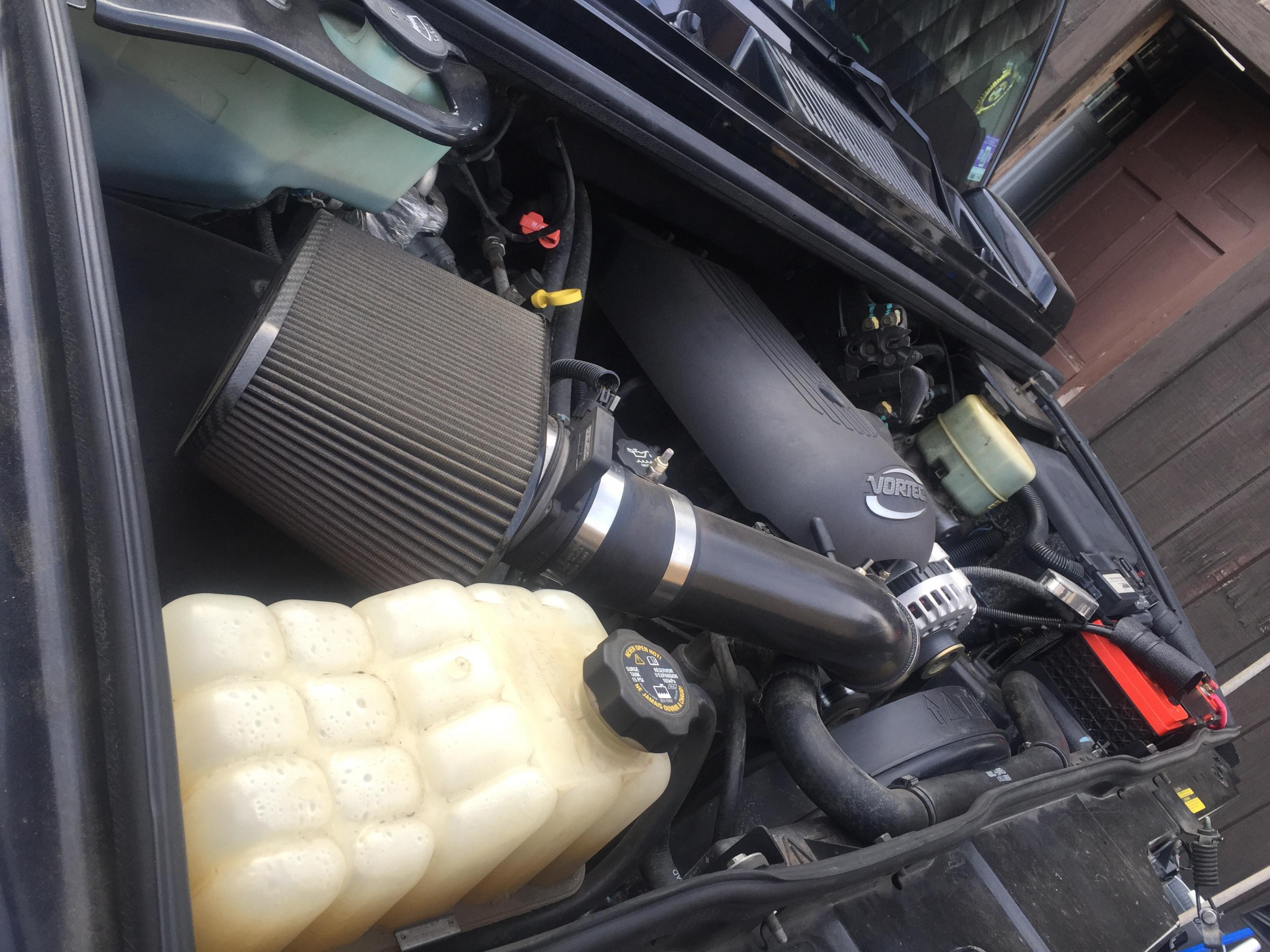

Hell since we're posting pics!!
Here is mine mated to a Volant box. I did have to take off 2" from the air box side and another inch from the engine side as the Volant box sits further into the engine compartment than the stock box.
