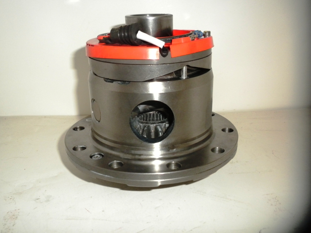

So I drained the front diff fluid and pulled the cover, only a few small metal shavings could be found in the oil and a couple of small chucks but nothing stood out as "thats what's wrong"... here are a few pic' s of what I could find
Some of the metal shavings:
Small chip in the leading edge:
Looks like some possible wear on the leading edge of the pinion:
Is this supposed to be two pieces or is this cracked?
Locker is definitely fubar and the pinion looks like it might be chipped.
I was googling the Eaton as much as I could and never saw one with the same split in it so I assumed it was not a part of the design
10,667
I don't have a picture of the front locker (I do have one of the rear), but in the rear it definitely does not have a split.
