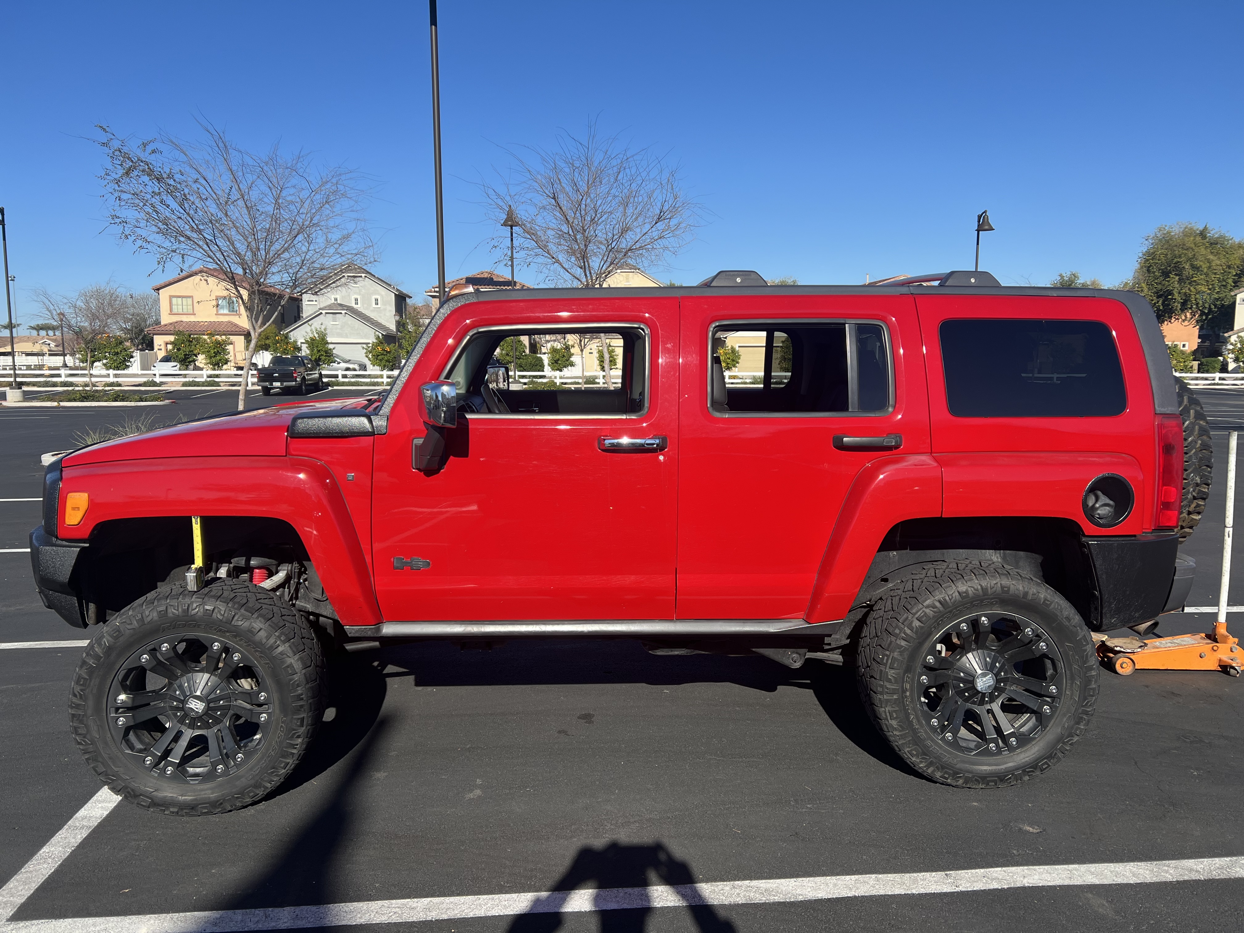

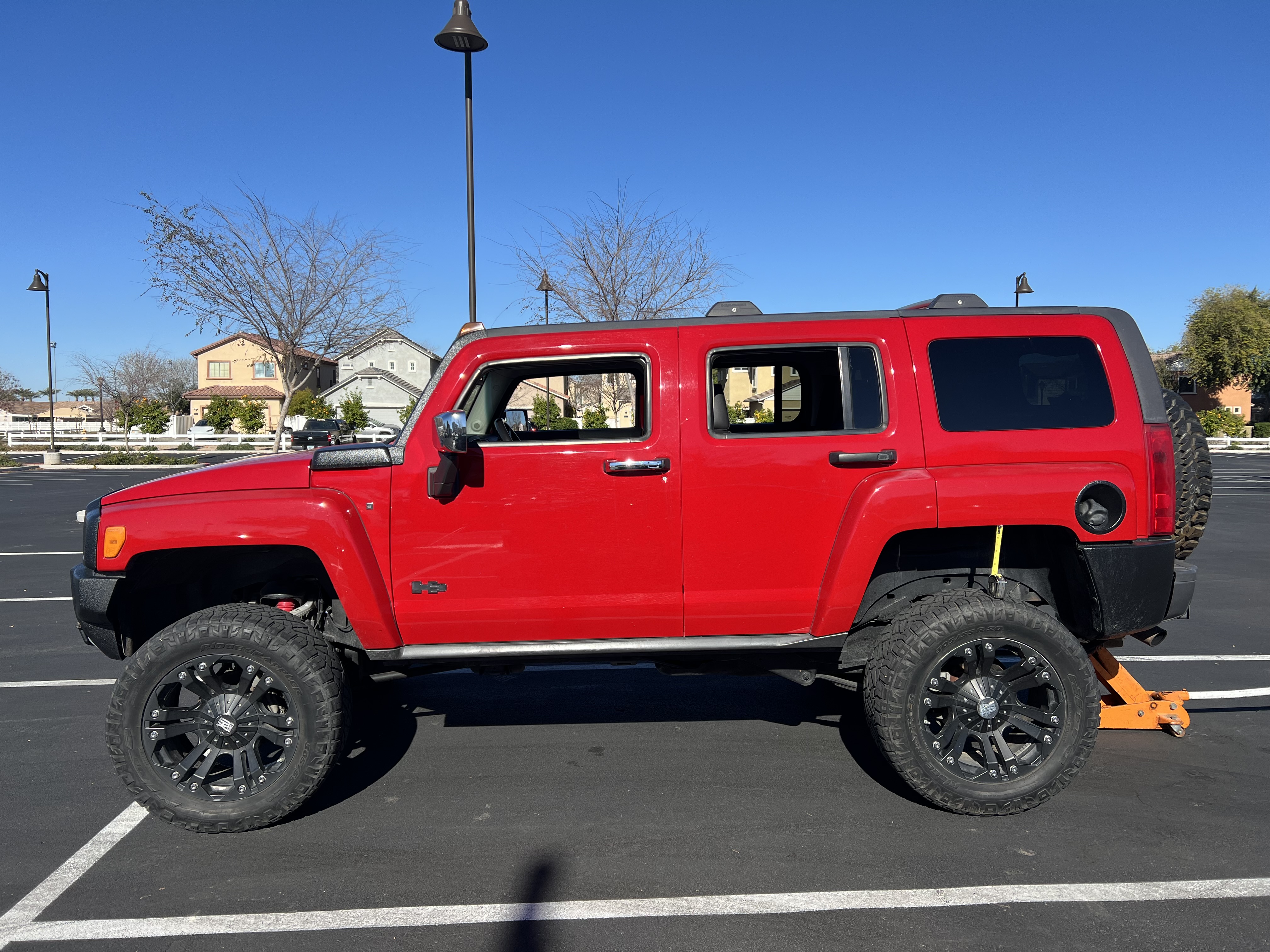

+3 in back. - 1/2 in front.
+ 4” in back. Same - 1/2” in front.
Current Stance:

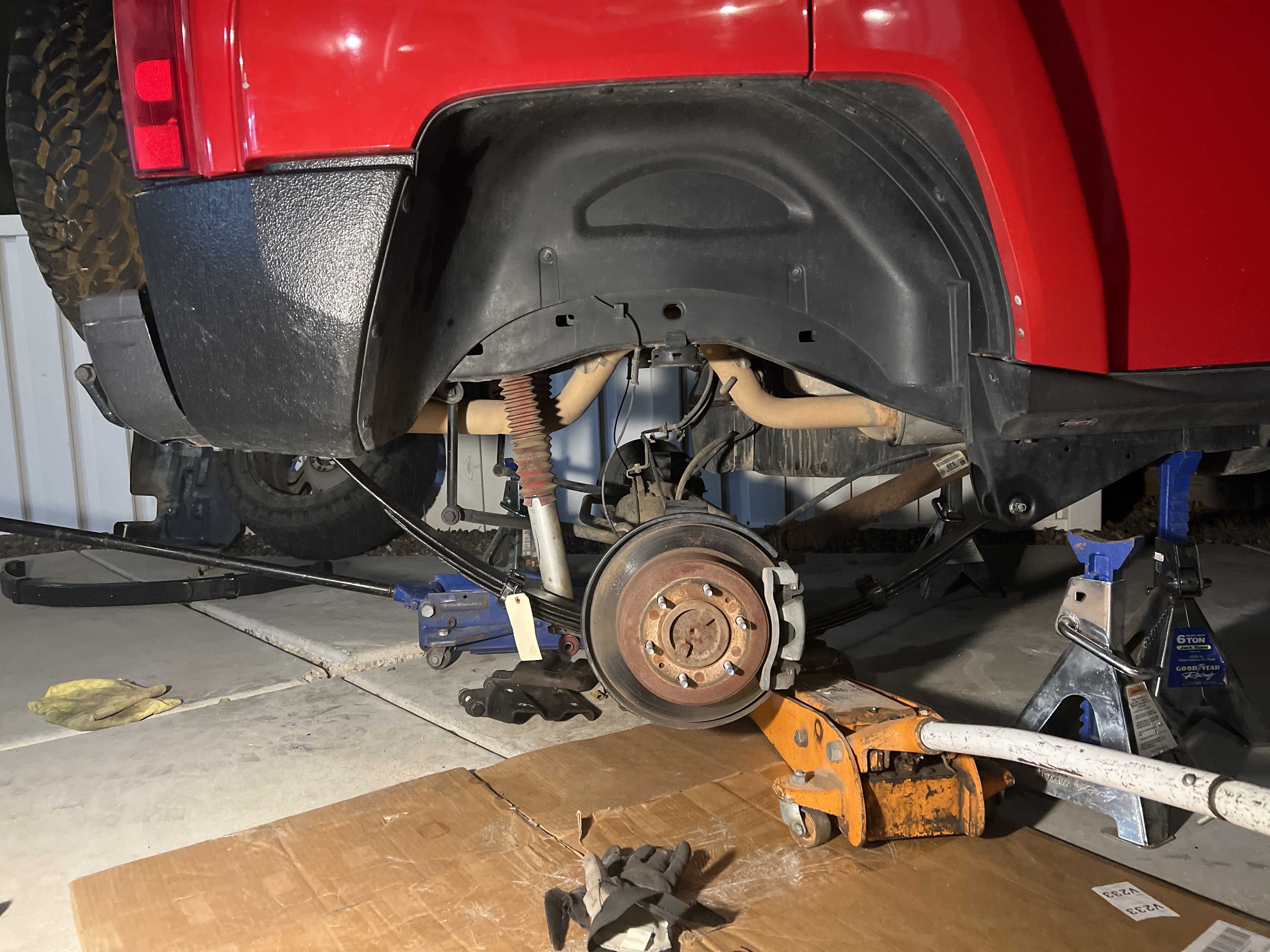

Pulling the rear leaf springs tomorrow. Dropping them off Monday for a re-spring. Let me know what you think!

too much and not good for CV's anyway !
Crank your T bars at front, max 23.5", from Wheel hub center to Fender bottom and put 1.25 or 2" longer shekels at the rear . Going over 23.5 " at front can serious affect those CV's
10,669
He's got a Rancho lift kit so the CVs are still level; he's in good shape. You are right on target if he'd done this just with the torsion bars.
Rake doesn't bother me. I had a rake on my Rancho lifted H3. But it's a bit exaggerated with the smaller tire size and here the level definitely looks better.

I say, NO LIFT In the rear whatsoever!
Not needed and who wants a rake anyways?!?!?
Yeah, the ranch leaf springs are totally shot, sags a ton in the back. So much that if I fill the gas tank to full it smells horribly of gas, coughs, sputters and stalls until I burn some off. I think it’s sitting so low in the back that at full it runs back into the fill pipe and jacks with the evap and vents.
It also bangs in the rear very harshly on pretty mild bumps in the road.

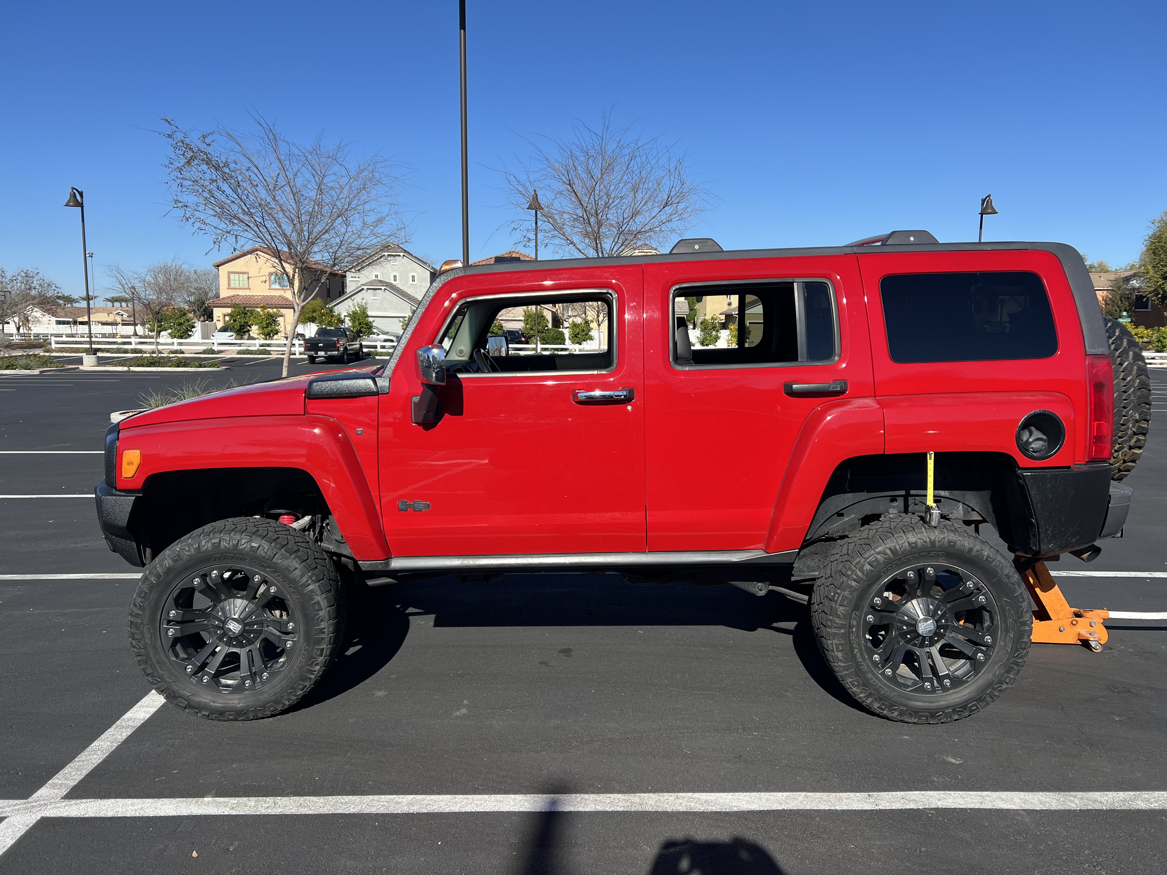

Yeah, I’d prefer a level ride height across the board too. I searched a bunch of old threads and pics of Rancho lifted H3s. Seems they had a bit of rake. My spring guy and I decided to shoot for +2-3” up from the current ride height. At 3” a bit of rake but I expect that to settle out after a few months. Rides super soft up front so I may crank the front a bit to off set the rear rake.

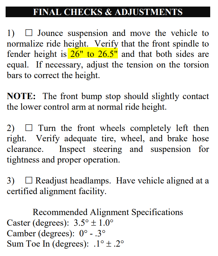

The front should sit at about 26.0-26.5" hub center to fender on the Rancho kit so rear should be at that too or slightly higher.
lfootmatt
164
AZ
Looking at my pics I’m hitting right at 26” in the front and 23-23.5 in back. When I jacked up the rear for the pics the front dipped down about 1/2”.
Hopefully it comes out nice and not jacked too high in the back. Like I said, maybe just a touch of a crank in the front if it needs leveled a bit.
Thanks for the ride height data!

Now you tell me!😢 spring over with the shot Rancho leaf springs or factory leaf springs?

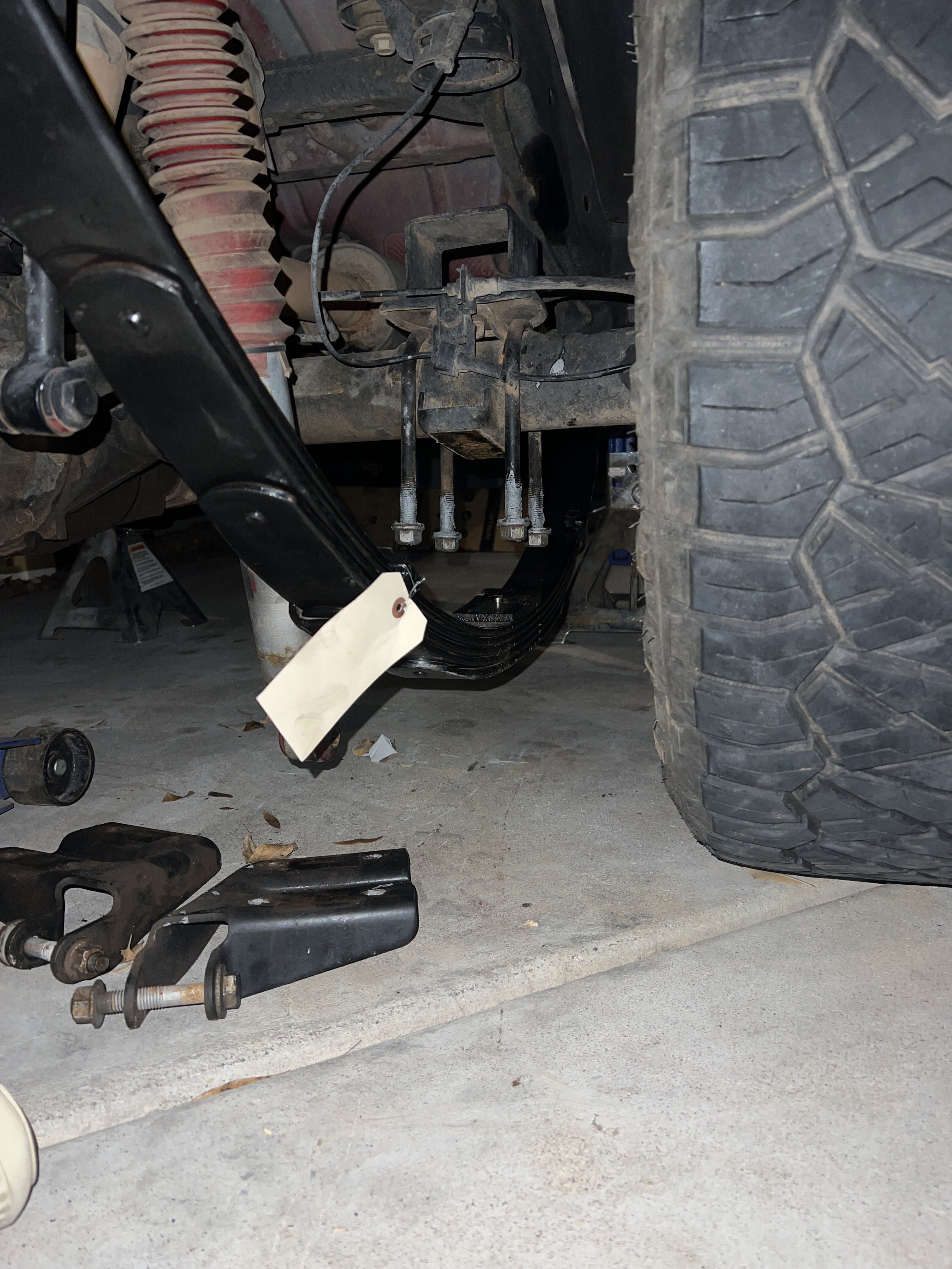

The shop added so much arch the fell ~3” short of the rear shackle. Using a 2X4 scrap as a runner I was able to compress and slide the rear end tip eye/bushing into the shackle and get the bolt in. Now leaf spring center pin that indexes into the axle tube mount is a solid 2” too far forward. Compressing the spring upward with a floor jack made little difference.
Am I missing something or did they just add wayyyy too much arch back in to the springs?
Thanks in advance!!!
Matt
PS I have an email into Rancho requesting their leaf spring specs.

Here’s a pic with the tires back on the rear end and the leaf spring hanging down, just a bit too far🤬🤬🤬

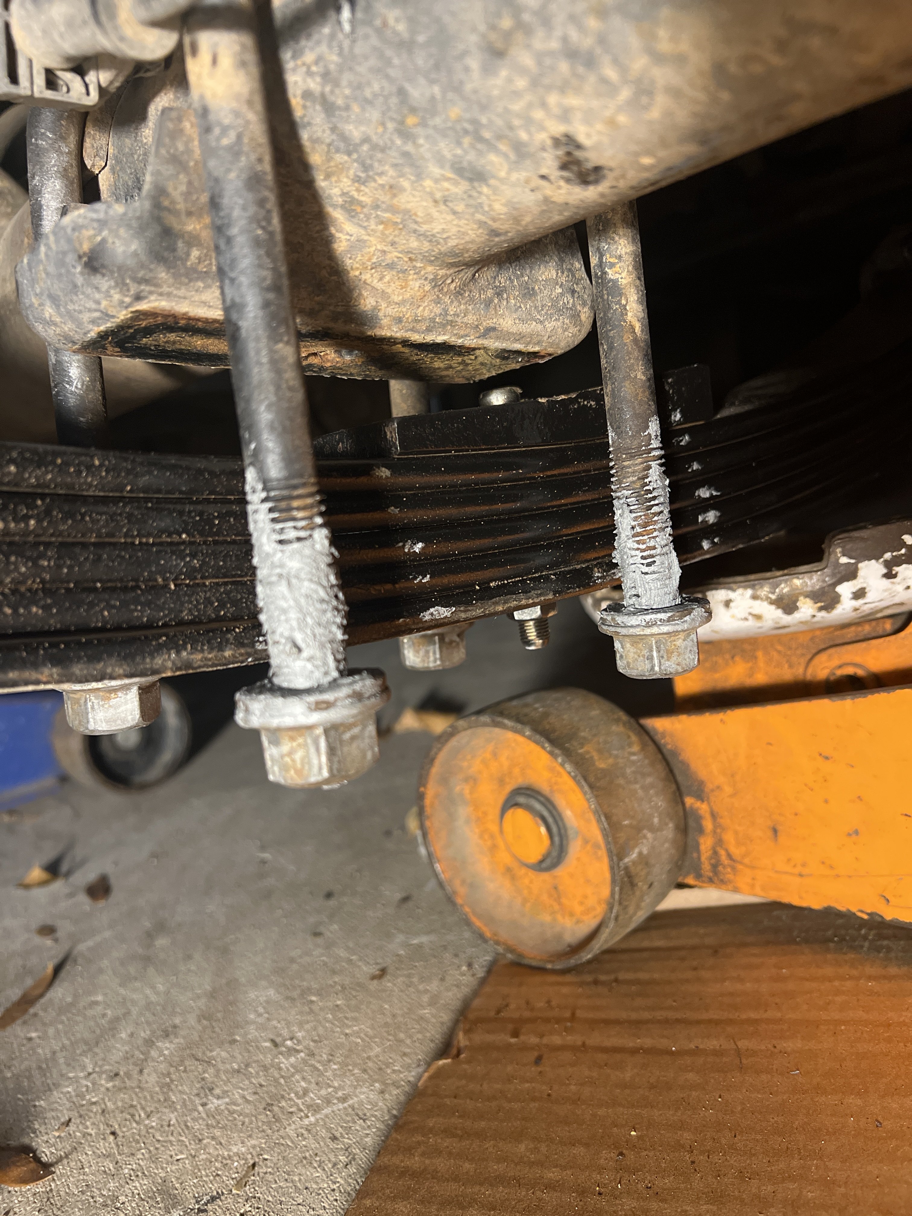

Are you sure that your axle hasn't shifted?
I suppose the axle shifting is a possibility. However, when I dropped the leaf springs out, the axle didn’t really seem to move at all. I did not disconnect the swaybar links. So that’s generally holding it in position. I’m not sure if that makes any difference or not.
I suppose I’ll go ahead and persuade it into deposition and mount it up and see what happens. My guess is I’m gonna gain 6 to 8 inches of lift in the rear. It’s gonna look stupid as hell.
Hopefully Rancho gets back to me with the engineering data on the leafspring specifications. They were phenomenally responsive with all of the busing data. I previously asked for. If I get that that I can just measure the springs and determine if they’re right, or need to be re-arched again.

you have both sides disconnected (ubolts loose and leafs not attached to the diff)?
Tires off the ground?
That way you can shift the diff to the right spot for the dowels to line up.
lfootmatt
164
AZ
Yep, both lead springs are out. The only thing holding the diff in is the rear sway-bar links. Perhaps I should have bolted them up to the diff first then persuaded the bushings into place. That might be the play.
